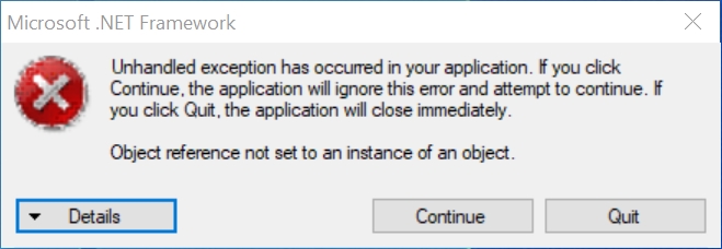

    Hello, I have a problem since I tried to install the Star Wars Squadrons plugin. Now I get this error in both programs and the games I have in presets do not appear.
    The error is a Microsoft .NET Framework window
    System.NullReferenceException: Object reference not set to an instance of an object.
    at SimTools_GameManager.frm_GameManager.cb_GameSelection_Click(Object sender, EventArgs e)
    at System.Windows.Forms.Control.OnClick(EventArgs e)
    at System.Windows.Forms.ComboBox.WndProc(Message& m)
    at System.Windows.Forms.Control.ControlNativeWindow.OnMessage(Message& m)
    at System.Windows.Forms.Control.ControlNativeWindow.WndProc(Message& m)
    mscorlib
    Assembly Version: 4.0.0.0
    Win32 Version: 4.8.9290.0 built by: NET481REL1LAST_C
    Assembly Version: 0.2.6.0
    Win32 Version: 0.2.6.0
    CodeBase: file:///C:/Program%20Files%20(x86)/SimTools/SimTools_GameManager.exe
    UneaZPaLWHjtjGfIyYsbFPWNzDcv
    Assembly Version: 0.0.0.0
    Microsoft.VisualBasic
    Assembly Version: 10.0.0.0
    Win32 Version: 14.8.9037.0 built by: NET481REL1
    CodeBase: file:///C:/Windows/Microsoft.Net/assembly/GAC_MSIL/Microsoft.VisualBasic/v4.0_10.0.0.0__b03f5f7f11d50a3a/Microsoft.VisualBasic.dll
    System
    Win32 Version: 4.8.9282.0 built by: NET481REL1LAST_C
    CodeBase: file:///C:/Windows/Microsoft.Net/assembly/GAC_MSIL/System/v4.0_4.0.0.0__b77a5c561934e089/System.dll
    System.Core
    Win32 Version: 4.8.9277.0 built by: NET481REL1LAST_B
    CodeBase: file:///C:/Windows/Microsoft.Net/assembly/GAC_MSIL/System.Core/v4.0_4.0.0.0__b77a5c561934e089/System.Core.dll
    Win32 Version: 4.8.9251.0 built by: NET481REL1LAST_C
    CodeBase: file:///C:/Windows/Microsoft.Net/assembly/GAC_MSIL/System.Windows.Forms/v4.0_4.0.0.0__b77a5c561934e089/System.Windows.Forms.dll
    System.Drawing
    Win32 Version: 4.8.9037.0 built by: NET481REL1
    CodeBase: file:///C:/Windows/Microsoft.Net/assembly/GAC_MSIL/System.Drawing/v4.0_4.0.0.0__b03f5f7f11d50a3a/System.Drawing.dll
    System.Configuration
    CodeBase: file:///C:/Windows/Microsoft.Net/assembly/GAC_MSIL/System.Configuration/v4.0_4.0.0.0__b03f5f7f11d50a3a/System.Configuration.dll
    System.Xml
    CodeBase: file:///C:/Windows/Microsoft.Net/assembly/GAC_MSIL/System.Xml/v4.0_4.0.0.0__b77a5c561934e089/System.Xml.dll
    System.Runtime.Remoting
    Win32 Version: 4.8.9214.0 built by: NET481REL1LAST_B
    CodeBase: file:///C:/Windows/Microsoft.Net/assembly/GAC_MSIL/System.Runtime.Remoting/v4.0_4.0.0.0__b77a5c561934e089/System.Runtime.Remoting.dll
    Game_PluginAPI
    Assembly Version: 1.0.0.0
    Win32 Version: 1.0.0.0
    CodeBase: file:///C:/Program%20Files%20(x86)/SimTools/Game_PluginAPI.DLL
    System.Management
    CodeBase: file:///C:/Windows/Microsoft.Net/assembly/GAC_MSIL/System.Management/v4.0_4.0.0.0__b03f5f7f11d50a3a/System.Management.dll
    Squadrons_GamePlugin
    Assembly Version: 3.0.0.0
    Win32 Version: 3.0.0.0
    CodeBase: file:///C:/Users/Salva/AppData/Local/SimTools/GamePlugins/520_GamePlugin.dll
    enabled.

    What version of SimTools are you using and what version of the plugin?

    Thanks, I'll try this. And how do the V3 plugins differ?
    Would you recommend upgrading from V2 to V3 simtools? I can't find a clear step-by-step tutorial for V3, I don't understand how it works...
    21,487
    150,542Coins
    +11,017 / 55 / -2
    The v3 FAQ section is likely a good place to start: https://www.xsimulator.net/community/faq/simtools-v3.401/
    You can have v2 and v3 installed on the same computer, using the same license, to ease the transition.
