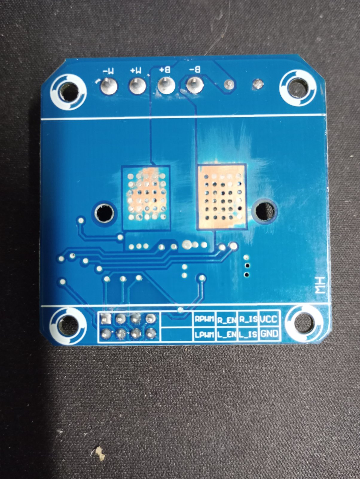

    IBT2s are known to burn out at 24V, working configurations that I know of are:
    1. 250W motor with a supply of around 18V.
    2. two ibt2's wired in parallel.
    3. removal of the heatsink and application of thermal paste to the IBT2 + extreme version, sanding down the paint from the areas under the heatsink to better dissipate the heat + thermal paste.
    I have burned about 6 ibt2s myself.
    I tried 1 and 3 but finally I bought this controller
    https://www.xsimulator.net/community/threads/reasonably-priced-100a-motor-controllers.17638/
    So far it works fine with 24V 13.4 A 250W motors.
    I do not know how it will behave with more powerful motors, theoretically it supports up to 100A but it is however made in china :)

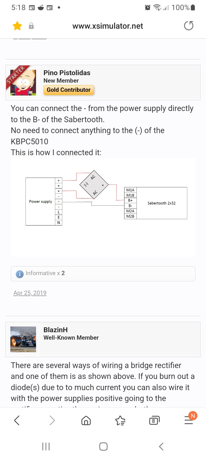

    Mount the KBPC5010 diode on the power supply to protect the power supply from regenerative current.
    Do you have one 50A power supply for three motors ?

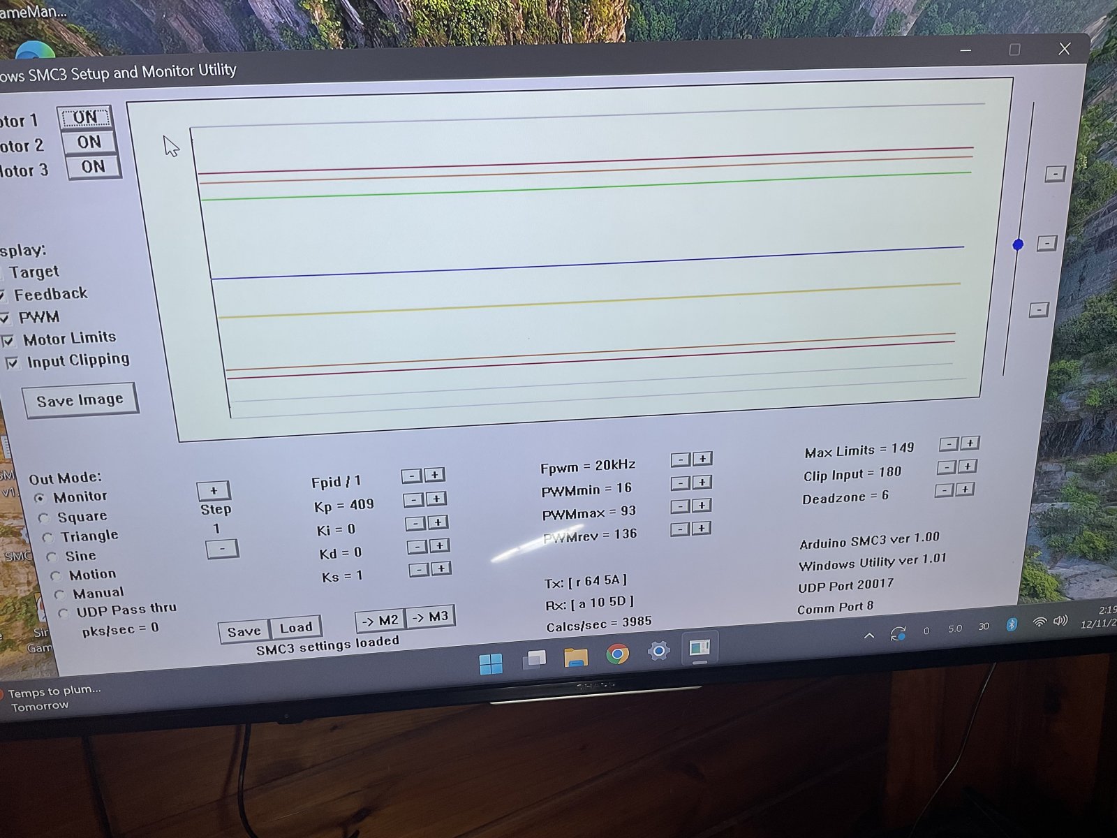

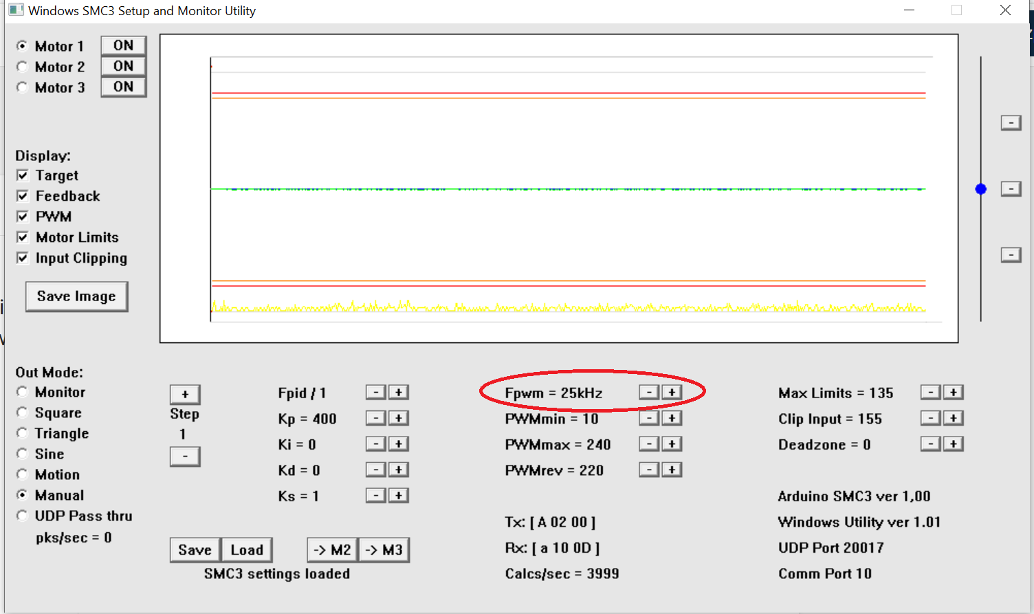

    When I test the the first motor it runs in sine ,in manual in square with load and no load no problems.when I give power to the second motor like I said before I’m not even get a chance to test it because it burns the IBT’s.
    The pic of the utility is for motor 1

    Looking at the pictures:
    - why isn't the green line in the middle and overlapping the purple and blue lines?
    below the correct calibration , the other settings are only correct for me, do not suggest them :)

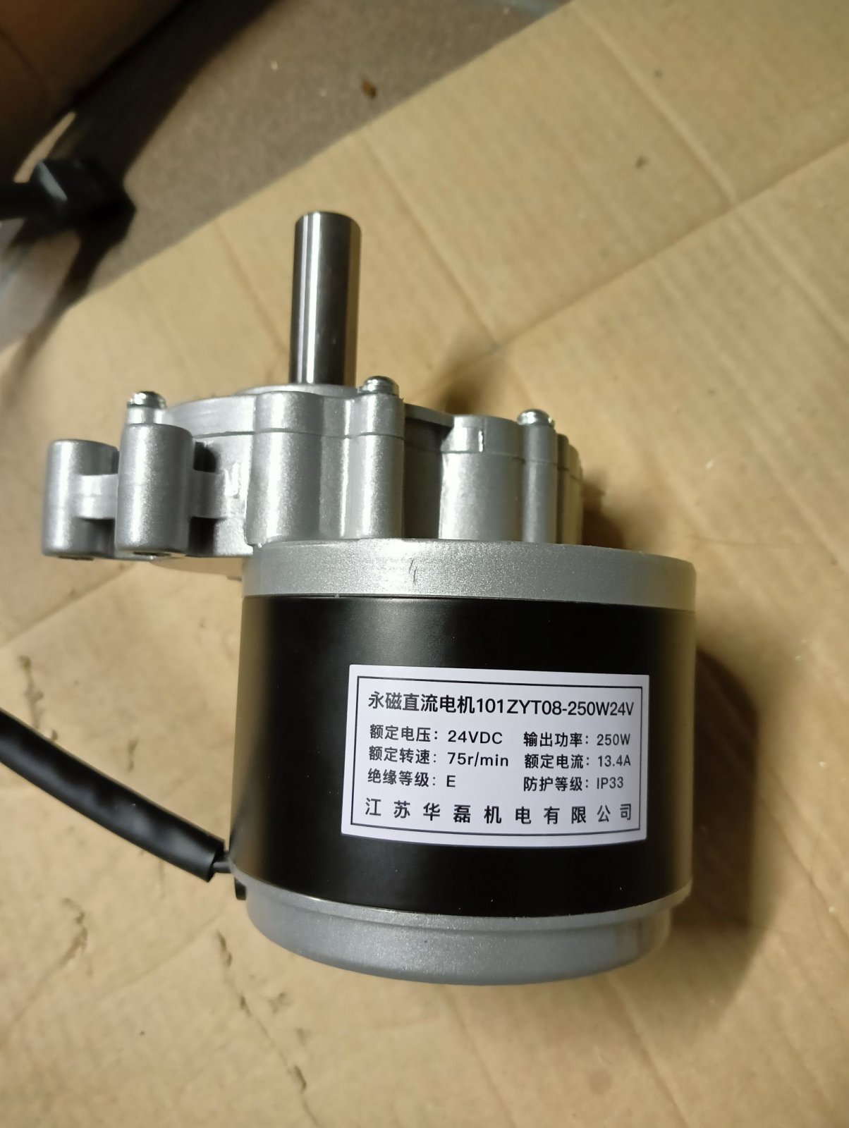

    It's all a bit mysterious , did you swap the motors in place maybe one is faulty and overloading IBT2?
    Did you run them directly from the power supply?

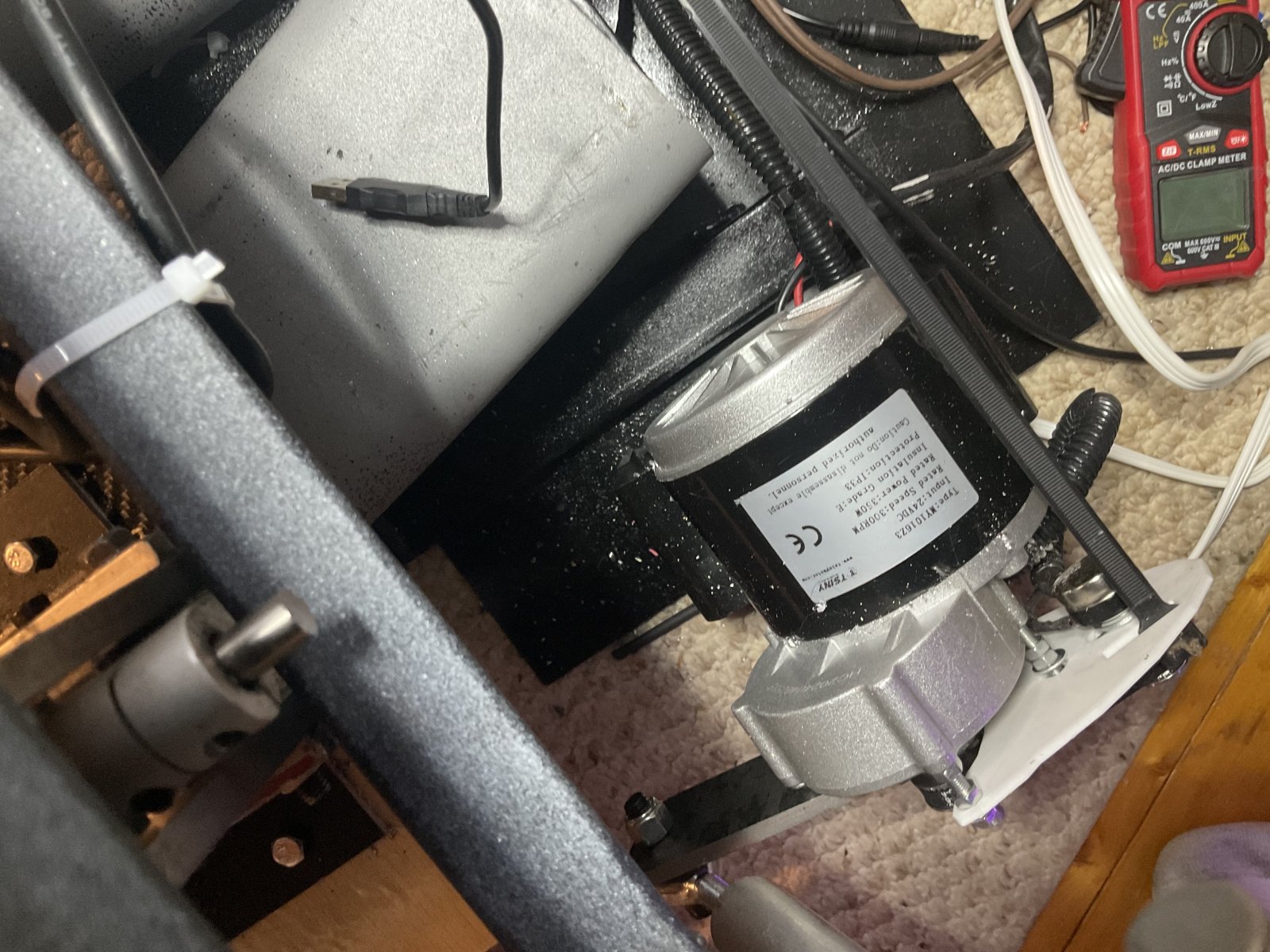

    Looking at those motors they look the same as my 250W 75 RPM IMG20241211204019.jpg

    The green line is not centered with the blue because when I took the pic the rig was in resting position (power off), I did swap motors thinking the same as you but that was not the problem
    Yes it looks the same motor the different is my motor is 350watts

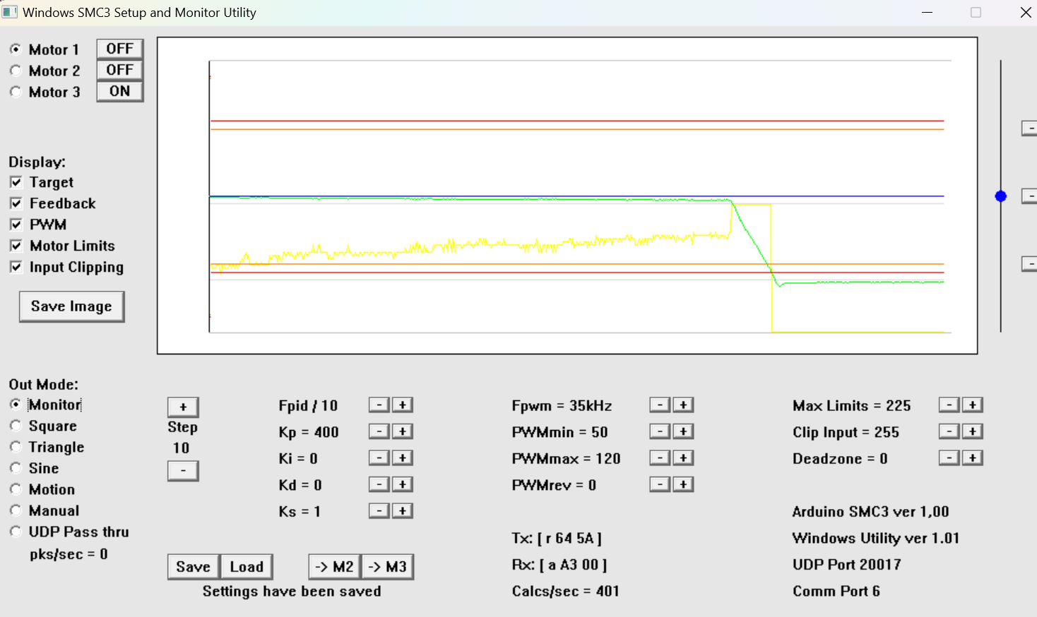

    Hello guys,
    I'm building a 2DOF with the exact same motors :cheers.
    I've got 1 power supply (24V 50A) and one IBT2 for each motor.
    An arduino uno with SMC3.
    For me the set up is quite working, SMC3 configuration is OK and the motors are moving perfectly.
    When i sit on the chair, still working for fwe seconds (when motor is on load, about 80% of MaxPWM at 120),
    and then just lose the torque, PWM (yellow line on SMC) goes 100% but nothing move on motor.
    I need to go over limits and switch back to ON to get motor moving again. --pic joint
    I understand that you've changed the IBT2 controller, so I'm going to do the same, but I'm hesitating between a sabertooth 2x32 and the model you mentioned above (100A) which is much more affordable, can you confirm that it works perfectly?

    In the drawing you showed you can clearly see that the signal from the potentiometer (green line) went below the level set by the max limit so the arduino turned off the motor to avoid mechanical damage.
    Post your thread and show exactly how you built your 2DOF especially the arm rotation measurement circuitry

    Hi Attyla.pl,
    The green line went below the limit because off current loss not the invers.
    The probleme is mostly corrected by changing the Fpwm from 35KHz to 20KHz as mention in this post
    Ibt2 with 24v?
    Discussion in 'DIY Motion Simulator Building Q&A / FAQ' started by xFFBx Tearier, Dec 6, 2023.
    "( i dont have link permission yet :()
    But it's still there if too much current is need on motor to hold the load.
    I'm a bit shy about showing a simulator that hasn't yet been debugged:rolleyes:, and I was thinking of sharing it once it's stabilized and reliable.
    Arm rotation measurement as been done by hand and for the time being, I've moved the actuators away from the pivot point to give the motors more leeway and sacrificed movement amplitude while I debug the simtool and VR motion compensation parts.

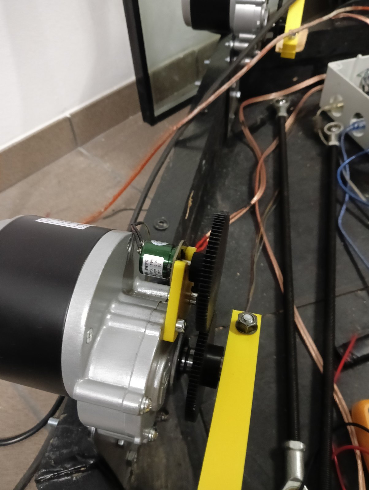

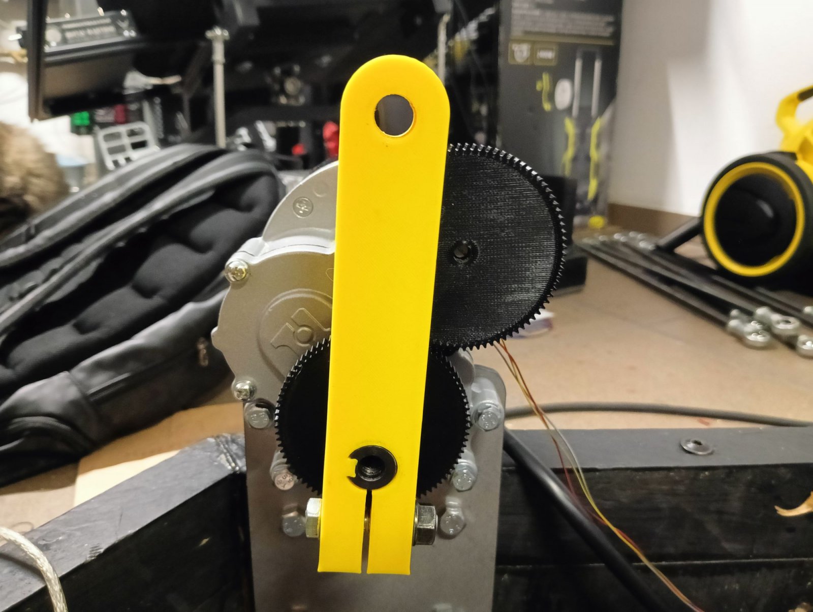

    I'm sorry but I completely don't understand what way of measuring rotation you are writing about, there is nothing to be ashamed of just show pictures not such things on the forum we have seen :)
    From my experience I know that the important thing is care and accuracy, often problems arise from their absence.
    Below is my way to measure the rotation.

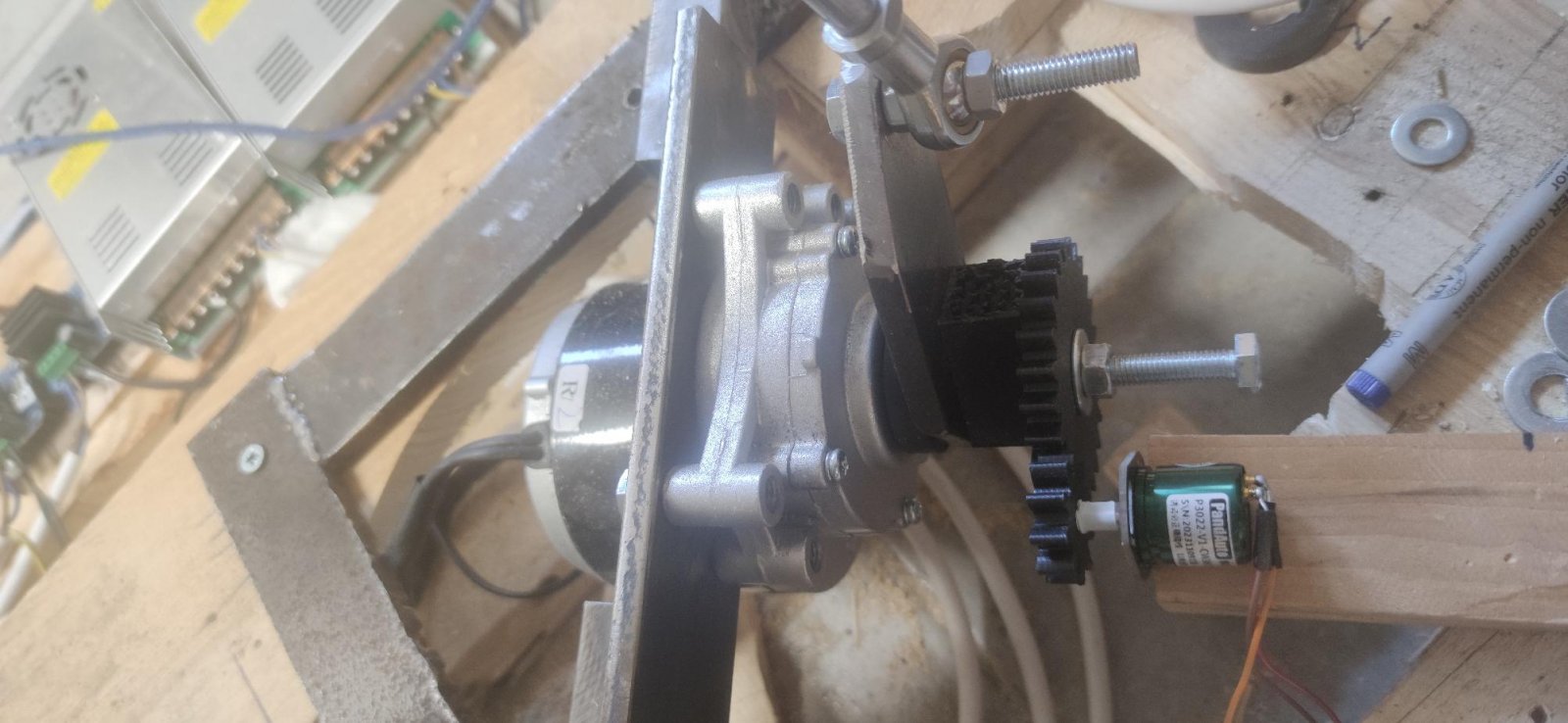

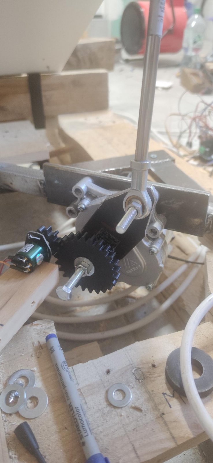

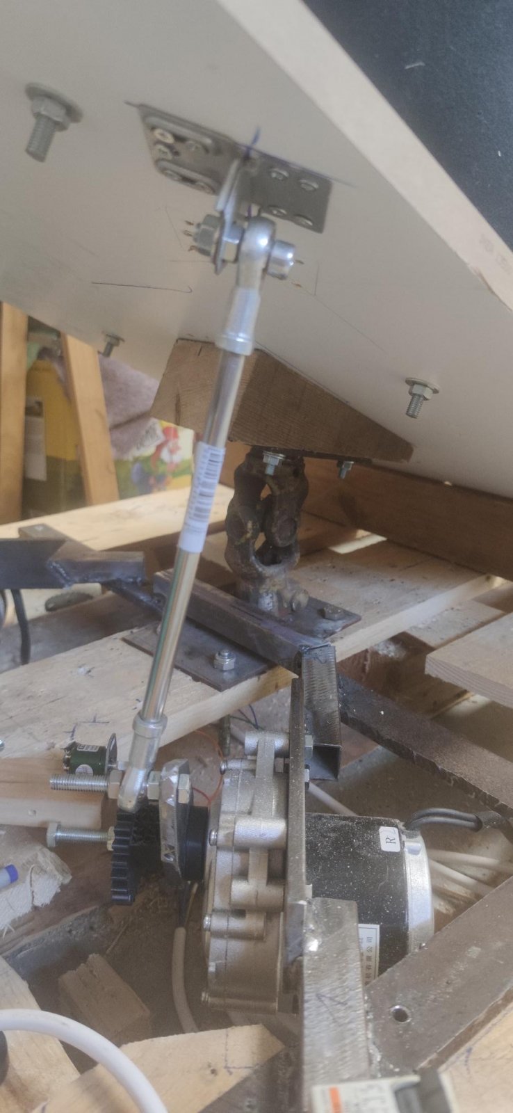

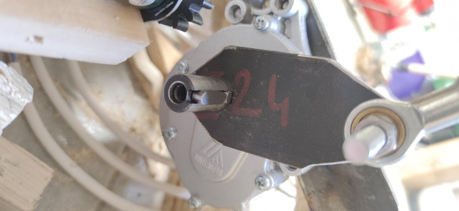

    Here is some pict,
    I misunderstood your question, I thought you were asking how I calculated the mechanical dimensions...
    the position feedback is done by a potentiometer, apparently the same as yours, and I applied a ratio of 2 between motor and potentiometer because the motor only works on 120°.
