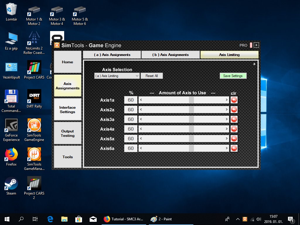

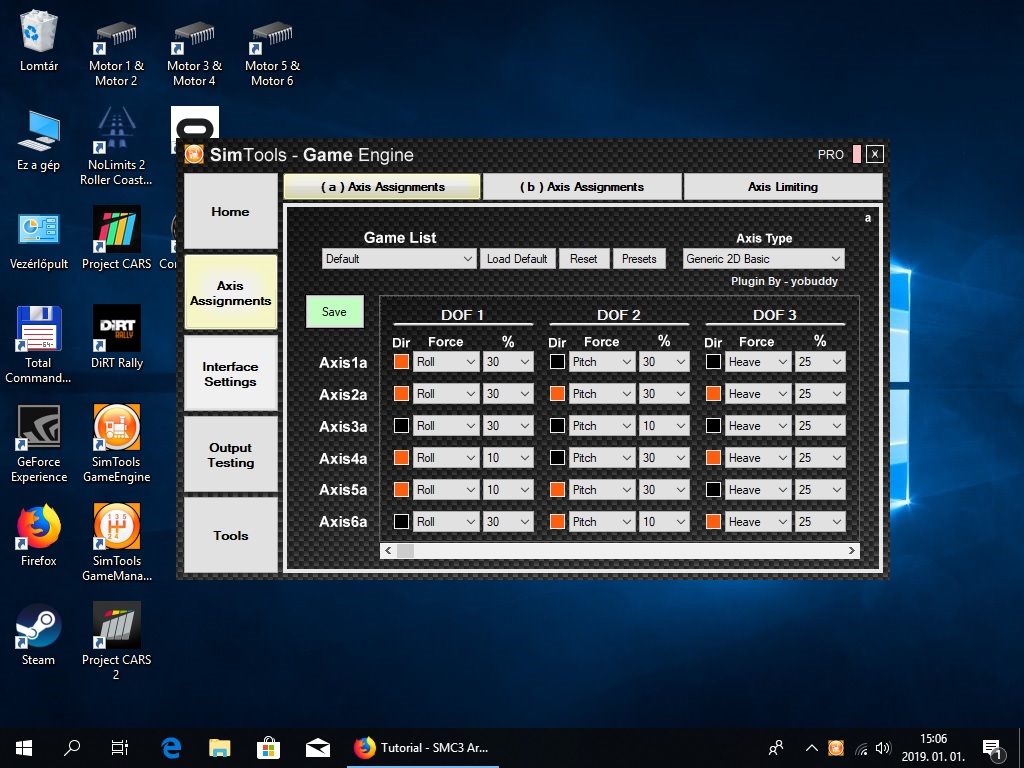

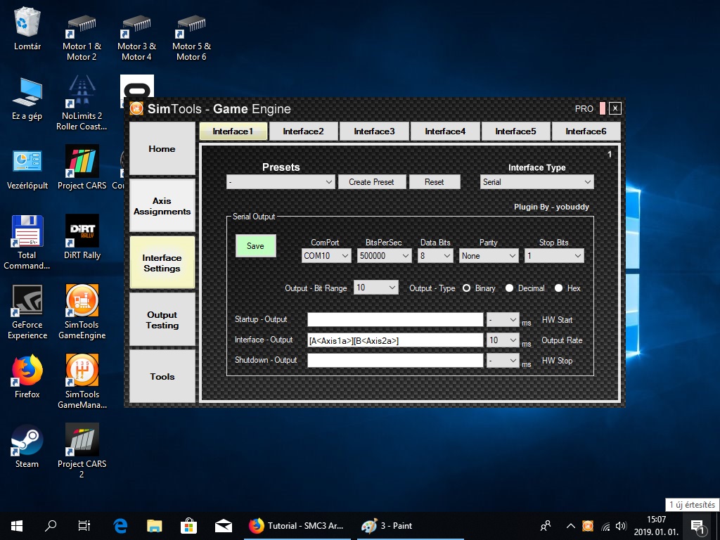

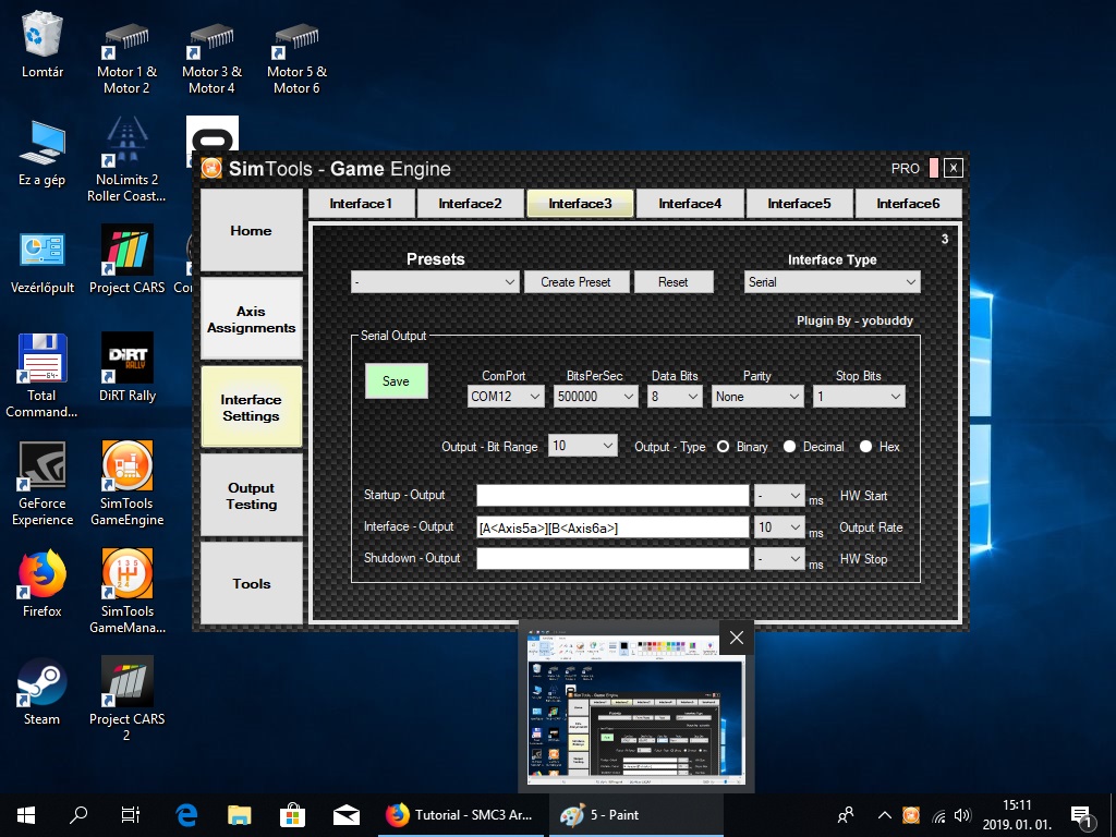

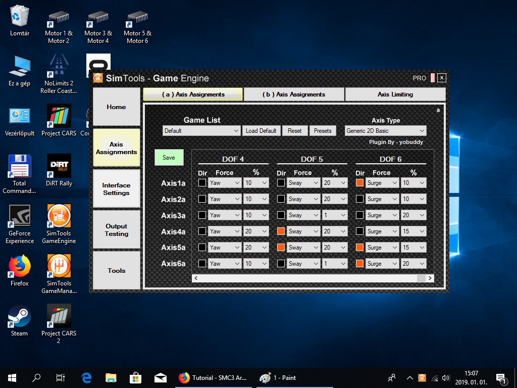

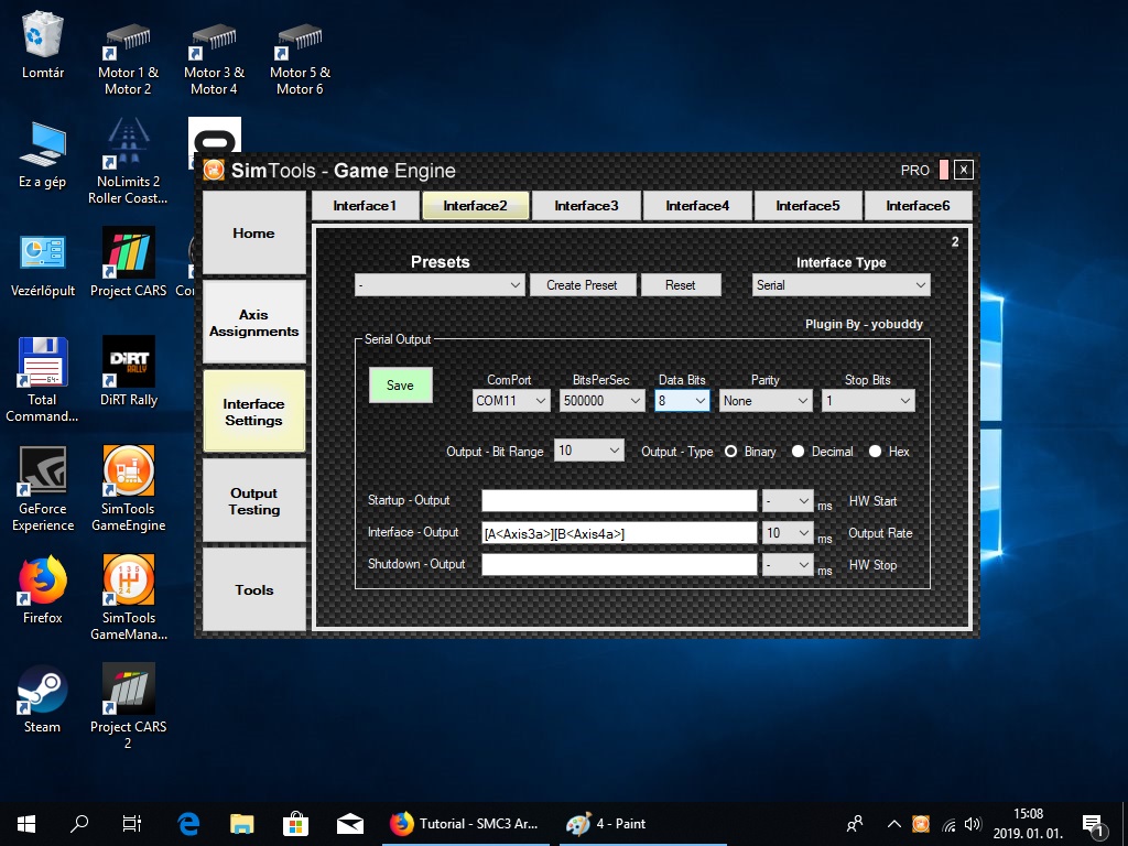

    I had no time to work with my simulator for about a year. But yesterday I finally upgraded the software from 1.3 to 2.3.1. My problem would be that the movement is not right. Output testing for the small change engine will turn a lot. Turns to the wrong position. After several hours of trying, I couldn't solve the problem. I have run version 1.3 without any problems before. Attach some photos of the settings. What might be the problem? Thanks

  2. yobuddy
    5,166
    48,208Coins
    +5,038 / 16 / -0
    Yaw should be the same same percent I believe.
    Without some pics of the sim, its hard to know what the settings relate to buddy.

    Thanks for the reply. This axis configuration worked perfectly under version 1.3. Today I got it all set again. The result is the same. I'm creating and uploading a video of the problem.

    Sorry for the amateur video. I hope it looks like a problem. If I set the axis to a single motor and want to test it, the 6 motor will move. I think the interface settings may be the fault. I looked over several times. I have set everything as described in SMC3. Still not good. If I try to change the values during testing, the engines jump. Everything is fine in the SMC3 Utils. In addition, in 1.3, these settings worked fine.
  6. yobuddy
    5,166
    48,208Coins
    +5,038 / 16 / -0
    When you start the output testing, the motors will try to center, this is normal.
    Are you suppose to be sending 3 outputs per Arduino?
    SMC3 setup shows this...
    [A<Axis1a>][B<Axis2a>][C<Axis3a>]

  7. Aljas Chief
    Aljas Chief New Member
    Apr 14, 2014
    8
    system administrator, electrician
    Hungary, Esztergom
    300Coins
    +13 / 0 / -0
    Thank you for your answers. The problem has been resolved. I had to set the language settings for windows to (US) English. Everything works perfect.
