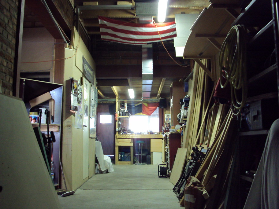

    Believe me, I realize it nearly impossible to do. But because of that, the reward is going to be so much greater when I complete it. It's because of the high cost of this project, I decided to build a scale model half size from the real one. This I can fit inside my workshop. Which, by the way, is a part of my intensions when we bought our house and renovating the garage in to the workshop it is now. So if you wonder if I’m serious about this project, there’s your answer. I renovated my house to be able to achieve the goal of completing my simulator project!!! That’s serious enough I would say!! 8)
    As a scale model it’s little bit easier and cheaper to design and build the gimbal drives systems, the safety systems, and all the other stuff. And yes I realize the force on the scale model will be different then on the real one. The goal is eventually to use this working scale model as a demo version for third party funding. I have made contact, during the period I had mine business as a second profession, with two Belgian firms who are active within the simulator business, one is building his own motion platforms, the other is building a new improved design of simulator instruments.
