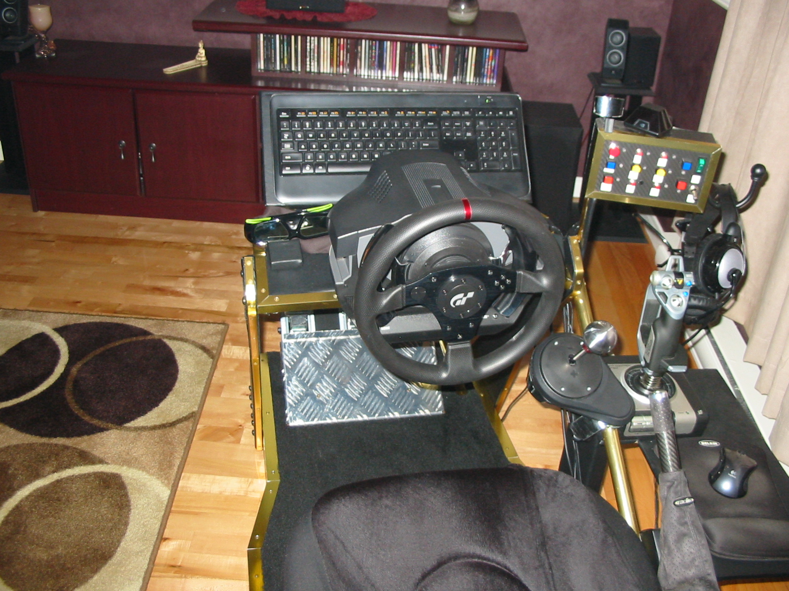

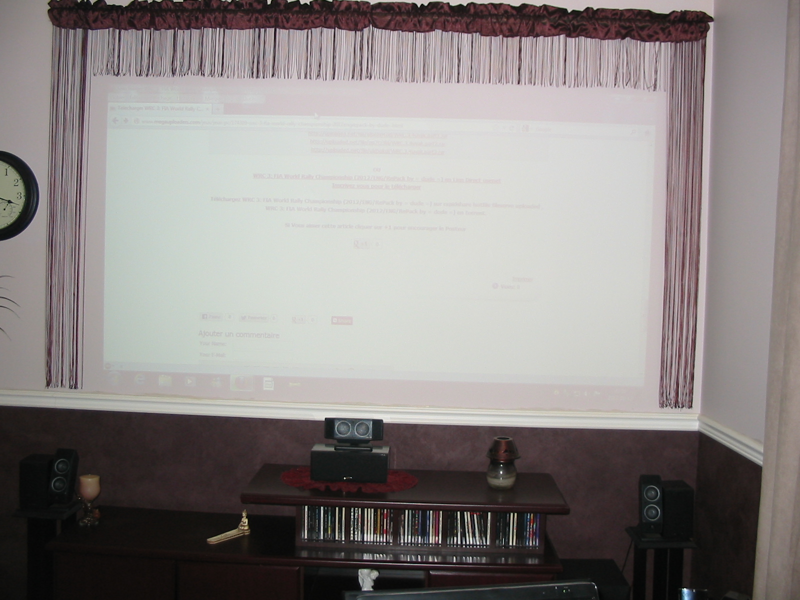

    Hi All !!

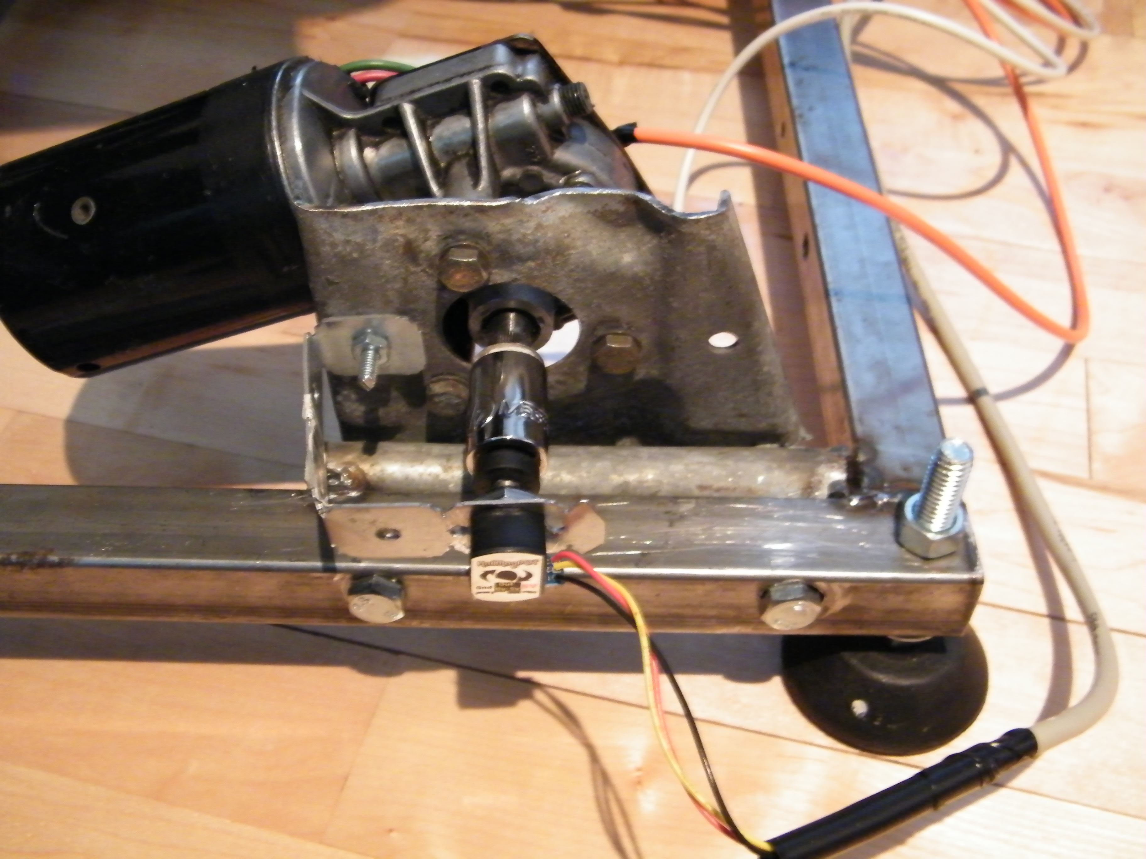

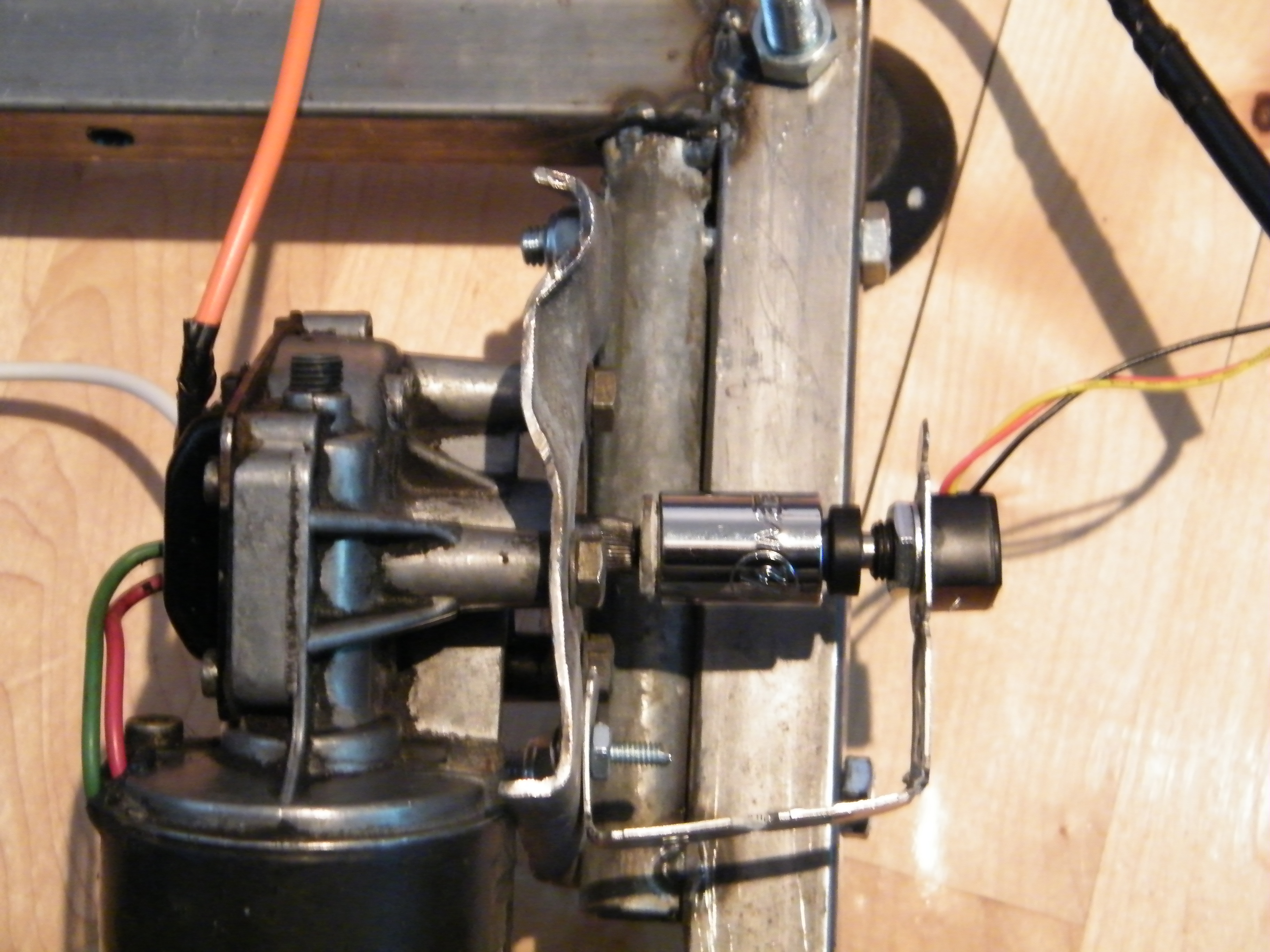

    Here is my rig, i play in 3d on a projector that puts 90 inches across with surround sound and subwoofer under my seat which gives me a great feeling, i just bought a T500RS and shifter which is great!! Now i just need to feel the road, i already have acquired 2 wiper motors from a friend and a U-joint for a pivot point.
    I have been reading for a while, now i know what i want and need info to make sure i start right. What i am looking for is to feel the bumps and elevation change, also want to feel when i change gear, rumble strips, brake and accelerate, what i dont want is to lean on the side first because my rig is a bit tight due to the gold tube that holds the shifter and handbrake, and i dont want the wheel to move away from me because my intentions are to have only the car seat to move separate to the rest of my rig, i would just like to have small movements, maybe like d-box. I have tought of moving my pivot point more in the front a bit, like underneath the pedals or around there to feel the elevation changes, but i think it will be wrong to feel the other stuff...looking for feedback on this point.

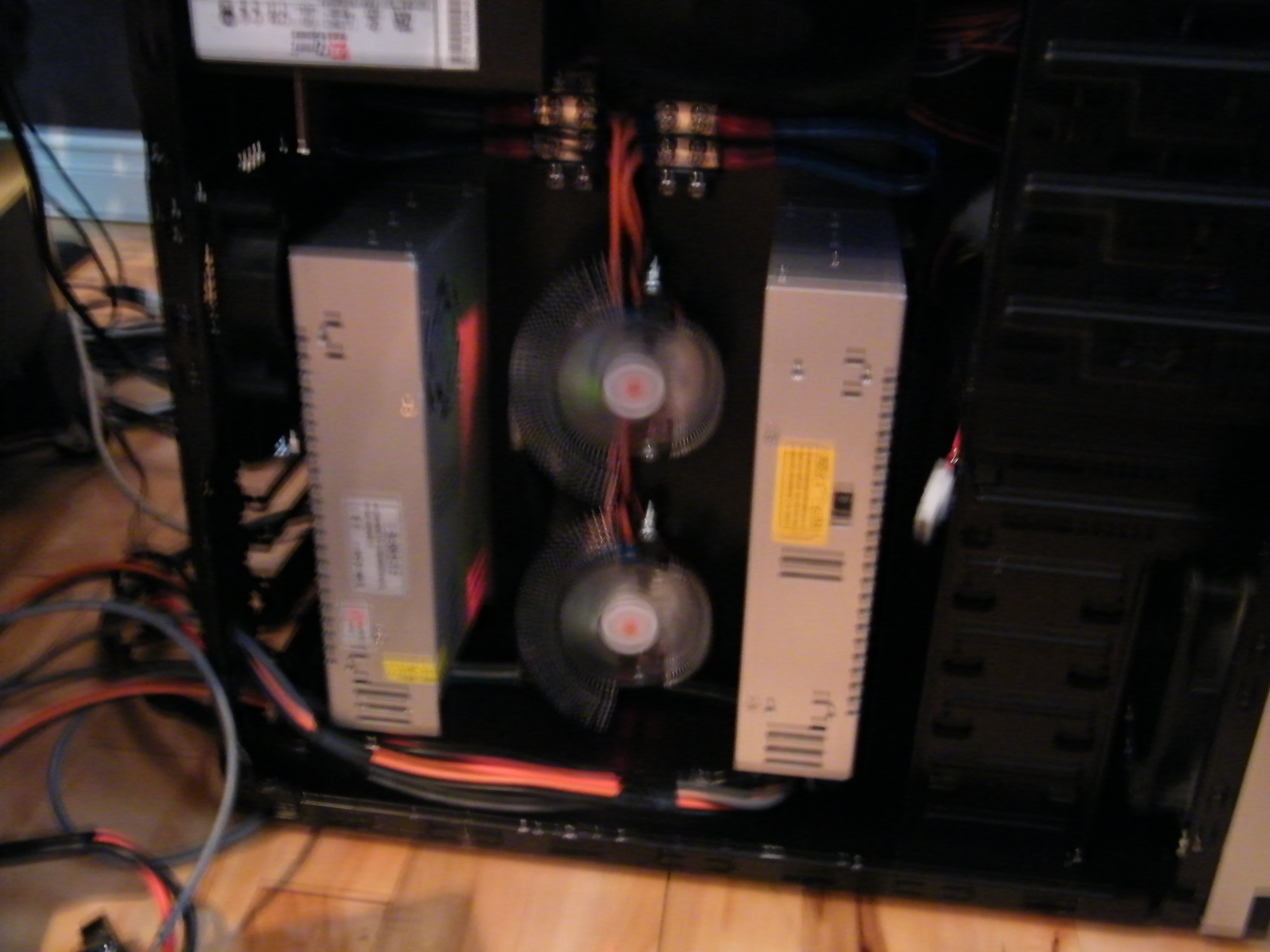

    What i found so far is that i will use the JRK 12v12(2x) for motor drive with 5k ohms pot for feedback, what i wonder is, do i need two separate 12v power supply for each JRK and how many amps each, if only one is required for both driver(JRK) and i can wire them in parallel, how many amps i need it to deliver? i intend to buy that here(see the address)...anyone can tell me which one would i need?

    and many question that i can answer a few,if u have already 2 wiper motors
    you can just use one 12 v and at least 25 amps power supply for both motors

    I would recommend one or two PSU with 30A . Your wiper motors will probably pull like 15 -20 A each, so one PSU might be borderline but you can try and buy the second one if 1 unit is not enough.
    If you stay with the wiper motors I recommend the AB-27, if you can afford the AB-27-PM with volt/amps display.
    Yes, put an heatsink over the big chip on the JRK drivers with a cooling fan. Pololu specifies continuous output of 12 A. You will easily be over that with a simulator - especially if you find that you need the two PSUs to have enough power. A heatsink and fan will prevent damage when operating at continuous output of 20 A or even more. The motors typically don't need extra cooling.
    With the jrk's it IS that simple as they are motor controllers all inclusive: High-A motor driver, USB interface, closed-loop feedback and position control. The fact that they have all the necessary parts included is exactly the beauty of the jrk's.

    Here is a few pics to were i stand right now, been assembling all the electric parts into an old pc casing...tested the jrk util, solved a ground problem with always nice help from BSFT(David Lane), i will be looking for infos on x-sim soft to understand how it works, then on to finishing the assembly and put it under my rig in a nicely clean installation :) i will have to cut the wooden platform in the seat part to make it wider so seat doesnt bang with sides, lateral movements will be subtil only cause of gold tube that holds shifter and handbrake for rally :) so no big g-force here, i am looking more to have Frex like movements, i just hope that wiper motors will hold a bit more weight than myself, i am 150 pounds, got some friends that weight more than me :)

    i am finally through!! got a working rig after 6 months of planning, searching, waiting for stuff to arrive, assembling and testing...WEW!!
    couldnt had it done without you guys, especially BSFT which i thank a lot again :)
    So here is afew vids to show you the Final for now version of it, i am planning on adding a 3rd DOF later (elevation), maybe next winter, and i hope to be able to add it without having to heavily modify what i have now.
    Enjoy the vids !!
