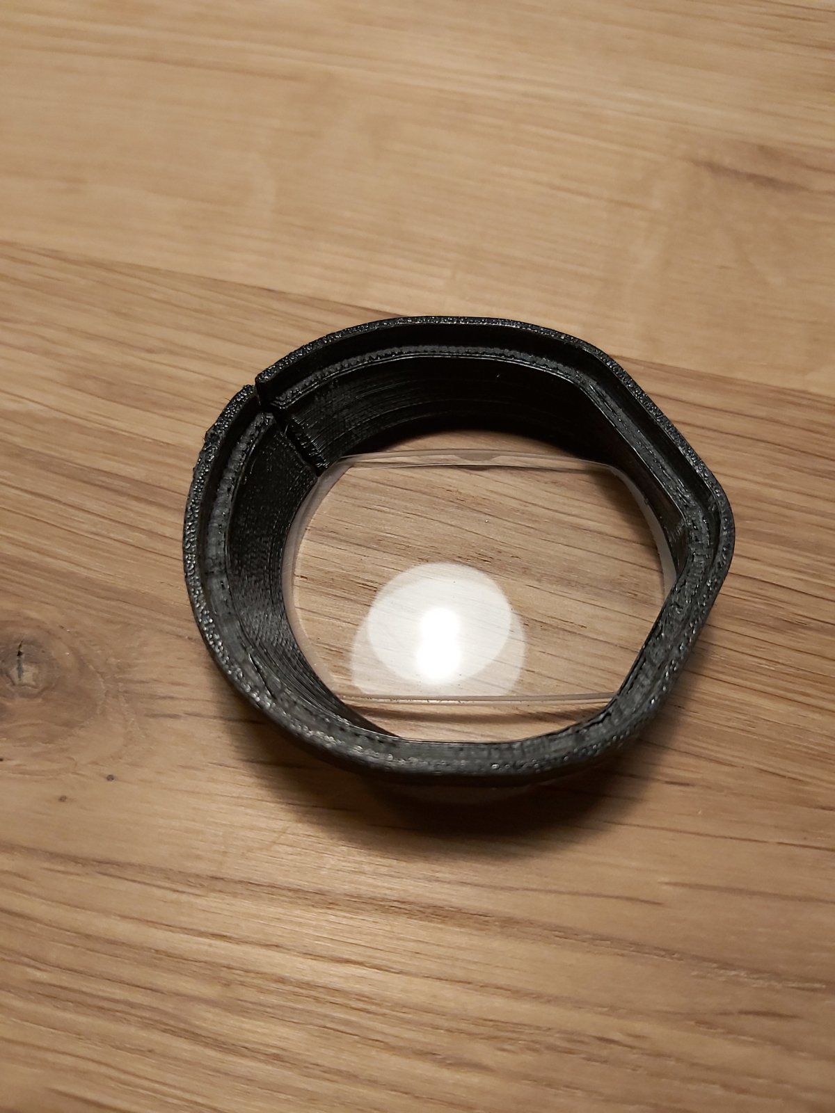

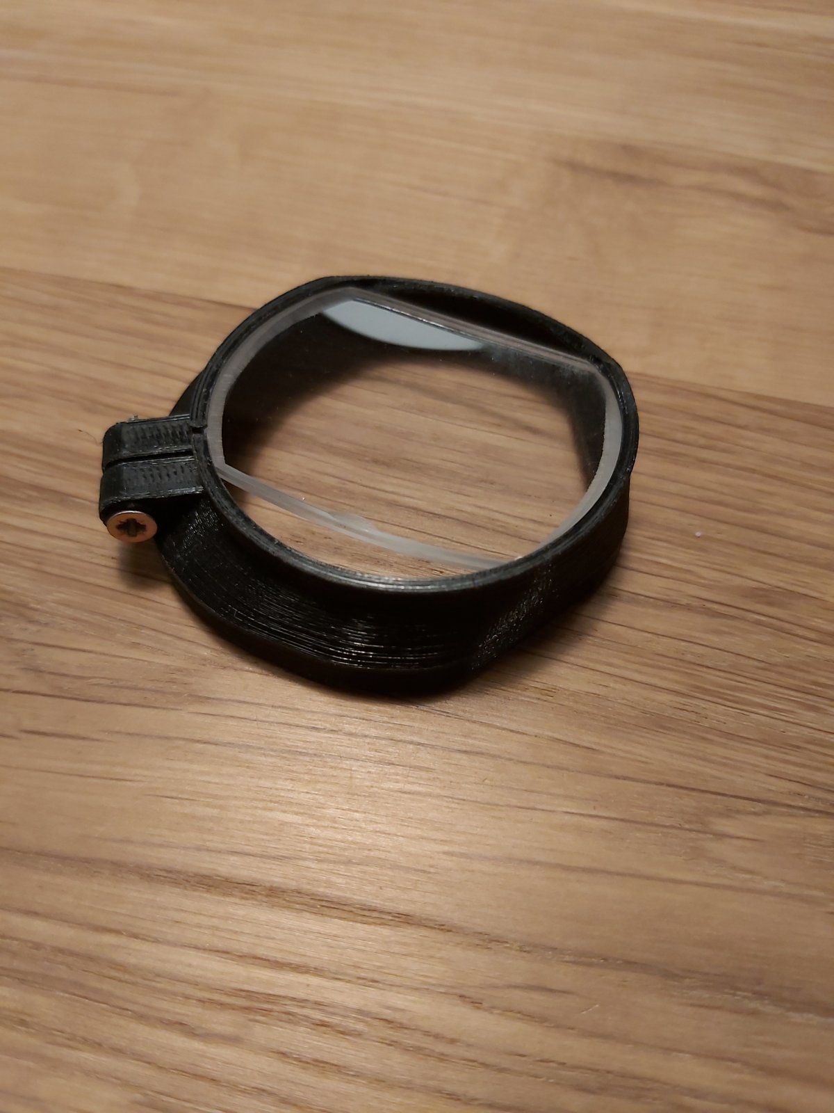

    Hi all!
    I found that the HPG2 is more critical to my eye focus and cylindric errors.
    So I have to wear eye-glasses to use the headset. After a short time I saw first signs of scratches from the eye-glasses, so I had to have a fast solution to this problem .
    I found this on "thingiverse". See here: https://www.thingiverse.com/thing:4694570
    As lenses, I used older eye-glasses and made them round and with chamfers with help of a grinding machine. This was done fast and easy.
    The lens Adapter 3D-print was also nice.

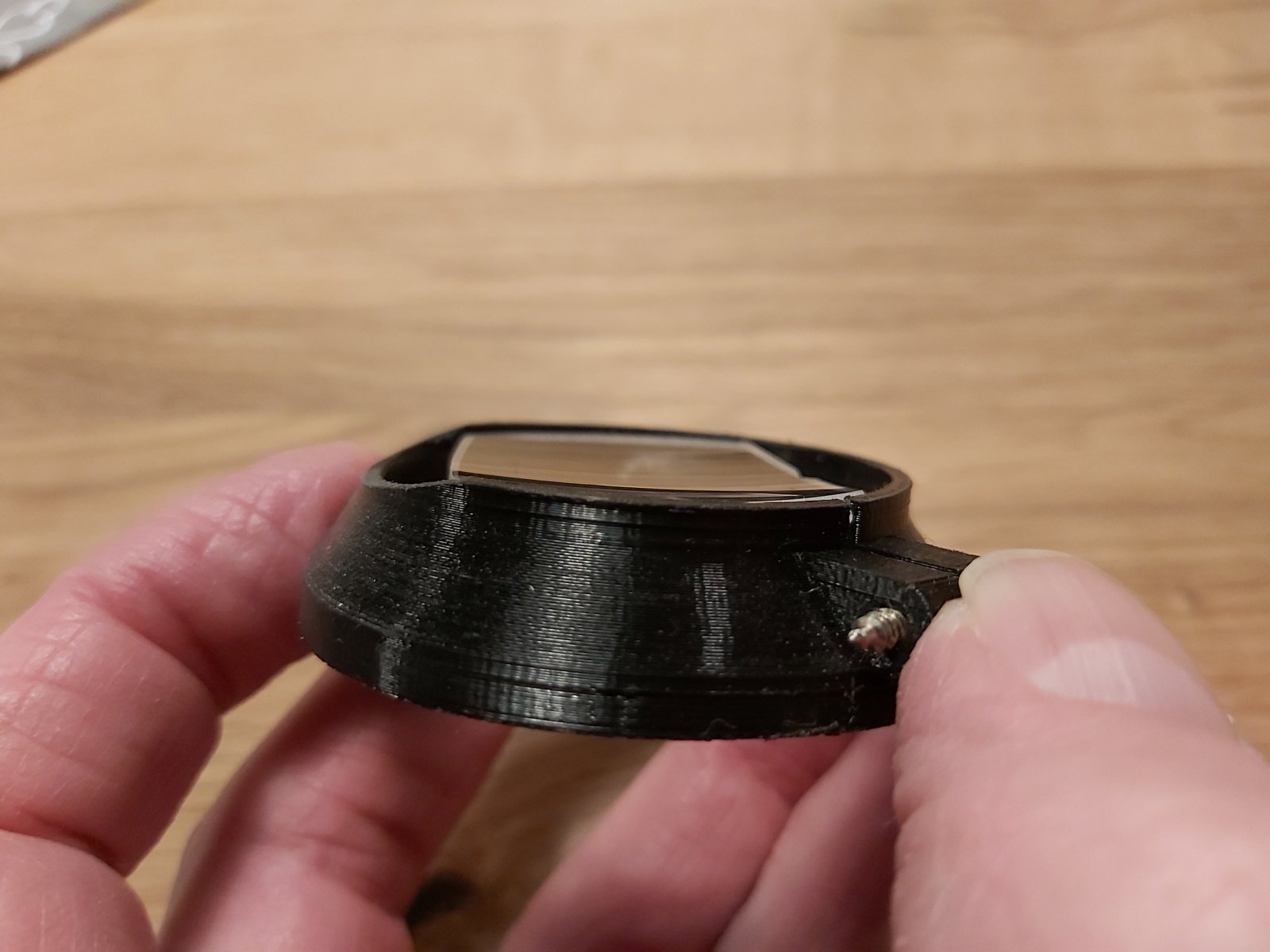

    Here is the result, that works perfect for me:
    The only modification I had to make on the 3D-print was to remove material (on the picture see left side next to the glasses)
    Wickie
