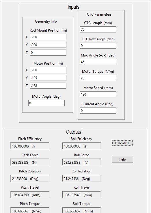

    I'm forging ahead without firm motor data using data from similar motor specs from Motion Dynamics. Can anyone give me some feedback on the pitch force and torque numbers? Are they within the acceptable range?
    21,493
    150,578Coins
    +11,017 / 55 / -2

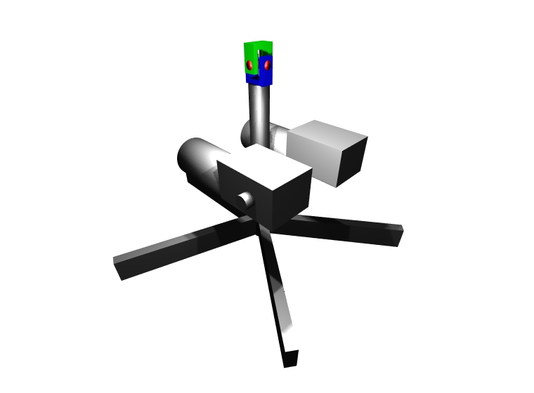

    I am not sure I can properly envisage the design you intend from your SimCalc inputs. Can you please supply a picture of the intended design and anticipated user/rig/peripheral load, as it seems to me you plan a compact design with a very high CTC and I suspect inadequate torque may be an issue.

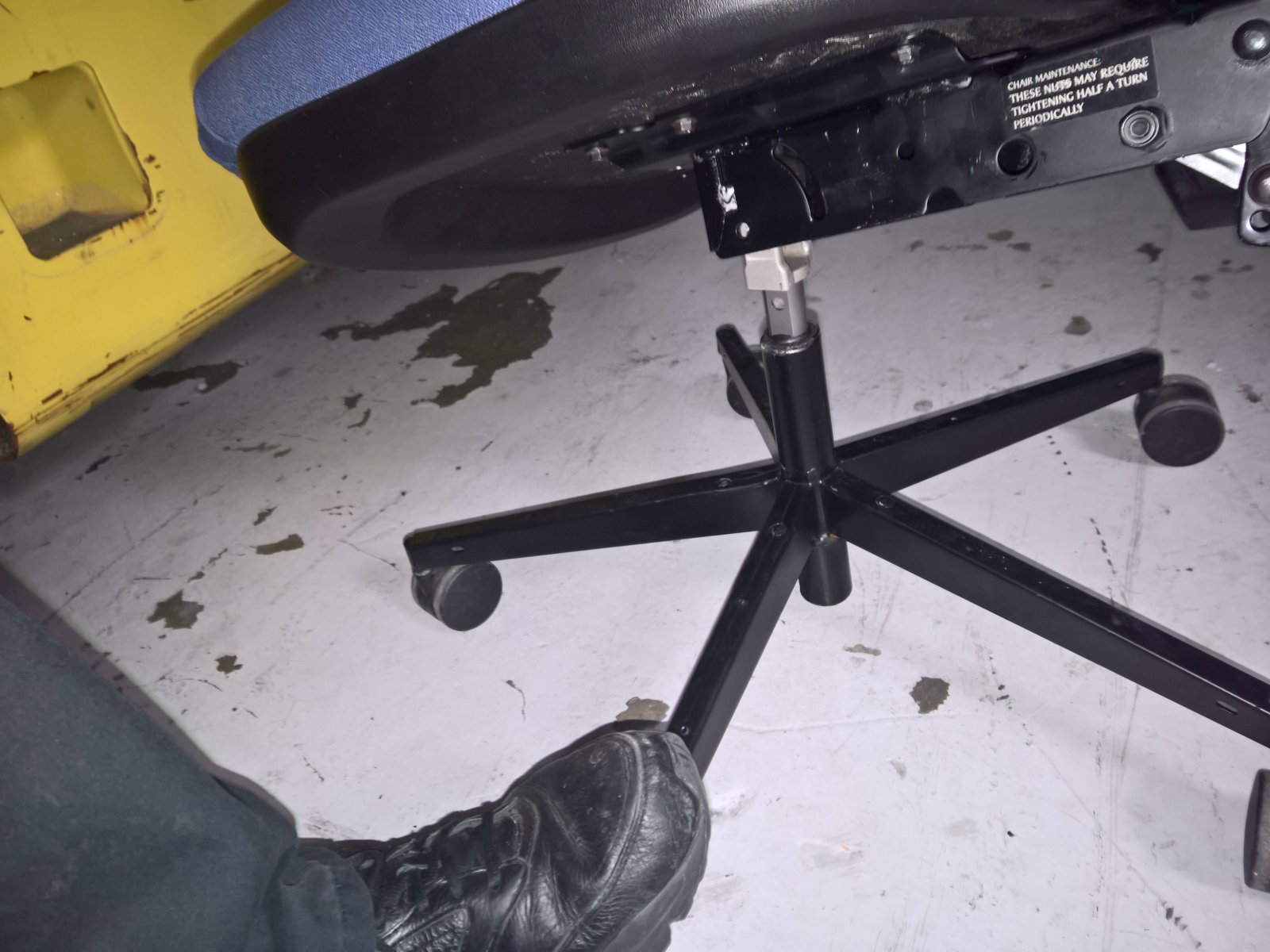

    Yes it is a compact full motion seat. The intended load is about 250 lbs. I have the motors tucked under the seat. the CTC is 75 mm. The connecting rods are 160 mm long. The connection point on the seat is directly above the actuator arm when it is centered, forming a 90 degree angle, and are 200 mm behind and to the sides of the universal joint. the travel of the actuator arms is 45 degrees in each direction resulting in a 15 degree pitch of the seat in each direction. If need be I can move the motors outward and back and I can shorted the actuator arms. I wish to maintain as much travel as possible as this will primarily be used for flight simulators.

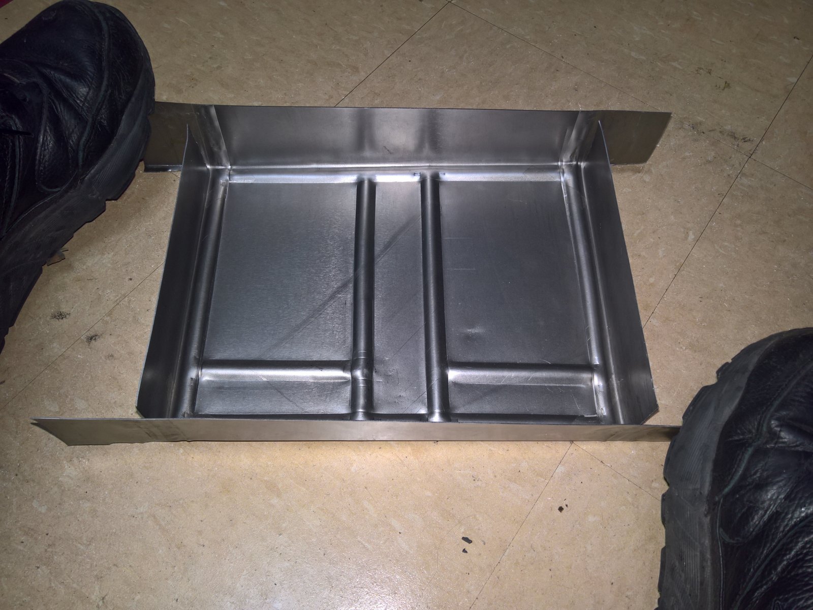

    Here is a picture of the base unit and test motor bracket. I have fabricated the motor bracket 4 times to make it strong enough while staying lightweight. Now I just have get the measurements for optimum motor placement.

    Disregarding mechanical loss, it will be Mass (kg) x Acceleration (m/s) = F (N). It takes 9.8N per kg to counteract gravity.

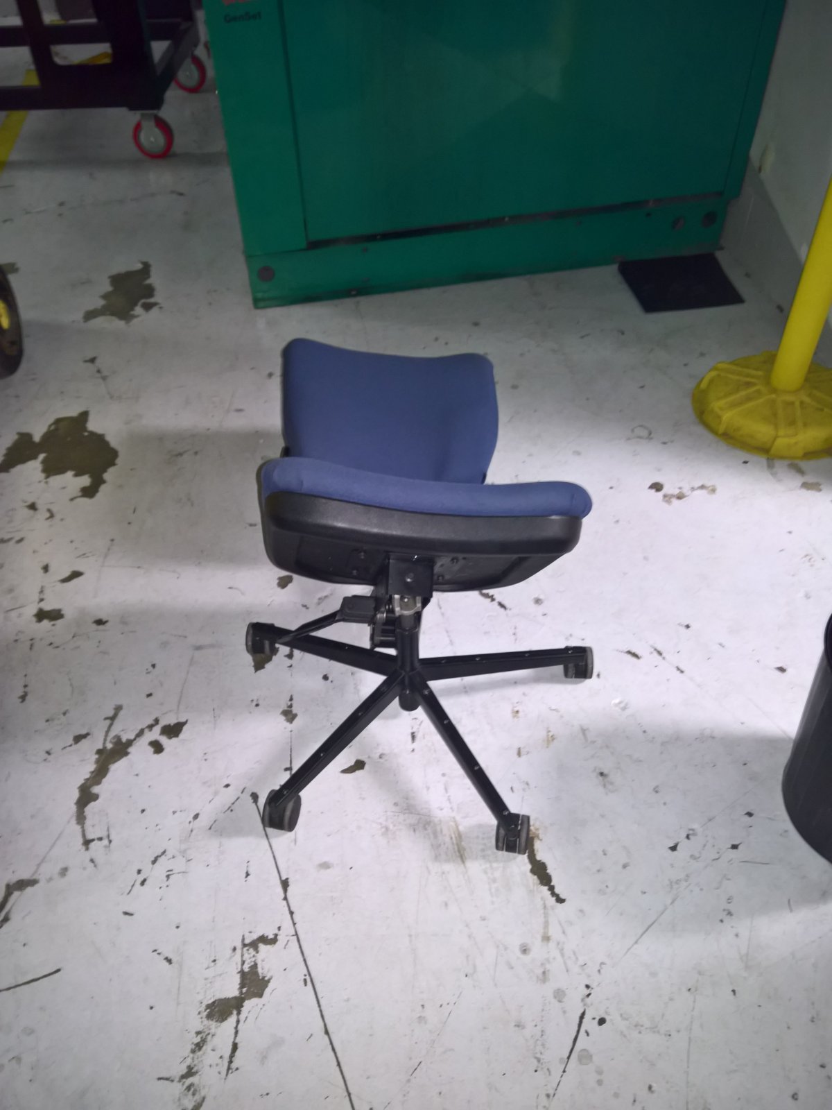

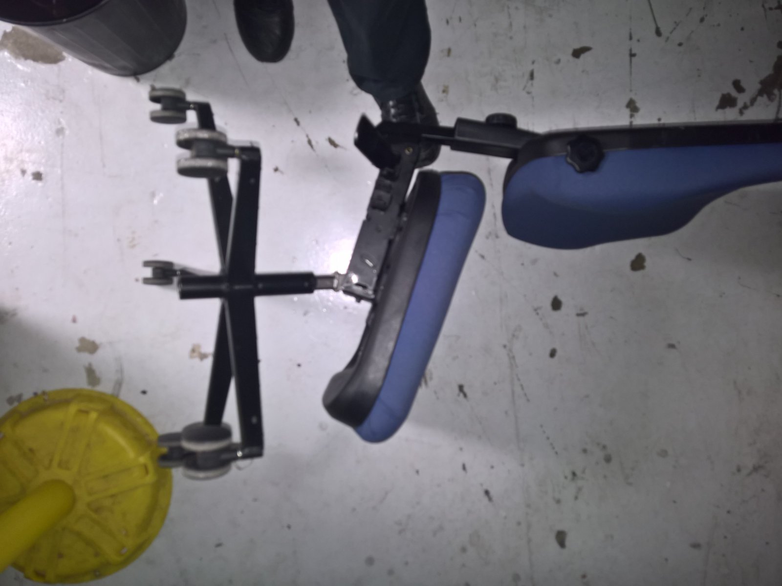

    I've been taking some pictures along the way that might help you better understand the CAD drawing. It was tough to hold and take the pics so I just laid it on the ground. The motors will be mounted to the chair. The batteries, PS, and controller will be mounted in a separate box remotely.
