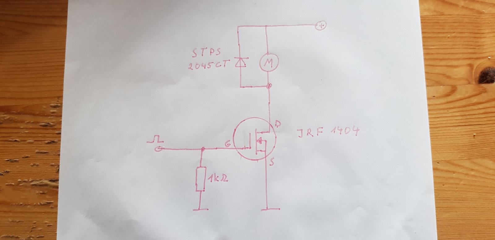

    a simple circuit to create a high current driver e.g. for wind fans
    use a heat sink and put the circuit if possible inside the air flow 20240104_101433.jpg
