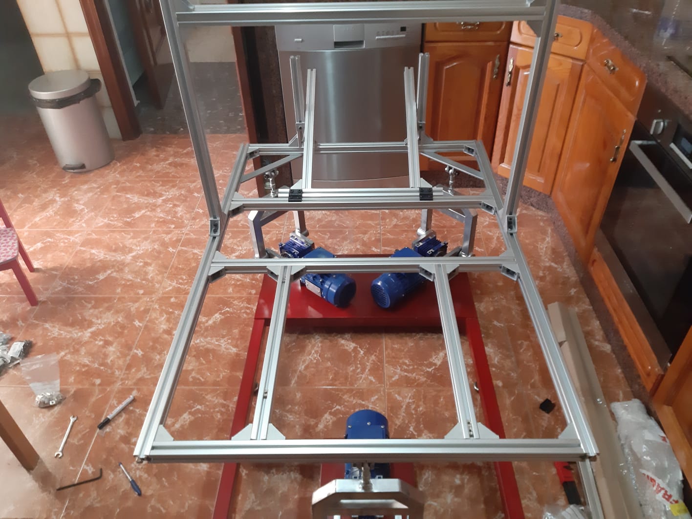

  4. zapata_h
    zapata_h Active Member
    Dec 25, 2013
    221
    España
    308Coins
    +43 / 0 / -0
    3DOF, AC motor, Arduino
    In my case, my platform with the pilot weighs approximately 150kg, in the front I use 2 motors of 0.18kw and in the rear one of 1.5kw, the rear is the one that supports the most weight, it works very well but more powerful motors do not They would be not bad, go through my profile and you can see the construction of my aluminum platform
  5. zapata_h
    Dec 25, 2013
    221
    España
    308Coins
    +43 / 0 / -0
