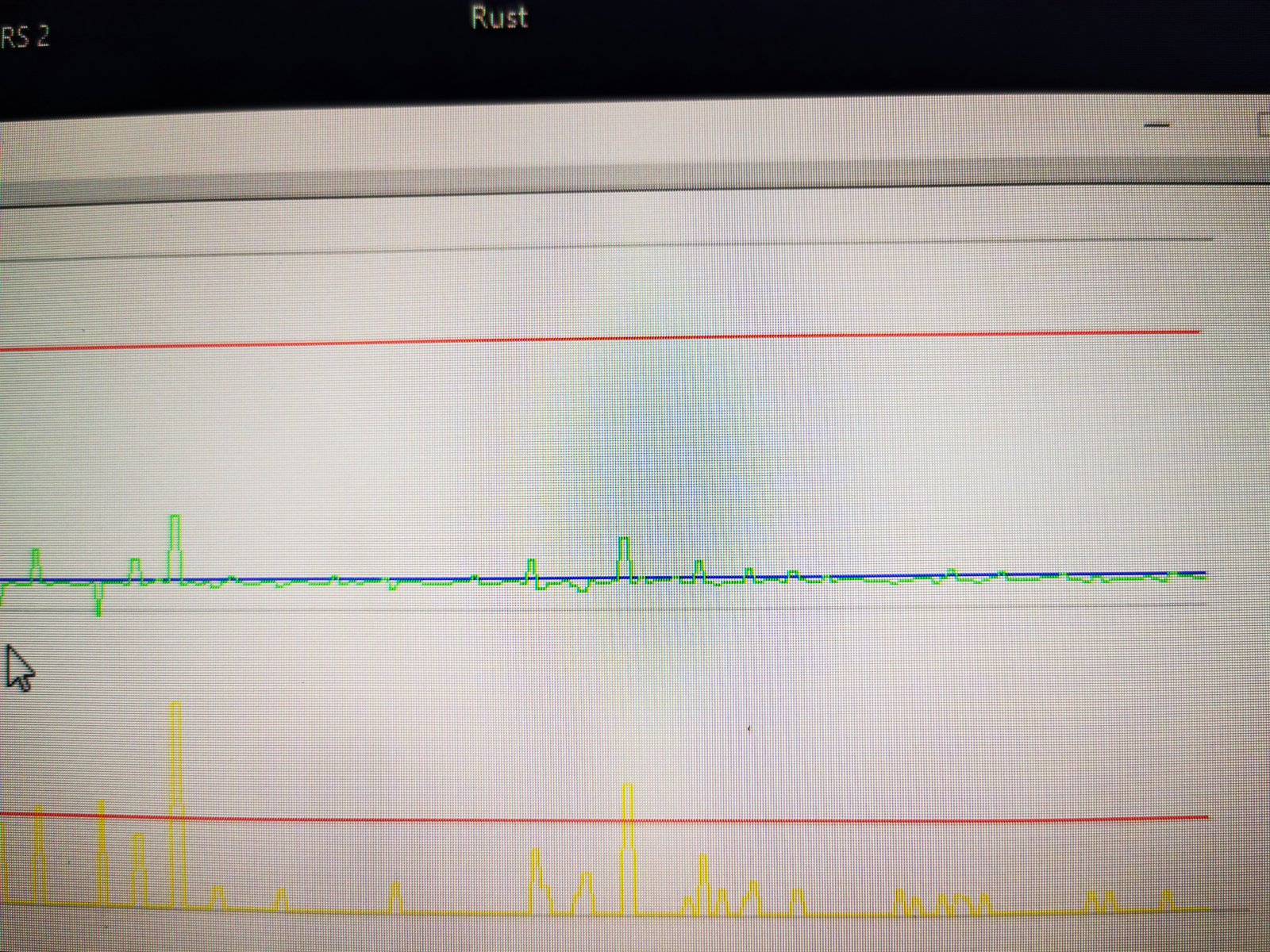

    Hey all!
    I'm having some issues with my potentiometers.
    When I turn on my arduino the feedback lines in smc3 are stable.
    Then however when in turn on my motor power supply.
    The potentiometers are giving me some hickups. (see added picture)
    I got my rig wired like this.
    https://www.xsimulator.net/communit...ket-serial-pid-motor-driver-w-softstart.9277/

    use shielded wires to the pot
