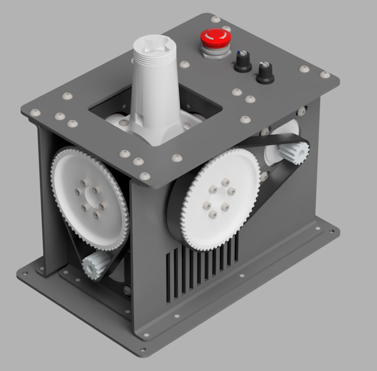

    Yeah, I don't know if you've maybe seen those guys who are working on the DIY FFB joysticks, but its essentially that isnt it, a single axis FFB joystick.
    Perhaps the load cell to let the pedal know it needs to return to zero when no force is being applied?
    Kinda like this, which makes use of an openFFB board.
    I asked the creator of openFFB if it could work for a pedal and this was his reply, "in theory sure but a new mainclass and support classes have to be written to create a pedal of course."
    Interesting...
