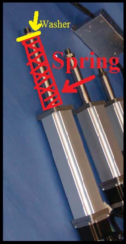

    I know it’s expensive but what 6dof isn’t?
    They produce 40kgf (about 88lbs) with a speed of 200mms
    That makes a platform capable of carrying (`528 lbs). Or 240kgf!
    We already can control them with x-sim and we know they work well.
    And this thing would be really fast compared to some of the other 6dof platforms.
    I'd offset the riders & platform weight with 6 - 20 to 35lbs springs.
    What do you guys think?

    I don't have experience with the actuators but from what I gathered, you cannot put much lateral force on them or twist the output shaft, otherwise they will brake. Putting them in a hex 6dof geometry would do just that.

    i mean the scn6 with 40 kg and a not to big drivers are work without springs.i have work with a other guy on a rock and ride with scn6 40kg and hi work so powerfull .and with the scn, my profil idea for 6 dof are work best.you can build a 6 dof and
    than you mesurge after work with the potis in the scn6 all positions. than it is not
    a problem with a not perfect sim building.

    hi,
    with a spring system i am shure.without springs you must have the weight over all (seat driver wheel
    paddels) under ca 100kg or you must make doppel scn6 on all 6 places.but a spring system is the best way with scn6 and a 6 dof.

    I am thinking about 48volt servo,s without springs(Thanos way)
    The scn6 40/300 force speed curve is dropping fast,i think a dof6 will be very slow
    with steppers it,s force against wight ,without springs
    i hope youre not gone waste a lot of money ,and make a nice dof 6
    best regards Ad

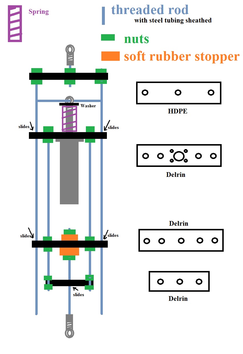

    This should take most of the strain off of the SCN6 actuator.

    This is a good start for making the actuators much stronger!
    The only problem I see here is the mechanical implementation of the whole platform. The actuator is way too long, about 60-70cm from joint-to-joint with a travel of only 15cm. This is obviously not optimal for a standard hex 6DOF platform because it would be very large, with relatively small actuator movement.
    I think it is very doable with enough optimization of the geometry and sizes.

    15cm? the actuators are 300mm??
    about 12 of movement i believe.

    Yes, sorry. My mind was on SCN5's.
