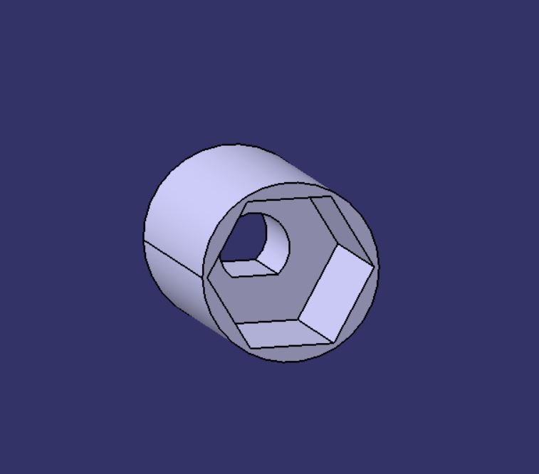

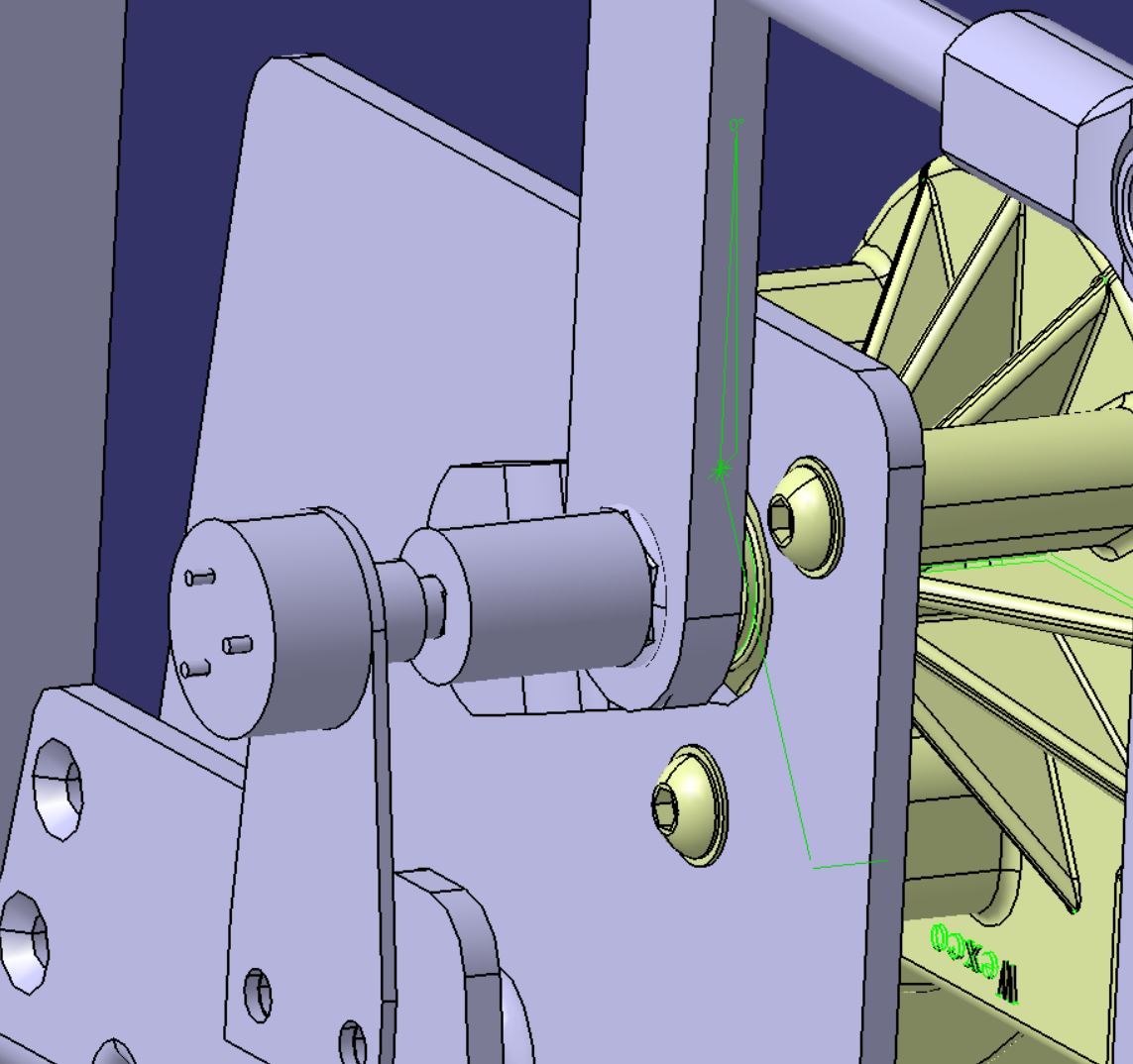

    This was my plan, but I have access to a 3D printer. I was going to print a piece that looks like a socket that would press onto the potentiometer shaft and then slide over the nut on the end of the motor shaft.

    That's more or less is what i did for my wiper setup. Id advice to have a flexible joint in between as they do tend to flex (at least mine but they are quite small) a little. I also did my own 90 degree hall sensors. Another tip if you got flexible filament is to make the nut part from that. depending on infill that can absorb a of micro shocks and flex a little when needed. Mine isn't a direct connection but a nut with a 6mm shaft that connects to the flexible joint.

    I was actually planning on getting some flexible filament and the thought had crossed my mind to use it for just this purpose, but I haven't yet. I think I'd also have to really cut down my wall thicknesses for it to matter. "Flexbile" is a relative term in filament world from what I've seen. Get even a few layers thick on the shell and it gets pretty rigid pretty quick. I did print up a sample one to test and it works okay, though I haven't actually mounted it to the wiper yet. The plate that the pot is mounted to is also 3D printed and quite thin, so it has a fair amount of flex to it. My thought was that it would hopefully absorb some of the imperfections with any luck. Won't really know for sure until I bolt everything down solid, but I also haven't played with anything in a while. All I have right now is the motors, pots, and a few JRKs. I haven't built up my frame structure yet and really don't have a suitable power supply. I used an old ATX one out of a PC just for some testing with the JRKs when I got them, but it will auto shut down after just a few unloaded back and forths as I think the surge current is just too much for it. I have my eyes on some LED style ones for the real build, but everything has kinda been put on hold lately. Work is doing 20% pay cuts for the near future for coronavirus stuff, so haven't had as much spare income to play with.

    This method is relatively simple, the material is very common, and the processing is simple.

    Just another mention about flexible and attaching to the nut. Another advantage of the somewhat flexible is that you can undersize the nut cutout slightly and get a tight fit. The other benefit depending on your setup and bindpoint is that if your system goes haywire (there's a likelihood that it will crush your pot mount. It's happened to me a few so i decided to go flexible on the but part so it dont just get crushed.
    And to mention it again, you can get the flexible very soft or quite hard
