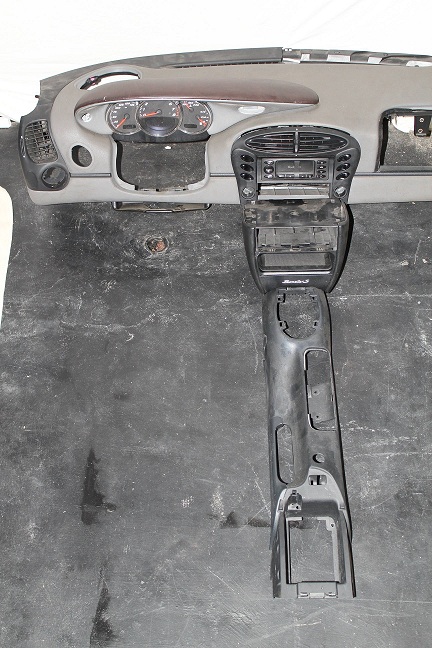

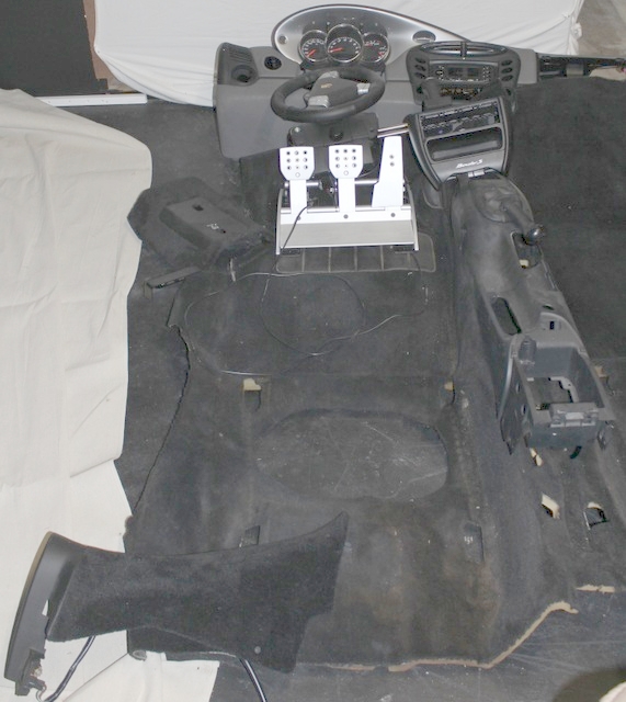

    I've been slowly collecting pieces for a Porsche 986/996 simulator and am now to the point to begin building. Is X-Sim something I should be using to do this build? I want to interface the instrument cluster or put servos and LEDs in for the warning lights. I'll be using the Fanatec PWTS with Clubsport pedals.
    Here is a list of my games, I have a few racing games:
    http://steamcommunity.com/profiles/7656 ... es?tab=all
    Here is a pic of my parts so far:

    Here is a bit better picture of the console and dash parts. The carpet and trim pieces made it hard to see in the previous pic. I've got a lot of building to do ahead of me, but that's half the fun. :)

    Directly interfacing with the cluster will be very difficult if it has canbus. You won't be abble to replicate the signals from the other components in the car who put the messages on the canbus.

    Worse case, I just crack open the cluster and add servos to the needles. No worries.

    A better idea would have been to use air-core motor drivers connected to the air-cores.
    The air-cores move a lot smoother than the servos, and they dont produce that anoying servo noise.

    I think you first need to research the chips on your cluster. And you need te find out if you have aircores or steppenmotors.
    It's nearly impossible to communicate directly to the cluster if it has canbus, but if the aircores/steppenmotors are driven by an external chip you might be abble to by pas the canbus chip and communicate directly to the aircore/steppenmotor driver chip.
    The rev-burner puts out a pmw signal, 5 or 12 volts, so this is only usefull if your cluster got these signals from the original car.
    If you post the numbers that are on the chips here, we might be abble to help you on your way to get it to work.
