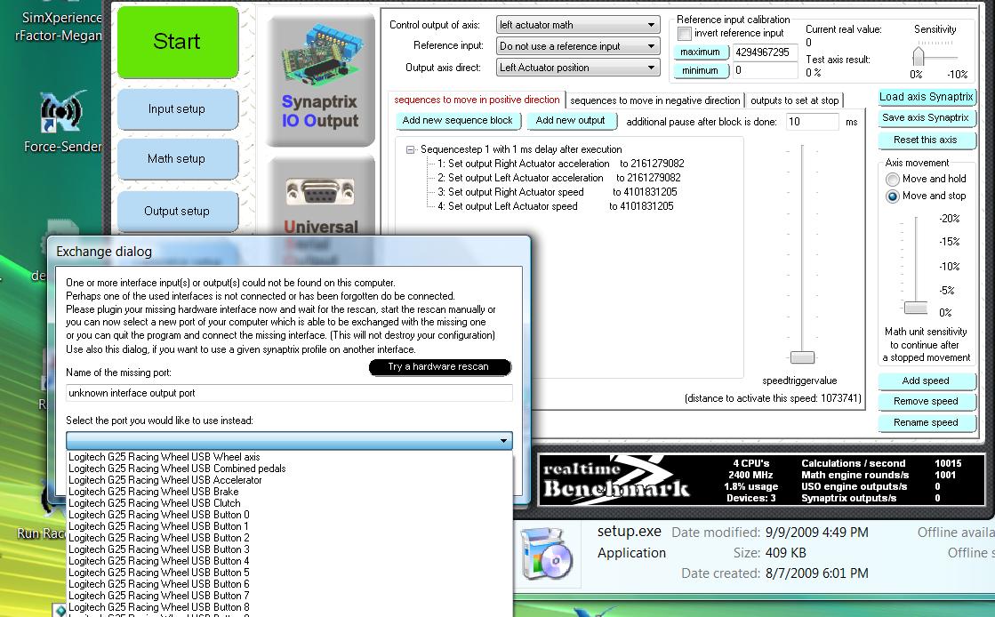

    Yes, this would be helpful. Actually, the entire issue of profile exchange needs to be addressed. I would suggest the following improvements. These would save me time in development of the Commander because I will have to build them if you don't.
    1.) Exchange dialog box should not appear simply because of case sensitivity (Ex- Left Actuator vs. left actuator)
    2.) Exchanges should be remembered. If someone else builds a profile and named their actuator Left SCN5 and mine is named Left Actuator and I make the mapping in the profiler exchange dialog, it should be saved. Then when I open another profile from this user, an exchange dialog will not be displayed.
    3.) SCN5 users can save a Synaptrix (actuator speed/accel), but cannot reload it. Profiler crashes when trying to load a saved Synaptrix in 2.1.0.3. This is consistent. I can provide an example if necessary.
    4.) Would be nice to be able to save gauges seperately and have them be able to be used regardless of motion profile, or automatically merged as you suggest above.
    IMHO, this is the order of importance.

    The consistent error is not with an rn2 file, but with the syn file.
    Here are the steps to reproduce the syn file error:
    1.) Create synaptrix as shown in attached image (this profile runs well and synaptrix works properly)
    2.) Save Synaptrix as test.syn
    3.) Attempt to load synaptrix file test.syn
    4.)Exchange dialog shown below will appear
    5.) Dismiss the Exchange dialog because there is no correct mapping
    6.) Profiler.exe will crash
    In addition to this consistent error, I also get an intermittent rn2 error. When loading some rn2 files that I am positive have a saved synaptrix for actuator speed and accel, sometimes the synaptrix does not display in the profiler. I will investigate this further and try to provide a sample in the next few days.
