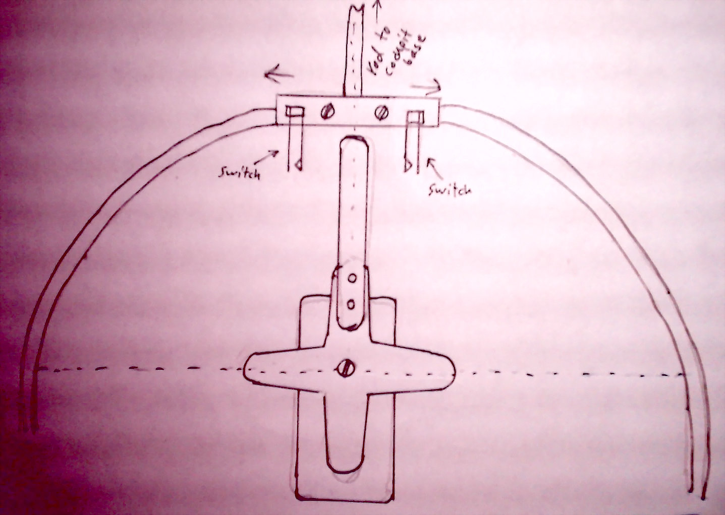

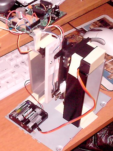

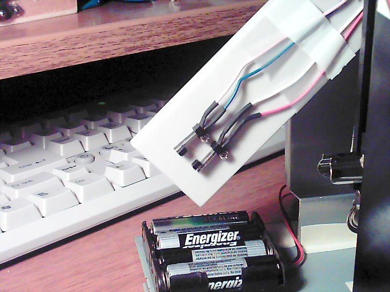

    You know, I entered into the motion simulator world many years ago. All started when Lurker (Keith Daniel) decided to share his work on an MS Flight Simulator software interface that can be connected to basic stamp microcontroller. He actually asked for help interfacing the basic stamp2 electronics with actuator that can be used to move a motion cockpit:
    http://forums.parallax.com/forums/default.aspx?f=15&p=1&m=70615
    Guess what, his intentions was to use pneumatics with digital relays in first. Instead I showed him that precise motion can be achieved using simple servos for modeling purposes. So in first his idea with pneumatics sounded strong enough for me too, and even started to look for pneumatics equipment in my neighborhood. I even devised a way to have precision placement of the pneumatics cylinder by having them follow the motion of a simple servo using this clever pulse mode!
    But after some software simulation of the motion to find the proper size of cylinders to use, we found that they suffer from the greatest flaw ever... AIR is COMPRESSABLE!!! That means that it could work weightless but as soon you put a mass of the rider on it the system would fail !!!! Only small cylinders could be used but they had no power then!!
