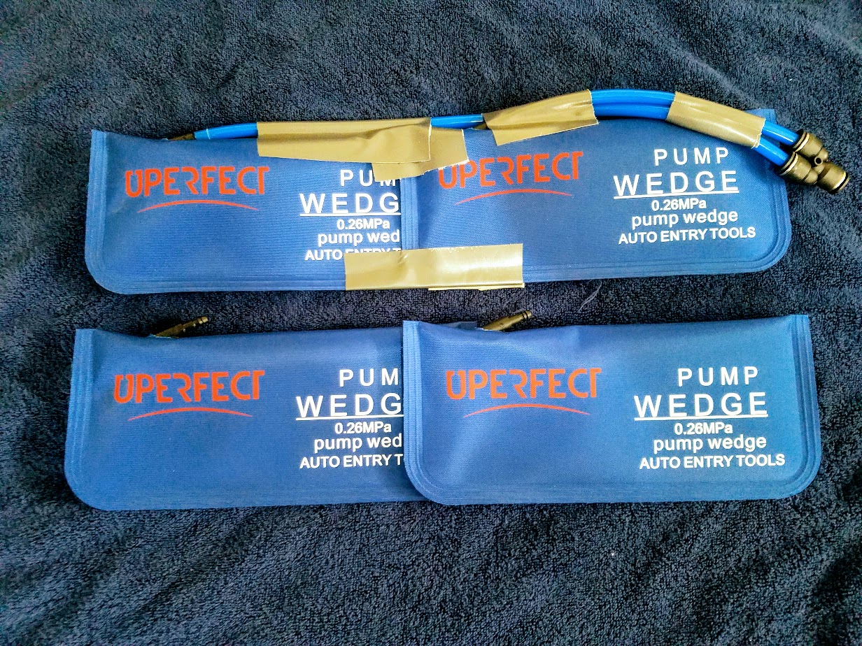

    I have been working on an air driven g seat.

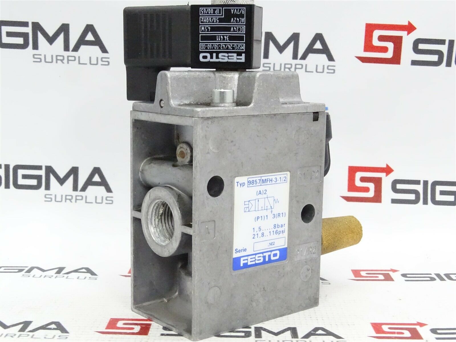

    It consists of a 1hp compressor, 16 air wedge bladders (4.92"x 11.02") , 6 Festo MFH-3-1/2-S Solenoid Valves (maybe more), 24 vdc power supply for the valves, and a semi DIY control board. No Arduino boards is needed.
    I have been testing the system using the NoLimits 2 roller coaster and Simtools.

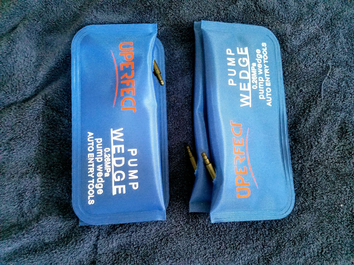

    4 air bags are duct taped together to form the Heave bladder.
    4 airbags are taped together for the Surge bladder.
    2 airbags are placed on top of each other to double its height when filled and form the seat sway bladder.
    A set of these are place along each side of the heave bladder (one on the left and one on the right) 4 airbags total.
    2 air bags are taped together end to end to a form side sway bladder. They are mounted along side of the surge bladder (one on each side 4 bags total)
    Lots of fittings and 20 meters of tubing..

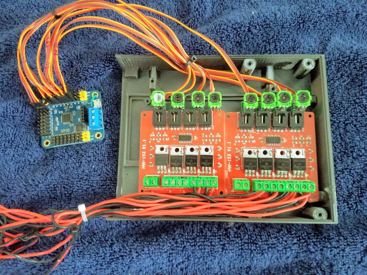

    The control board is based on a Mini USB 24 Channel Servo Motor Driver Controller Module.
    I will post some pics and links.

    Good project! When you need to deflate the bladders, you open the exaust, is it noisy?

    I really like the idea of multiple cells acting together. I would guess that would give faster inflate/deflate.

    The solenoid valves exhaust whenever they are not powered up with 24vdc.
    The exhaust is rather loud. As you know you can put mufflers on them and it helps a bit.
    A more involved exhaust muffler would make it a bit quieter.
    I always use a Vr head mounted display when playing so the noise is not very noticeable due to the integrated headphones .

    The air bladders have truly been a learning experience.
    I built some air bladders using TPU impregnated ripstop nylon.
    A single "seat sized" bladder took 5 seconds or more to fully inflate. The multiple bladders are much quicker. Right now the seat heave bladder fills in a 1 second or less.
    Some general info::
    Air Pressure is limited to 15 - 20 psi.
    The bladders are rated to 37 Psi.
    Automobile tires typically are filled to 32 Psi, so 20 Psi will lift your butt just fine..:eek:
    You need to have some type of air pressure regulation..
    High air flow rate is very important versus air pressure which is not.
    The Diy control board shown is built from low cost easy to aquire components.
    No programming is needed but some soldering is..
    Simtools game engine works perfect.
    The board shown can control 8 solenoids.

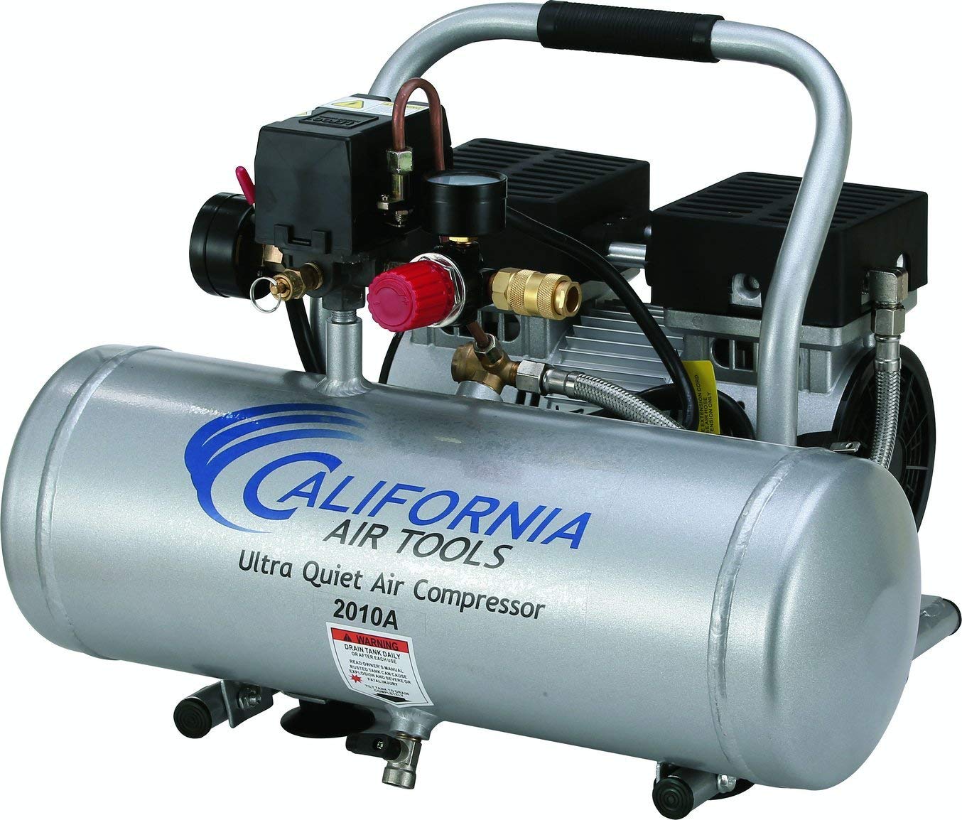

    I’ve been considering that compressor as well, given how quiet it is. Curious to see if 3 CFM meets the needs of all your bladders. If so, I’ll jump in and do something similar.

    Jason you may be right. 3cfm most likely will not cut it for some situations.
    I paid $137 for the 3cfm compressor on sale.
    Amazon has a 6cfm quite compressor for $335 (California Air Tools 10020c).
    I may get a second 3cfm if needed . lol
    You are also correct about the deflation time.
    If you are doing a flight sim I don't know you will need as much air as the a driving sim will need.
    In the roller coaster sim with a 2min 30 sec run, it pretty much depletes the 3 cfm compressor.
    It may be possible to "tune" the system for more efficient use of the compressor.
    I believe it was in RacingMat's thread they showed a commercial G-Suit that appeared to have big HP compressor with at least a 100 gallon tank.

    I believe I have solved the remaining problems with my G-seat.
    The left/right side air bladders which are positioned on the vertical back of the G seat and provide the Sway effect did not really squeeze the Driver/ Pilot with enough force. The reason was the bladder had little to work against unlike the heave and surge bladders which rested against the seat back and bottom..
    I simply added yet another air bladder on top of the side/sway bladders which solved the problem. These new air bladders are not powered by the main solenoid controlled air system but are simply pumped up to the appropiate pressure using the small hand held bulb pump.. It works well and allows you to adjust side sway clearance for different sized pilots...
    I made a short unedited video of the air bladder action.
    It is being operated by a solenoid valve.
    The deflate speed is slowed down a bit due to the fact there is nothing pushing on it.
    BTW: 15 psi will lift a 95Kg load with little delay.

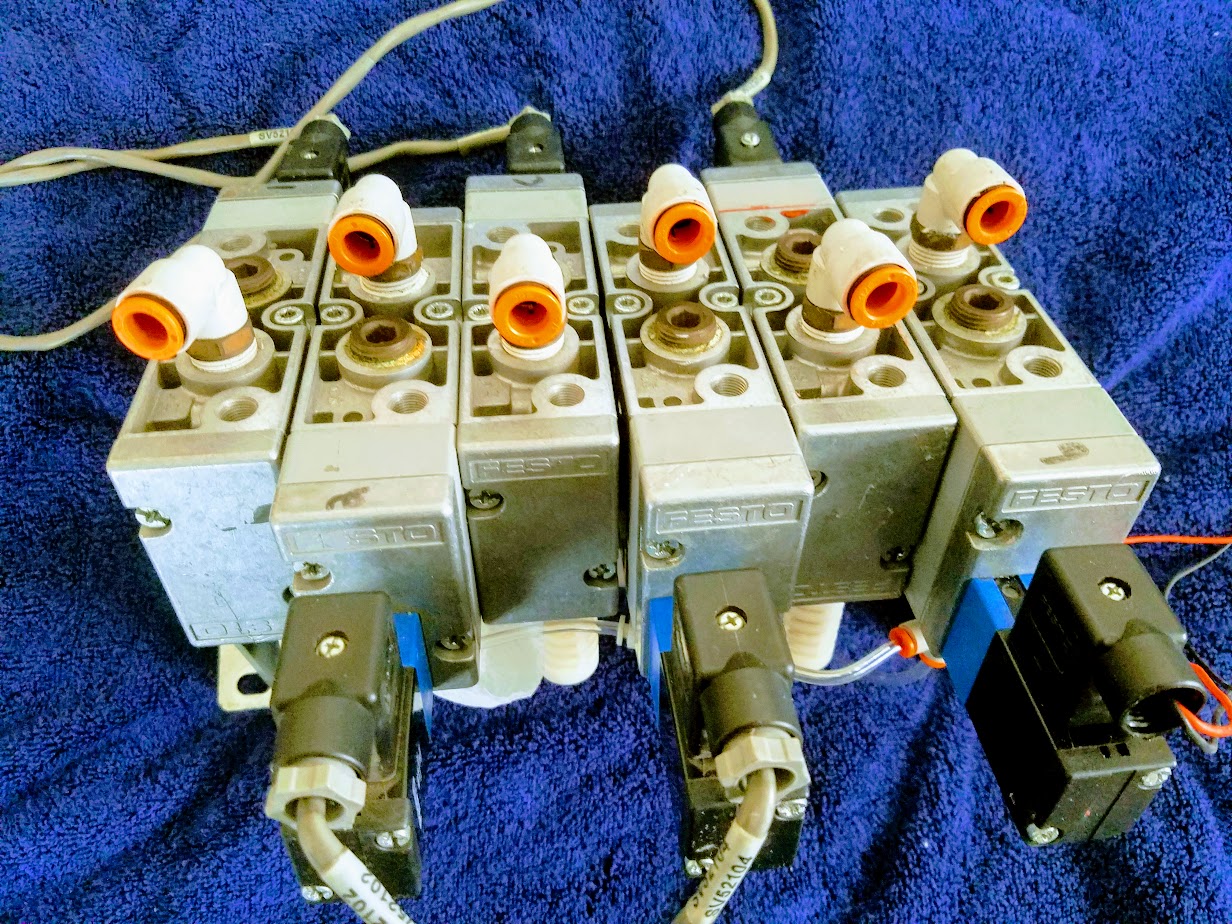

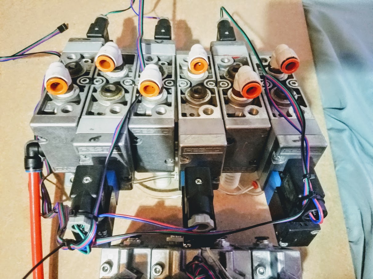

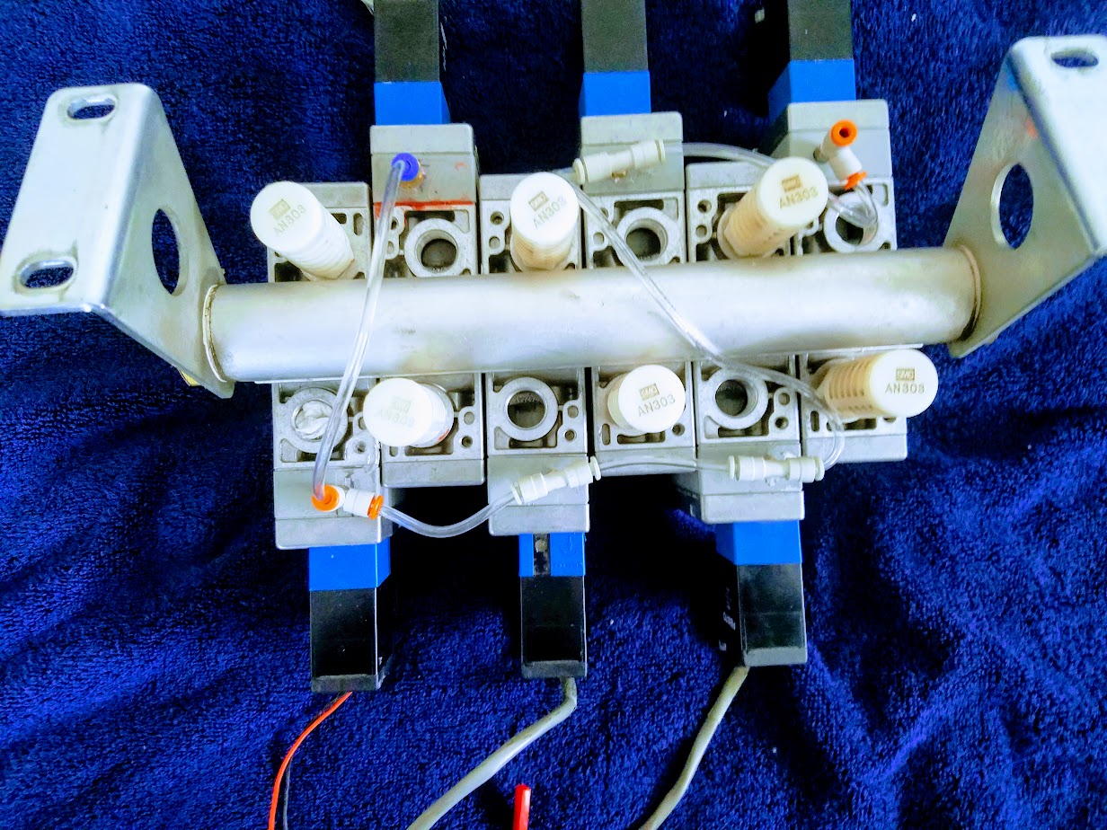

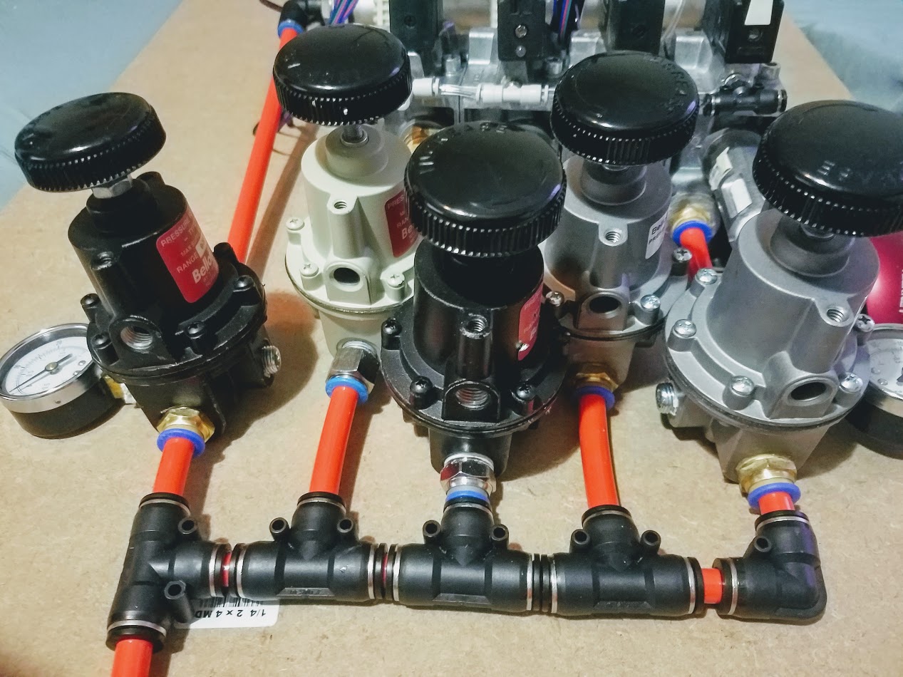

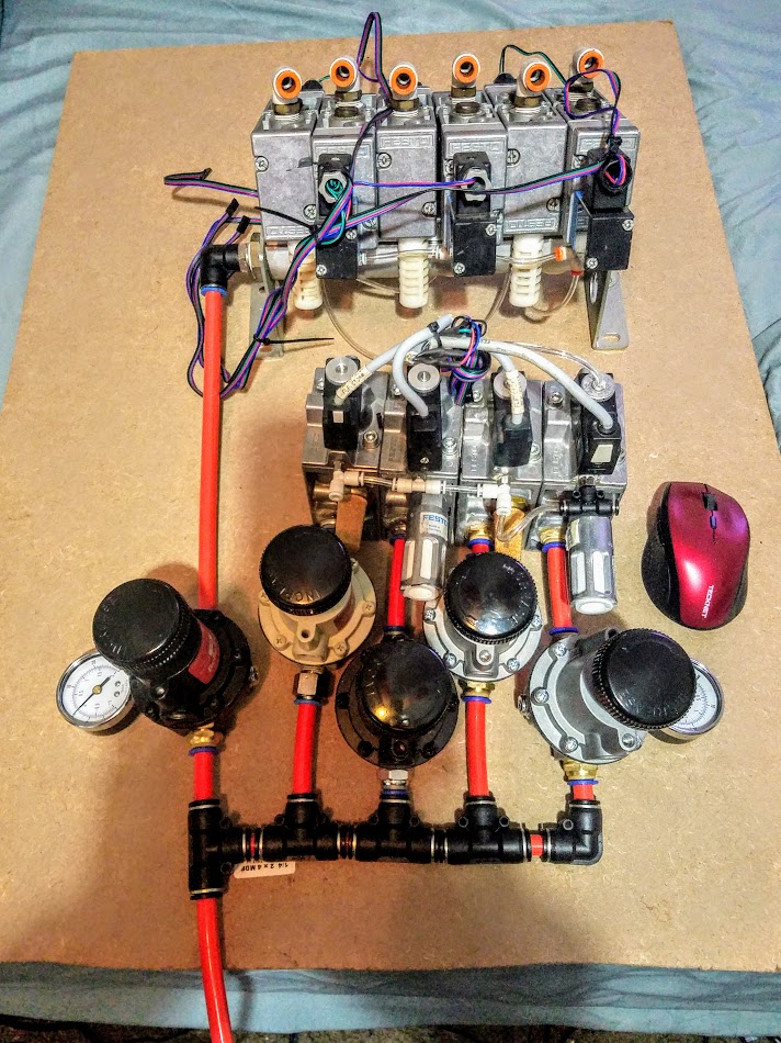

    Here are a few pics of the solenoid valve assemblies.
    As I mentioned earlier it is all about rate of airflow not pressure.

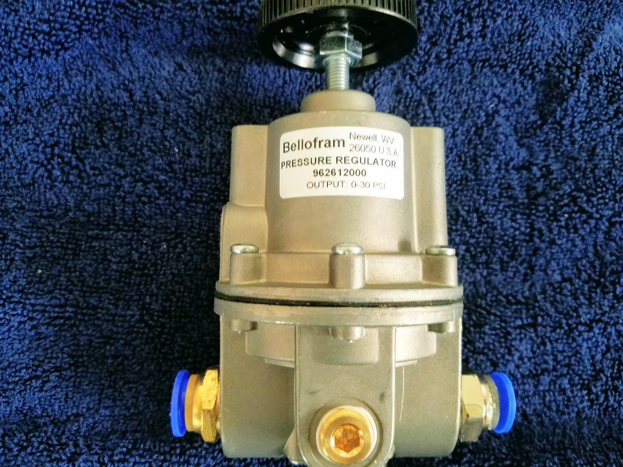

    In the front of the picture is a set of high flow pressure regulators.
    150 psi input and up to 30 psi out.
    Next is a row of 4 high flow solenoid valves.
    2 are in parallel for the heave bladders and the other 2 are in parallel for the surge bladders.
    Next are a set of 6 medium flow solenoid valves.
    1 for the right side back sway.
    1 for the right side seat sway.
    1 for the left side back sway.
    1 for the left side seat sway.
    The last 2 may end up not being used.. so they are extras....
    Most everything here was purchased off E-Bay.
    I payed about an average of $30 USD for each valve which retail for $150 each new...
    The 5 air regulators cost me about $30 each also. And they to cost over $100 new.
    It took me a while to accumulate all this junk!
