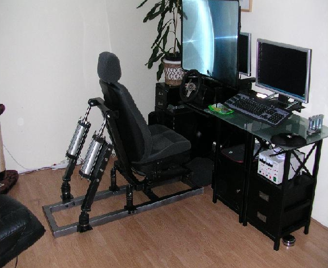

    hello all,
    Thanks for the fixed file :thbup:
    I have got a custom made frex style pneumatic chair.
    I wonder how i must wire the valves(5/3 middle closed) to the k8055 interface?
    Is there someone who have a wire sketch (frex style pneumatic) for me ?
    Thanks!

    Some documentations about te valve ,
    I want to use festo valve MEH 5/3g-18b , but i can make a spring supported sim so i can get use a valve meh 5/3b-18b or cpe18-m1h-5/3-1/4.
    I think it is better than the festo valve 5/3 middle open ,or not? for spring supported sim.
    I like the spring supported sim most because you sim is going direct to the middle postion if you get no g forces in the car.
    robert.

    Hi robert,
    nice setup!
    For pulsmode you have to use single way valves. You cannot use pulsmode with 5/3 valves. But you can have 3 speeds with 5/3 valves without pulsmode as well.
    There is not much difference between both operation modes. But the 5/3 setup is more silent I think.
    As I stated in another thread some days ago, I am concentrating myself on the electric acutators. But I think Simhawk would help you with the 5/3 setup if you asked him.
    X-Sim has some kind of washout algorithm integrated, that moves your seat slowly back to center position after a short period that can be adjusted in the software. There is no need for springs.
    Regards
    Christian
