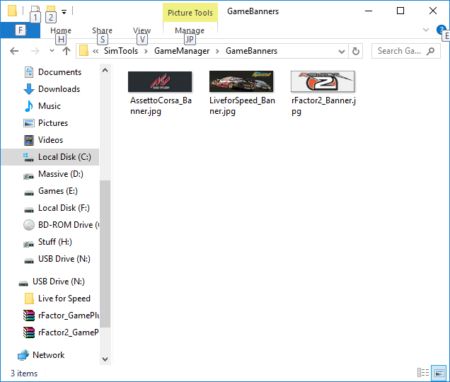

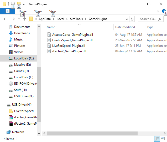

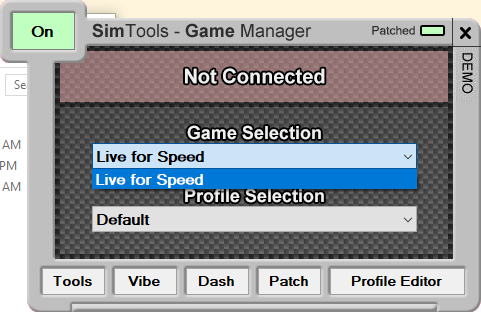

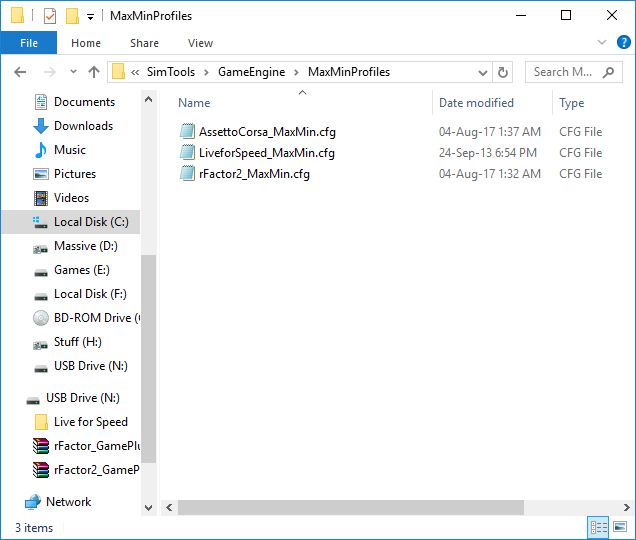

    I'm having a hard time trying to install plugins.
    The LFS-one works great, but other plugins installed with the PluginUpdater don't show up in the Game Manager.
    The files seem to be in the right places and a reboot didn't help.
    Am I missing something?
    Any help would be appreciated :)

    Hi @TimmeyNL,
    All you have to do is drop the plugins into the SimTools PluginUpdater.
    (If your by chance installing them by hand?)
    The problem is your running in Demo mode.
    (Only live for speed works in Demo mode.)
    Any license will unlock all of the Game Plugins.
    The Pro and Entertainment license will also load new Interface and Axis Assignment plugins (and all the extras addons).
    And if you qualify, you can get a free DIY license here:
    https://www.xsimulator.net/request-diy-key-simtools/
    I hope that help buddy,
  3. TimmeyNL
    TimmeyNL New Member
    Mar 18, 2017
    8
    - 55Coins
    Ah, the demo license is 'to blame'. Thanks!
