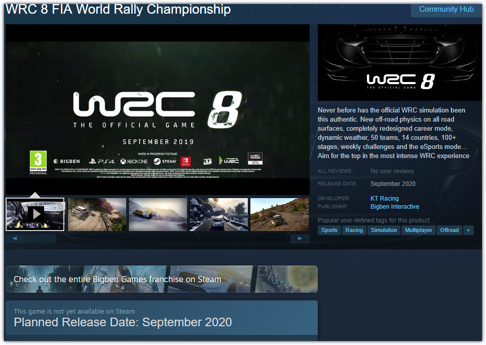

    Although the release date in the video is September 2019, it says at least twice on Steam
    September 2020.
    As September 2019 is already history and the game is not released, I must assume that the release date of Steam is right not of the video…
