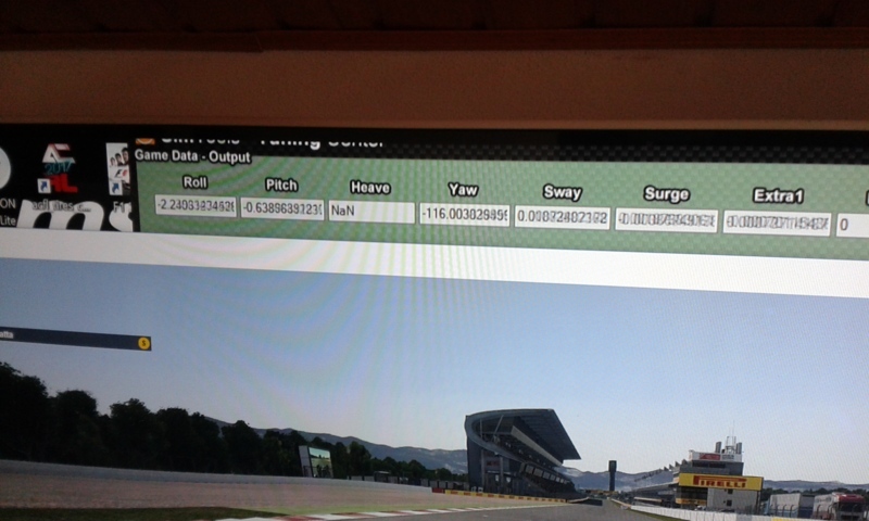

    Hi, as from attached picture when the heave function is active the sim hangs and there are no values on the heave window but an NAN

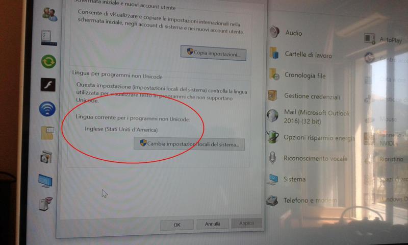

    I changed local settings from Italian to English (United States of America) restarted several times but the problem persists.
    I think the problem is the plugin because all the other games (including F1 2015) work fine.
    Pity because heave is a very important feature for sim !!! :(:(

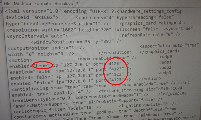

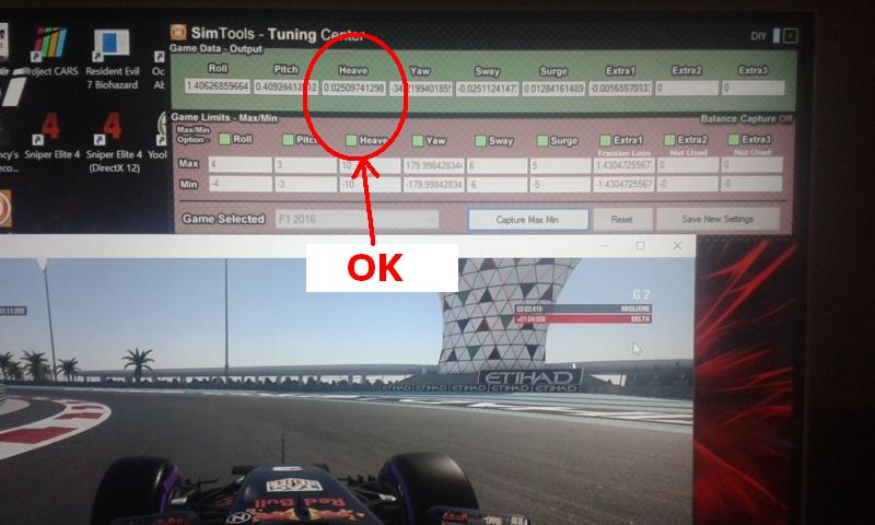

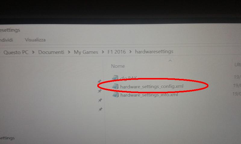

    RESOLUTION !!!!
    Thanks always for the help of this wonderful forum !!!
    As from attached photos after patching the game open the hardware configuration file config.xml and correcting the 5 values marked with the red circle the plugin works great to all its functions.
    Thanks again 20170819_193045 (FILEminimizer).jpg 20170819_193223 (FILEminimizer).jpg 20170819_192933 (FILEminimizer).jpg
