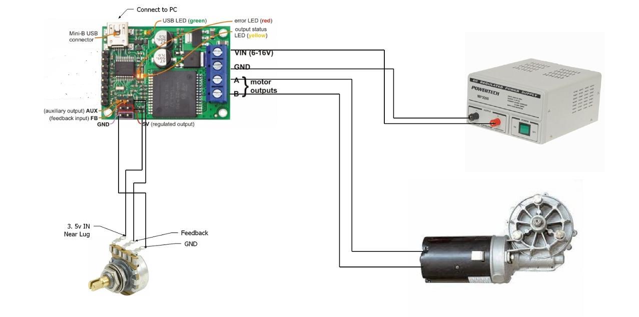

    To try and simplify it and give you a bit of an idea, here are some pics. I am using the example of a Pololu JRK 12v12 controller. Other please feel free to add pics of other controller setups.
    The first pic is a diagram of how to wire a pot, motor and power supply to a JRK device.

    on the second diagram where would the Potentiometer be mounted?
    what happens if i want to use two motors?
    you have nearly answered all my questions :D
    thank you
  13. bsft
    One pot per motor.
    The pot should be mounted near the motor. This will take some guesswork as there is no set spot. I made up a lever system from some bits of plastic and spare bolts. I connected one lever to freespin on the bolt holding the rod end on the end of the motor lever. I then got another lever and screwed it to the end of the pot shaft.Then I connected both with a small bolt.

    Yes, two boards, two usb cables, two pots , single turn 5kohm, two motors, two psu or one GRUNTY psu.
