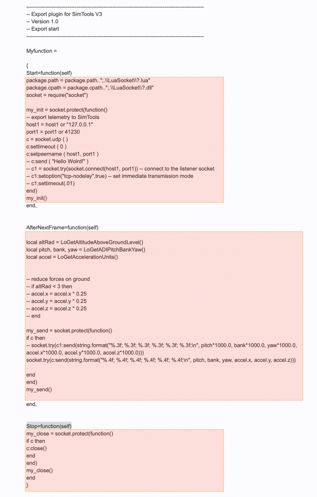

    Hello everybody
    I would need some help
    I've been using simtools for about one year now and let's say I know the basics of it.
    I am familiar with the game patching procedure via the export.lua file.
    Few months ago I bought the Simracingstudio SRS wind.
    If you are not familiar with it, it's a system that makes fans spin simulating wind.
    My goal is to have wind blowing when taxying when the canopy is open.
    This SRS wind patches DCS export.lua file similarly to simtools.
    My problem is....
    When I patch the Export.lua with simtools my motion platform works perfectly.
    When I patch the Export.lua with SRS wind app, the fans work perfectly and they react to airspeed increase as they are supposed to do.
    My problem is that when I create my export.lua that includes the code lines from simtools and SRS wind, things don't work properly.
    Here is my export.lua.
    On top there is simtools part and after that there is SRS wind part.
    On a note....
    If I put simtools lines on top nothing works, not the motion platform nor the fans.
    If I do the opposite, SRS wind on top and simtools after, the fans work but the motion platform doesn't work.
    Can anybody help?
    And sorry for my english

    I am by no means an expert on Lua, but if you simply copy those two files into one, you will run into problems unless you copy every line to the correct place and then remove redundant lines.
    Option 1:
    Use the SRS file as master and try to incorporate the content of the plugin export scrip into it. In the SRS script you have there are five functions:
    function LuaExportStart()
    function LuaExportBeforeNextFrame()
    function LuaExportAfterNextFrame()
    function LuaExportStop()
    function LuaExportActivityNextEvent(t)
    ...while in the plugin script you have only three.
    Start=function(self)
    AfterNextFrame=function(self)
    Stop=function(self)
    see here:
    Now put the content of...
    Start=function(self) --> LuaExportStart()
    --> function LuaExportAfterNextFrame()
    Stop=function(self)
    --> function LuaExportStop()
    ...and then see if there are redundant lines. With a little bit of Lua this is easy, but if you have never programmed at all before, it will be almost certain to go wrong somewhere.
    Option 2:
    @value1 changes his script so that it uses the callbacks from within the hooks folder. I'd do it myself, but I won't find the time to do that for at least another few weeks.
    Option3:
    You can use the script that I use for my plugin. It should still work with the original. I have added an option to use Eulerangles in the script for those who want to use those like in the original plugin. If you copy the script into SavedGames/DCS/Scripts/Hooks (create that folder if it does not exist yet) you will get all the functionality without interfering with other scripts. In fact this scenario was exactly the reason I started using the Hooks folder for my own plugin.
    This is the script:
