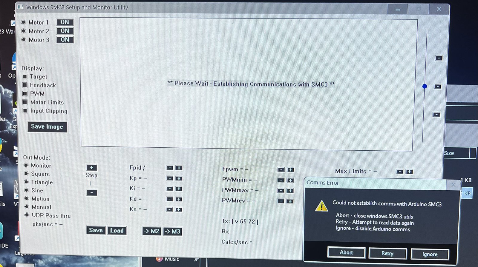

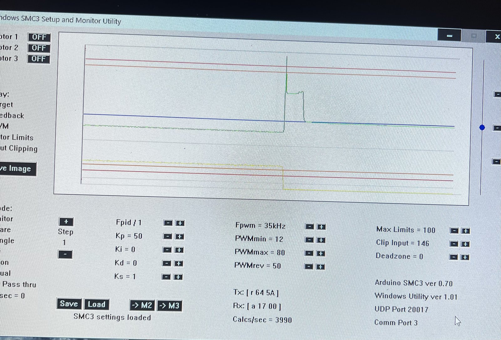

    I’ve got a 1000w 24v 42a PSU, a generic wiper motor, arduino uno, and a BTS7960. With psu powered off, I open up SMC3Utils. it connects to the Arduino fine, and I get data in the smc3 window. Then power on psu, and still everything works, the motor moves, follows the potentiometer, reverses, ect.
    now the problem is, when I try to connect to SMC3Utils with the psu powered on. It won’t connect and forces me to abort, retry, or ignore. Am I going to have to power up the arduino and connect to SMC3Utils before turning on the psu everytime? Or am I making a simple mistake?

    Can you please post pictures of all settings and any error messages.
    I am just checking, is the wiper motor 24v?

    The motor voltage may be a separate matter, but the error message looks to be Coms related, unfortunately the error message is covering the SMC3 Com port display.
    Presuming coms may be an issue, have you tries a different USB port and USB cable? Keep in mind that different USB ports may be connected to the same USB controllers, so you may need to map what is connected where: https://xsimulator.net/community/faq/simtools-usb-issues-can-cause-crashes.313/
    Also check for wiring that may be inducing electrical interference. Clip on Ferrite magnets are helpful.

    got it! must be a bad PCIe board on my PC. the MB usb's are working fine. thank you so much for the help! another question, any way i can change my account name? or am i stuck forever? lmao
