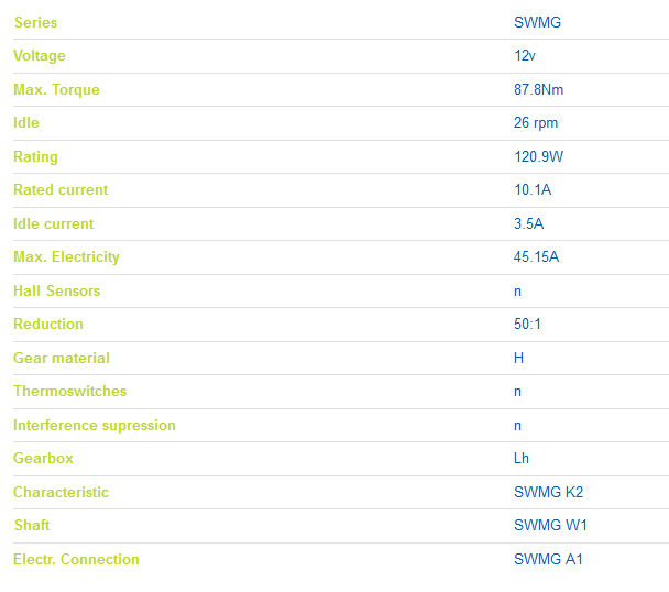

    I'm currently building my flight rig based on the Roman Design Project and still need the appropriate motors. While I am about to order the motors from PGSAW ( https://www.ebay.de/itm/354052076387 )
    , I have now found the following motors for which I would not have to pay 150 euros for shipping. Can you please tell me how important rotation speed is? I believe that in terms of gear ratio and torque, these engines are very suitable for the project. I'm just unsure if the speed is enough.

    I am a bit skeptical of the 87.8n from 120.9W, do you have further information and a link.

    What makes you so skeptical?
    How do you estimate the idle speed? Would this be enough or is the motor too slow?
    21,511
    150,686Coins
    +11,018 / 55 / -2
    I am skeptical in terms of the motors only being 1300 rpm, based on 50:1 and 26rpm output, driven by 120.9W.
    Compare that to the PGSAW motor specs. Or these from Motion Dynamics: https://www.motiondynamics.com.au/worm-drive-motor-12v-24v-200w-180-rpm-20nm-torque.html
    I would expect the 120.9W motors to put out around 10nm torque, the 87.8nm just does not seem likely.

    Ok, thanks for your support. So now I buy the motors from pgsaw. The shipping costs are outrageously high, but I also want to have motors that serve their purpose.
