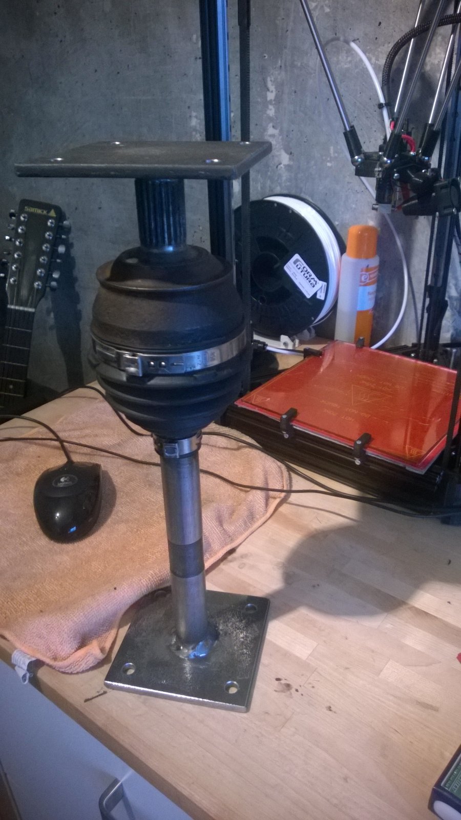

    Finally, I've got back the pivot. Welded good only a bit of small plates, guess we had a miscommunication :)
    Luckily I have 2 more counter plates so I can sandwich the wooden plate between the 2 steel plates.. and it gets support from the mounted rods underneath.. So I guess I'll be fine!!
    So here is the pivot and my base set playseat with G27 steering/shifter and pedals..

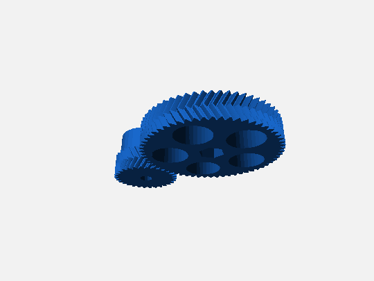

    I think that if I use herringbone gears I can eliminate backlash..
    I use these type of gears on my extruder for my printer...
    Something like this..
    this type of gears is almost without backlash, well actually on my extruders none..

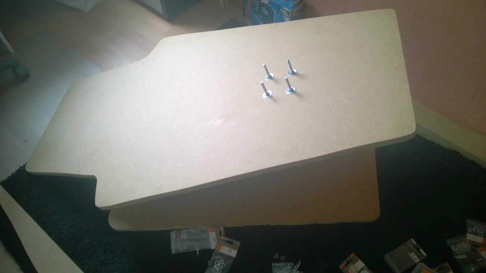

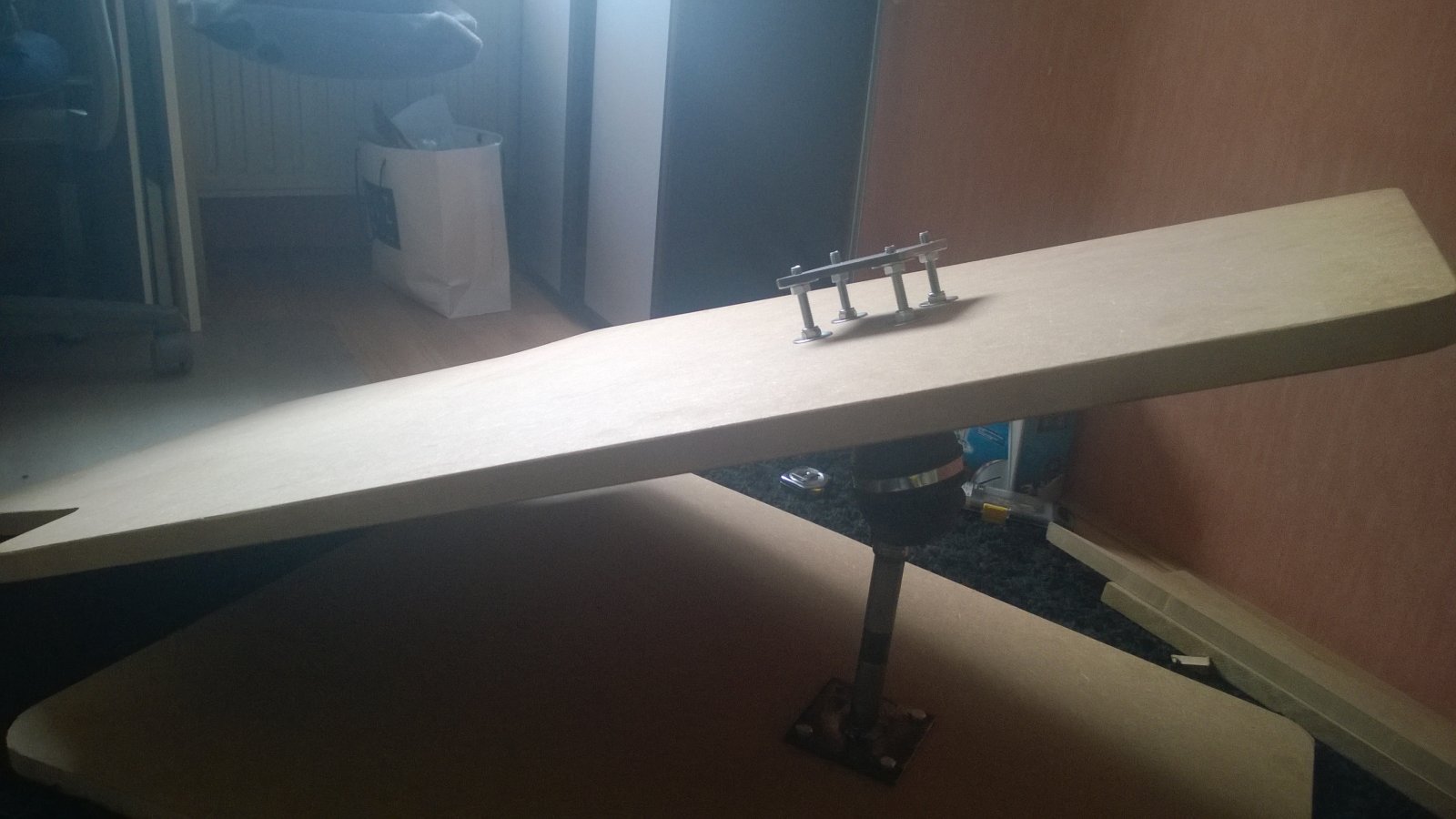

    Today I started mounting the pivot and Motor brackets.. So tomorrow I can mount the motors to the boards..
    Then the 'hard' building stuff should be done and the 'tinkering' and electronics side starts..
    13803604745_f8d730e4c8_o.jpg Longer bolts so I can sandwich the Playseat main frame beam ..
    I will drill holes through the frame and bolt the frame to the board to get the structure rigid..
    13803945014_8096881c82_o.jpg The idea..
    Actually the whole idea is to use whatever I can find at the hardware store as I have no powertools at hand.. just using drill, hamer, saw and wrenches :) And I have fun already! Quite curious where this leads to :) Failure or success.. Just worried about my lever connection but I can ask somebody to make me one proper..

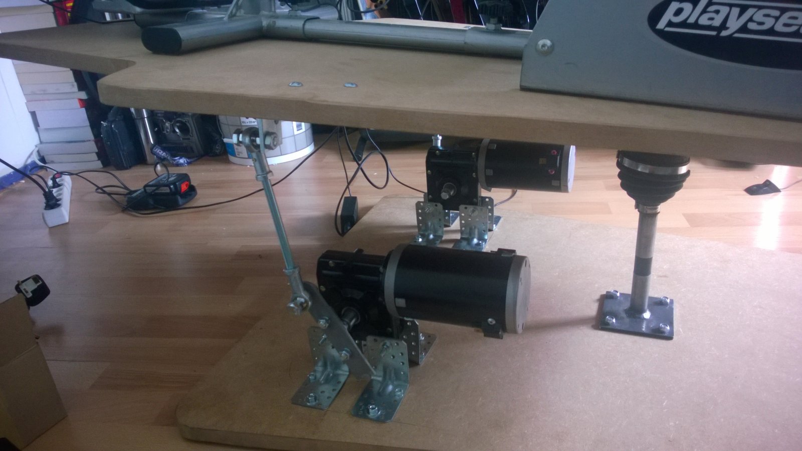

    Motors are in the front.. Good to see, that I am not alone in doing builds under equipped:)
    I saw so many tools at the hardware store that I could use right now, but probably would never use again!

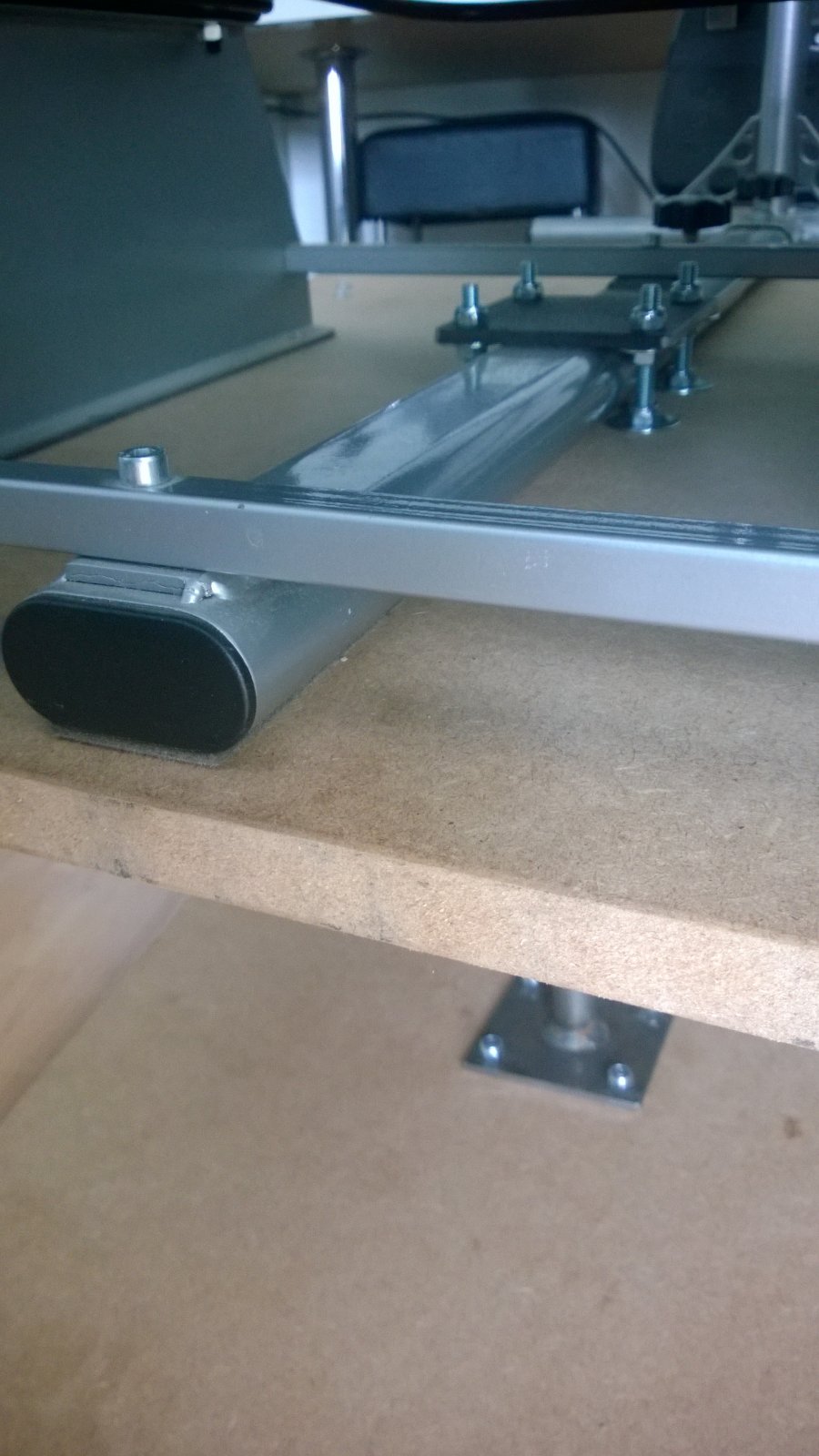

    This is where I got now. Realizing it is a bit high, but for now.. better too high then too low.. I rather reuse the parts and cut them instead of having to search for new..

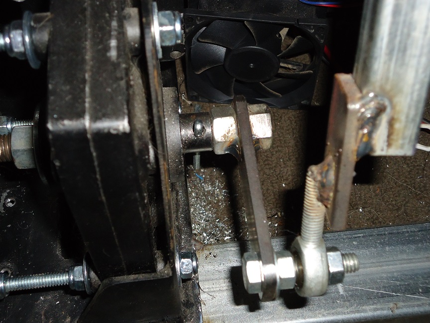

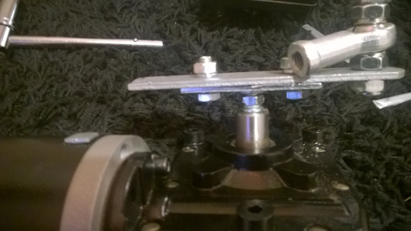

    only problem I have is the mount of the lever with the motor axel.. It is threaded M6 so I got the bolt in .. but I guess I need to drill a hole through and through to put a split pen in? Am I correct?!?!
    13820047034_4573553d9b_o.jpg Should I drill a hole through for a split pen .. Wise or not!!!!
    13820057674_31b91bb8cb_o.jpg Up high..
    13819894223_3d1a4c46d7_o.jpg playseat mounted sharing bolts with the pivot
    So the raw build is nearing completion.. but not all happy as I found 5mm of rotational play in the pivot, that I didn't notice before, but now the extra weight shows it.. But I'll finish this so I rebuild with lessons learned during this progress..

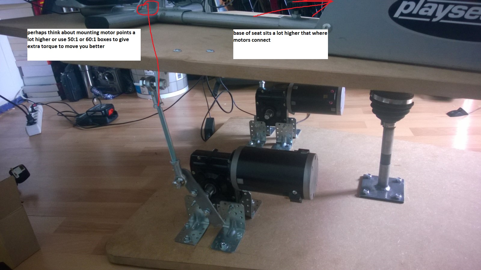

  8. bsft
    Looks good man. Yes its part of learning.
    I think it may struggle a bit with motors connecting that low and I know from experience. Erwan is using 50:1 boxes to give more torque to overcome a lower mounting position. You may need to do the same or mount motors to connect a lot higher on the frame.
    with the motor shaft through the motor, tighten the crap out of the bolt , then toss a 5mm grub screw through the motor housing tube and the motor bolt to hold it tight as well.
    5mm of play in a cv shaft is normal, hence why we use uni joints. Make up some drag links to hold the frame steady to overcome this.

    Ok. This is much better.. I managed to drill a hole and tab it for M5.. No it is tight!!!!
    I don't understand drag link?? can you explain this more.. probably something lost in translation here :)

  14. bsft
    Yep, pivot right up under the seat will help for sure.

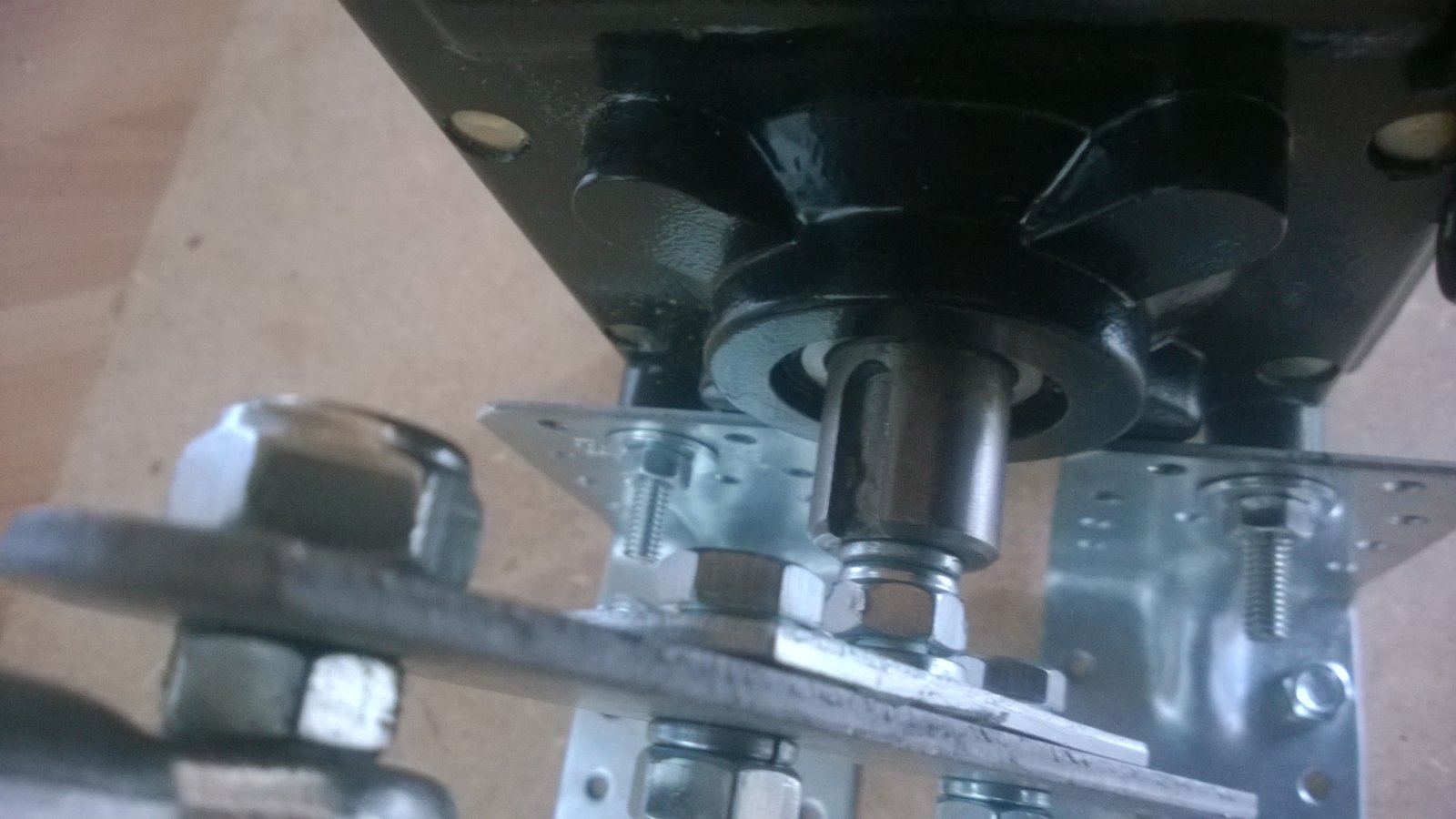

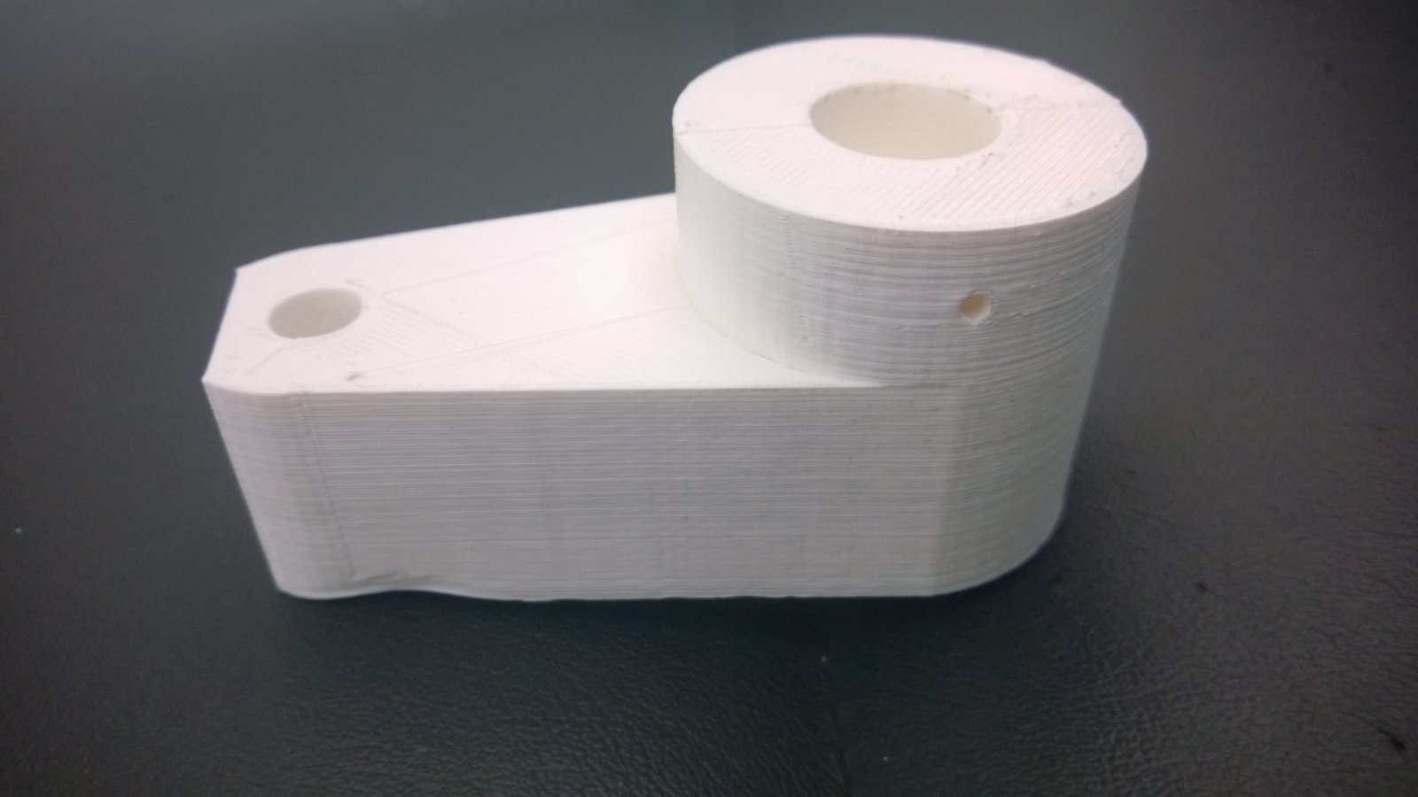

    Ok done the conversion and the pivot is up higher.. feels a lot lighter to move by hand with a person on top.. So I guess the balance is still ok .
    Next up is to shorten the lever rods..

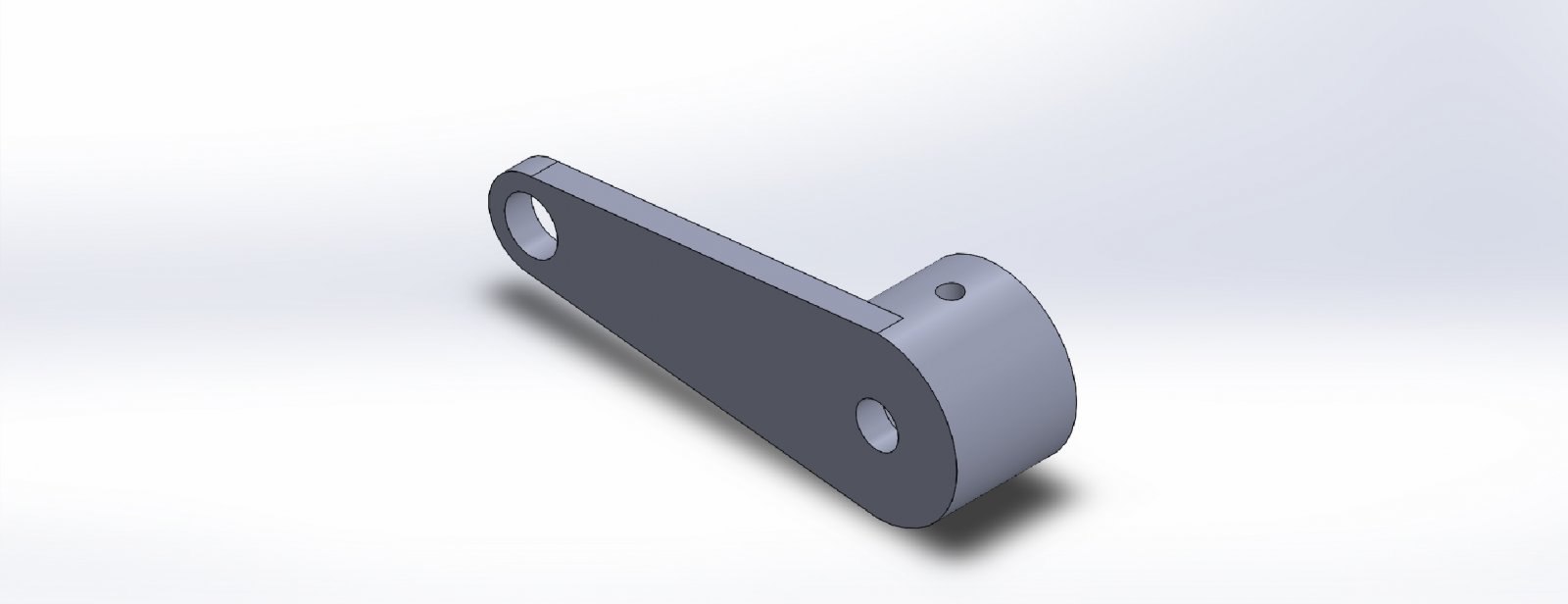

    I decided that the lever arms are to fragile so I made a drawing to let somebody build/weld it for me..
    As my shaft has a slid in it I can have this type of construction on it.. The part goes around the shaft .. bolt a M8 through the part into the axle and have a M5 bolt from above into the slide of axle..
    Should be impossible to move this part ..
    This will take me of the project for about a week but after printing this part in plastic, just to test fit and hand it off as an example to be build.
    I decided I would go for temporary solution so I can get my rig started.. I printed me some beefier version :) and damn.. that part is heavy and solid!!!!
    I guess I will try it on and start the build of the electronics part!!!
    Will post a picture later..
    For now I decide to have the pot direct mounted to the shaft instead of gearing.. But will eventually go for gearing as I want the full range of the pot.. but first I need to now how much I need in gearratio..
    So first I print me 2 of these..

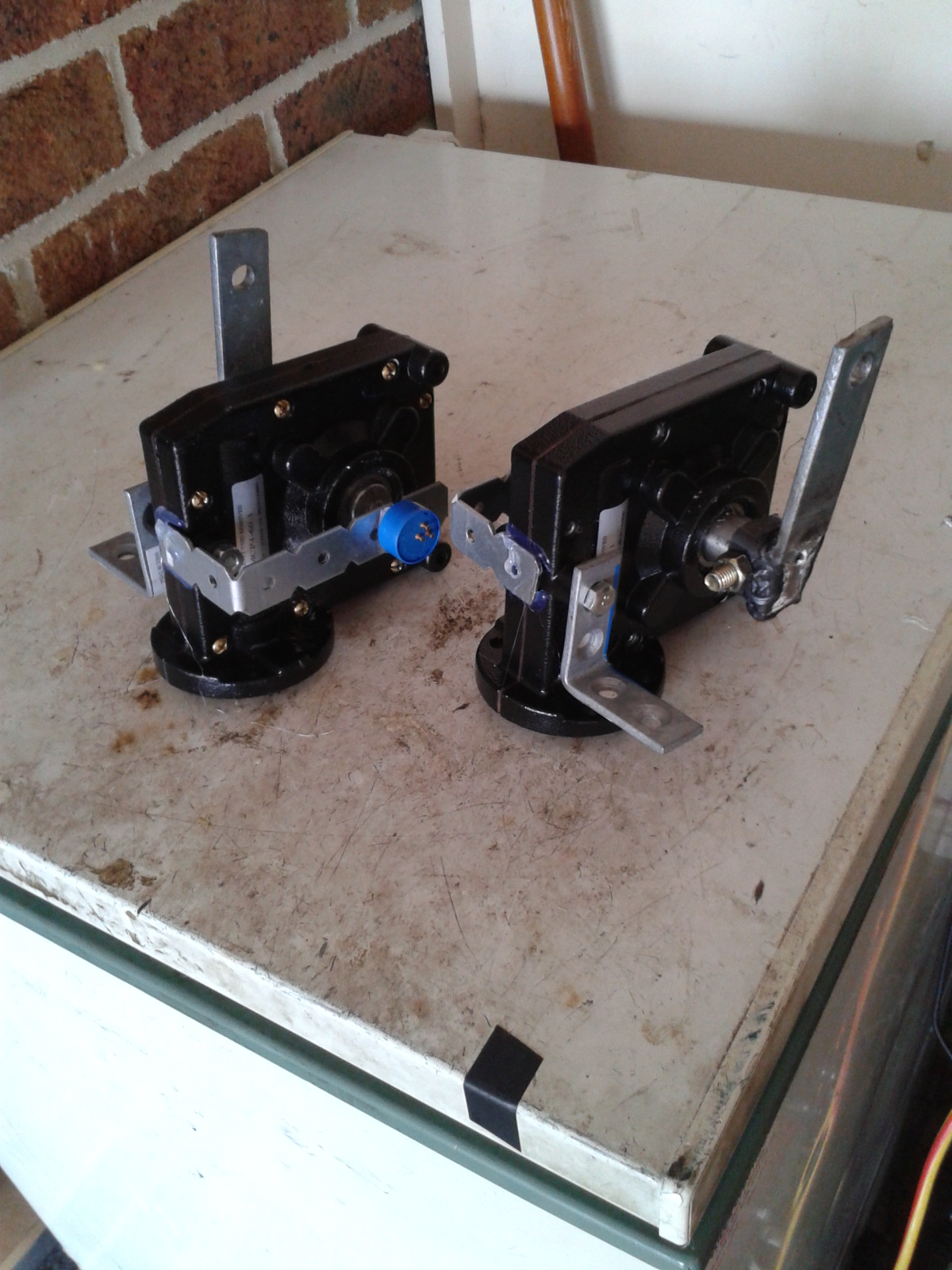

  16. bsft
    I did something like that of which you are proposing on a set of 50:1 boxes with solid shafts as well. I found a bit of steel box that would fit sort of snug on the shaft, welded a lever on it, and yes, drilled through both to run a m8 bolt through it and a 5mm bolt on one end to steady it.
    So you are on the right track.

    Just a though, I know you have a 3d printer, but a short piece of plastic pipe and maybe a thin bit of board would get the same idea, in less time done as well.
  19. Michael Hensen
    Michael Hensen Active Member
    Mar 25, 2014
    166
    C# Software Engineer
    Almere, Netherlands
    748Coins
    +186 / 0 / -0

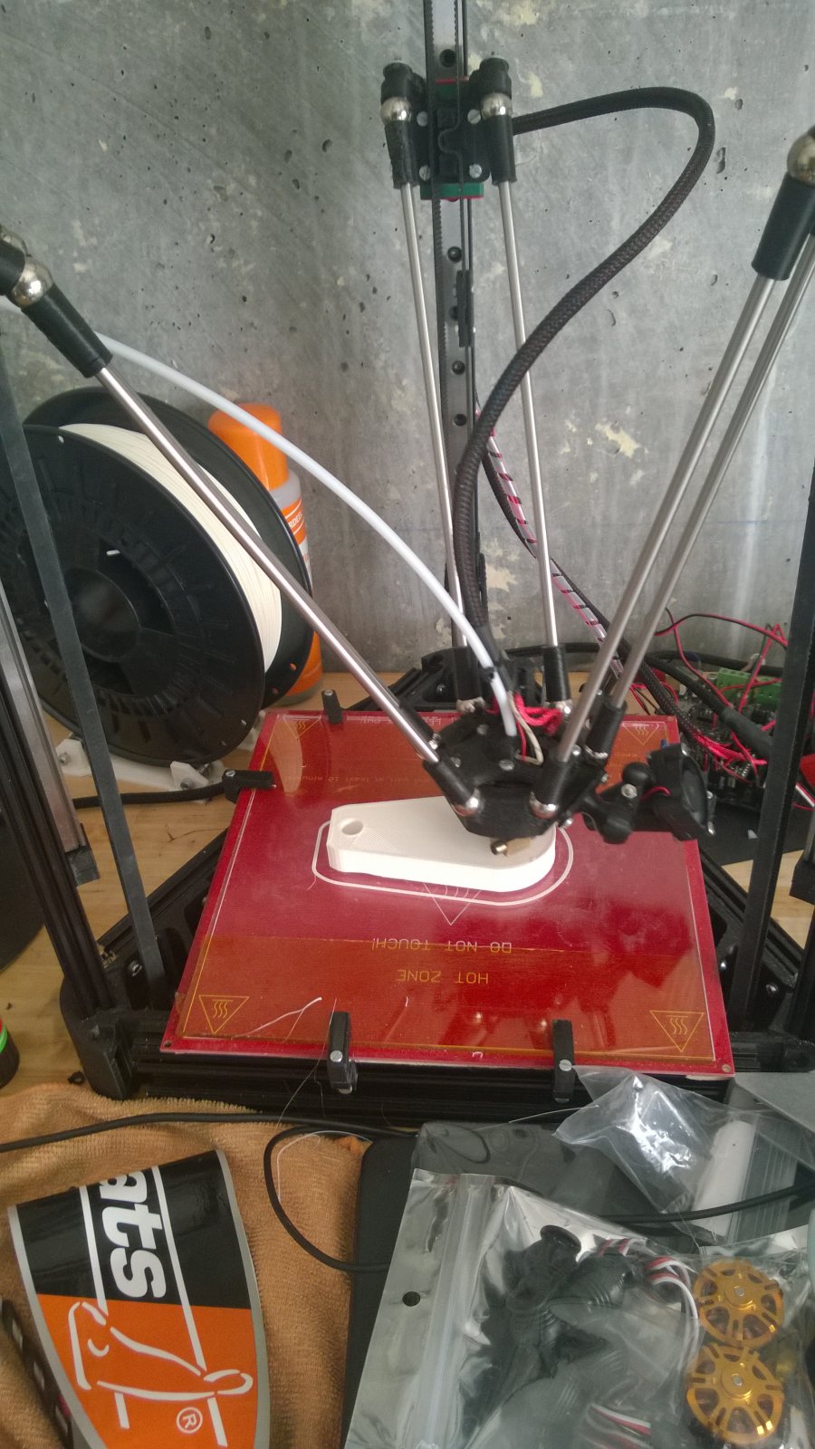

    I am printing already a real beefy version of it.. even too much .. but for now ok I think!!
    as all torque comes together here I guess it needs to be massive in plastic :)
    It just takes 4 hours per piece :) lol
  20. eaorobbie
    20,503Coins
    +1,687 / 23 / -2
    Wicked , can I have your printer, very very handy.

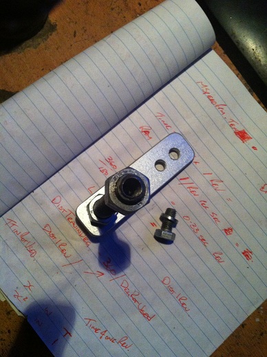

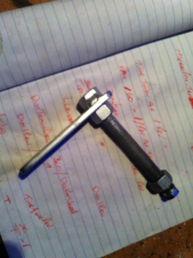

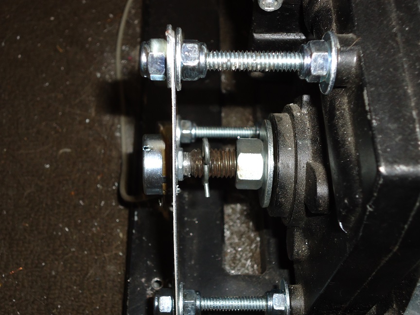

    Like your idea of connecting with the blue bit, should allow a little flex, any radial strain on the pot shaft will shorten its life.
    As for levers I use this.
    A bit of 25x5mm flat bar.
    Bolt in the end is used to mount a gear or pulley on. At present using different ones with pots connected directly to shaft.
