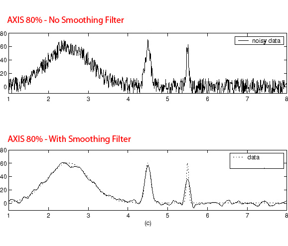

    @Archie
    The picture says 1000 words :)
    I believe the smoothing filter works like this:
    It doesn't affect the Axis range like @yobuddy explained, but will affect / smooth out the spikes and this would also affect the range of the effect itself (sway, surge etc) - making you think that Axis range was changed - but actually it wasn't, it was the range of effect that was changed.
    If you take a look at the big spike in the center of the first image (noisy data), you would see that it reaches a point around 70% of the axis, but on the second image with smoothing applied - the same spike is ranged at point somewhat below 60% of axis because of the smoothing, making a difference of about 10% in the range. The second big spike has even bigger range impact because of smoothing. So it's not your fault thinking Axis was changed, you were 'tricked' into it..
    And if you take a look, smoothing will also make you lose motion details and make your motion smoother but that could also feel slower in movement / response if you apply too much of it. Just imagine turning your car into a boat on waves ;)

    How much smoothing filter was applied in that example?
  12. prodigy
    prodigy Burning revs
    Oct 27, 2013
    459
    Croatia
    6,698Coins
    +399 / 4 / -0
    @Blame73
    Actually, the above graphs are not representing actual force from Simtools, I've found those graphs on google from some other test but edited them a bit with some info. Actual motion graphs would be a little different, with positive and negative values etc.
    But the point was only to show how can smoothing affect the motion line. From the test pic above, I would say 15-20% smoothing was added..

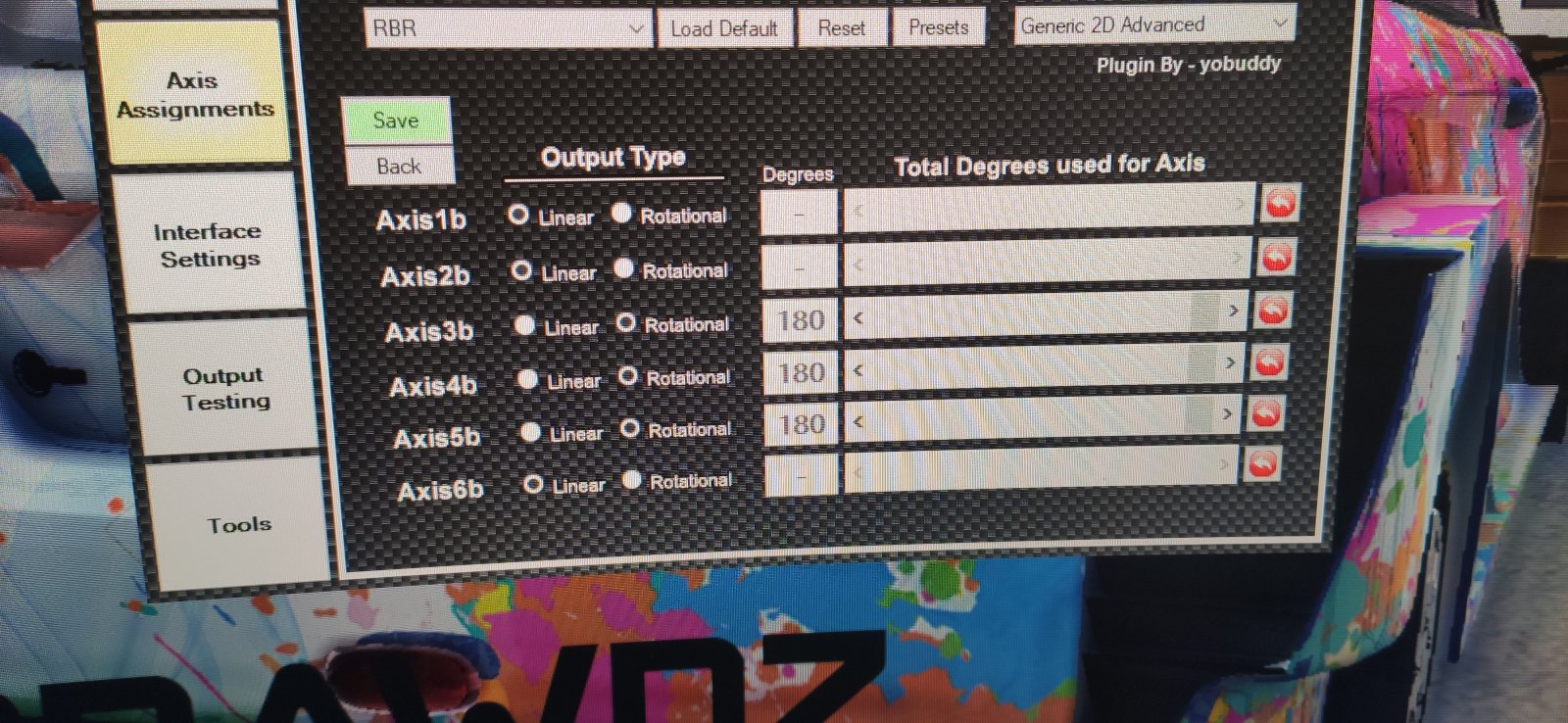

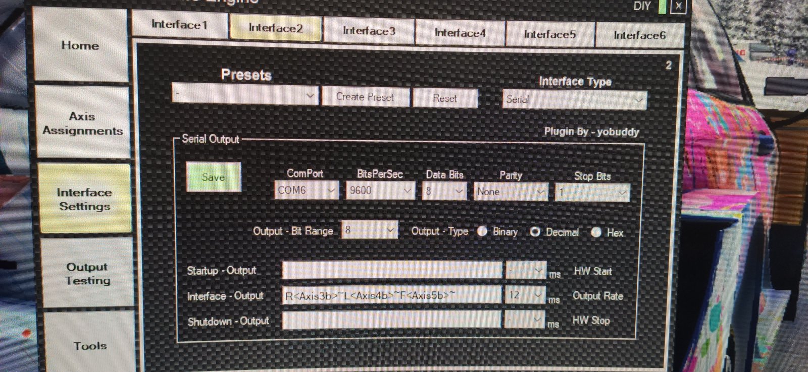

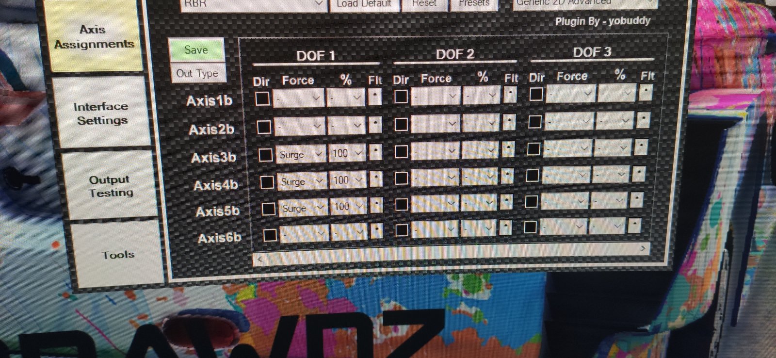

    I have a problem with the Surge Axis alignment in Richard burns rally rbr game. I set this in dirt rally and assetto without any problems, but in rbr I need to find a compromise, I have to set the washout filter. By a well-set axis, I mean such a setting that when I add gas on 1 gear, it gets a kick and the strongest deflection occurs, then 2nd gear is the same, only lighter and so on to 5.6 gears. If it adds gas, it deflects if it inhibits the return. When it comes to rbr, when I hit 1, it is in this state, if it brakes, it also comes back nicely. If I wait to cut off and punch 2, 3, and on, do the same. The problem arises when I do not wait to be cut off, I only stick in earlier. Although the car has turbo and there should be an impact, it does not occur or it occurs randomly with a delay. I caught the values of max min. I tested different values. As it writes in every other where I set it up. Does anyone have any advice on how to set this up? I have the impression that the problem is that after tilting the axis there is no room for tilting again? Maybe someone has experience in rbr. Maybe the profile was made for a different physics and the present ngp has a problem with it? Please help. I love this game
  17. noorbeast
    21,487
    150,542Coins
    +11,017 / 55 / -2
    Please post pictures of your Axis Assignments and Tuning Center.

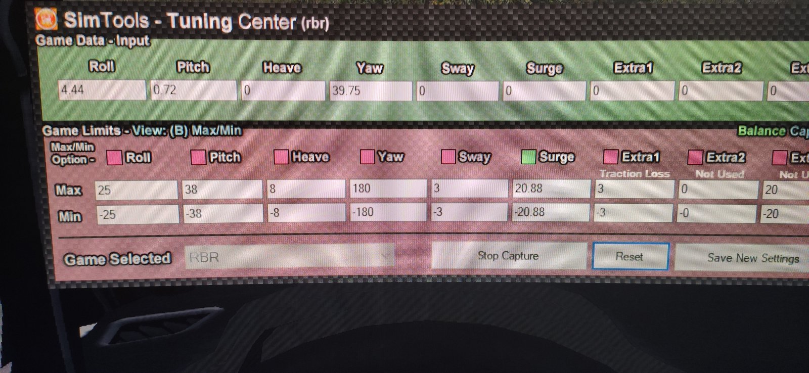

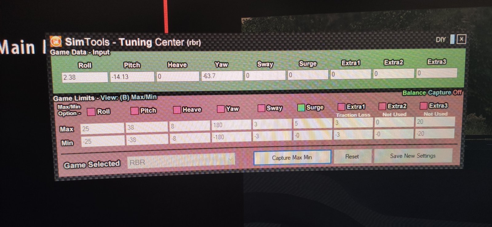

  18. Krzysztof Dej
    Krzysztof Dej Active Member
    Jun 3, 2020
    314
    Poland
    1,104Coins
    +73 / 0 / -0
    When I capture max min it's about 20 and I feel ok (when I press throttle it's working fast and strong on 1st gear, 2nd slower and less quicker and... 3rd also less. When I save settings and press stop capture ist ridiculous becouse it's like 20 % those forces!! I don't know why. Those settings is without any filters like on screens settings. When I'm lowering the max min settings to 10, 5 it's starting working again but it's not good for me becouse I want on gseat surge force for the car about 300 hp to kick me on back not like that. I try with different car from 200 hp to 400 and it's feel the same on 1st 2nd gear its OK. On throttle from low speed feel fine but the other gears and constantly increasing speed from 3rd gear there is signal from put the gear but when I'm reaching max rpm for me I'm finding quite OK when I'm apply washout about 80 %. Output testing feel much stronger on game engine. I'm putting all 100 % axis assignments and not feel this at all like 100
