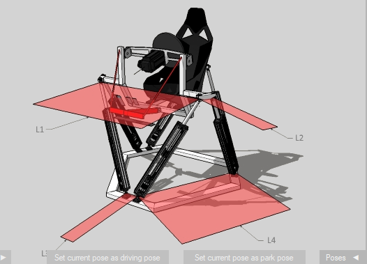

    Hi all I haven't been around for a while. I've been busy accumulating parts for my next build. which I am going to be posting a build thread here in just a moment, soon as I get all my parts together so I can take some valid pictures, but I do have a quick question. You know the three arms that come off of a platform when you're building an actuator build for 6dof?, you got one arm in the back behind you and then two in the front. Do all three of those angles have to be the same or can the two in the front be a little different than the one in the back? you know the angle that they come off of the platform to meet the actuators, do they have to be the same as the one in the back?

    if you're using flypt, there really isnt an option to have the angles different, the calculations assume 120 degree separation for everything

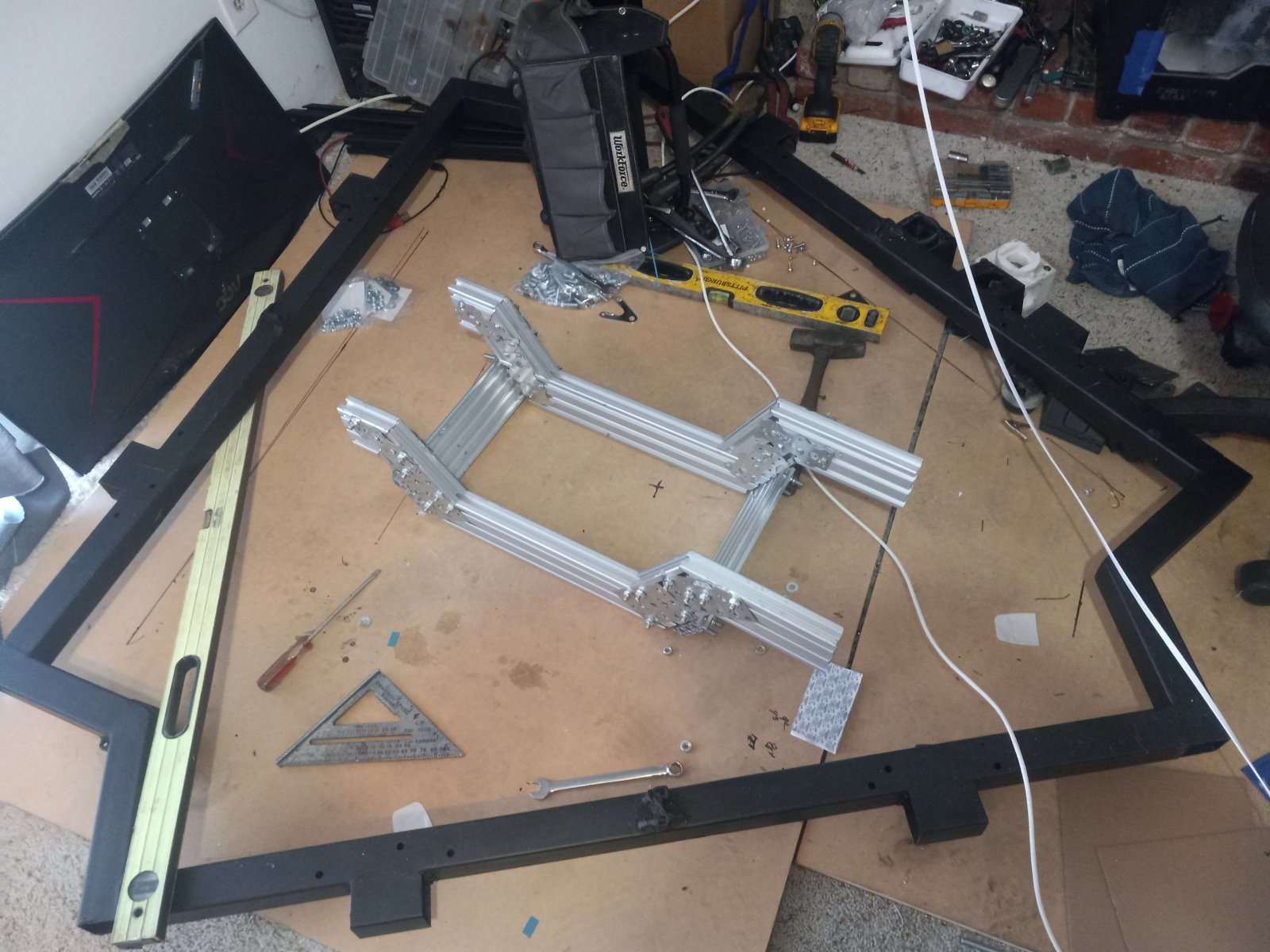

    Thank you what if my actuators can't be that close together on the base because my base is built differently than that. Where did u get this model from

    That's just the example rig setup picture in FlyPT Mover
