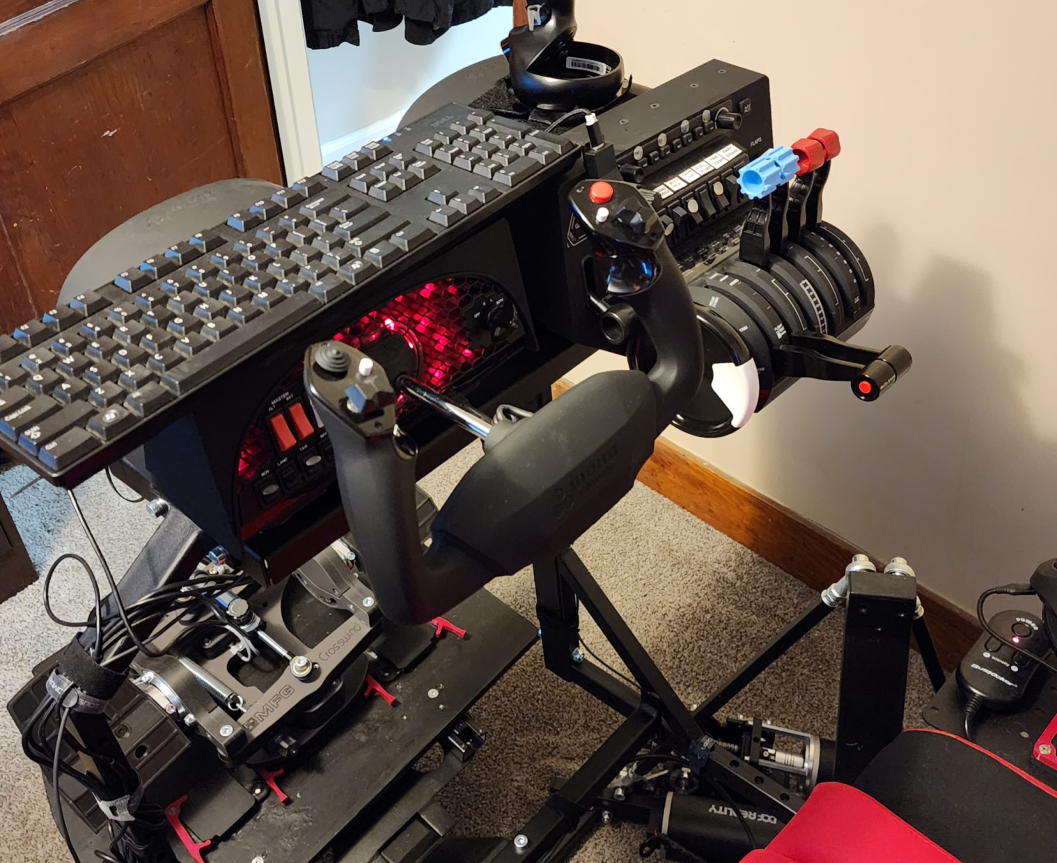

    Im looking for a prefab solution to my h6 setup with a motion controller and buttkicker (either a crystal removable adapter or maybe if a g2 controller can work?), my current solution "works", but if you move the throttle levers much it causes a shake for obvious reasons.
    I couldnt put the controller on the side of the frame because it gets blocked by legs/keyboard etc..
    If there was a 3d print of something removable that worked better with better absorption, that would work as well.. anyone have anything or thoughts?
    edit: my photos arent showing up, i have the controller upside down velcroed to the throttle quadrant on the right front.
    [​IMG][​IMG]
    It has to stay central to be picked up from the headset, i guess maybe i need an antivibration solution on the quadrant but yet easily removable , or permanently mount a g2 controller if that works with the pimax in openxr with msfs?

    I can't help with a 3D adapter, but my advice would be to set up the H6 to have its motion controlled via FlyPT Mover so that you can use the FlyPT virtual tracker for motion compensation. This will save any issues with losing tracking due to vibrations.
    Alternatively, I know some people have had some success with thick rubber washers such as the ones you can get for the feet of a washing machine.

    I use srs to do movement, is this virtual tracker something special with flypt?

    As far as I am aware, SRS requires the Witmotion module to help track your rig's position, whereas FlyPt can be configured to know where the rig is based on the measurements used to set the rig up in the software. It is more complex software to set up than SRS, but is also much more configurable.
