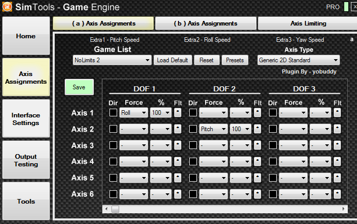

    OK guys and gals here's my delima
    My RollerCoaster is setup to endlessly flip 360 Pitch and 360 roll.
    So far Roll works perfect, my simtools on a roll will go from 0 to 127 then JUMP(flip) to -127 then follow through back to 0 to finish the roll.
    PITCH WILL NOT! WHY????
    The Problem I'm seeing is shown in this video
    https://www.facebook.com/charles.w.hein/videos/vb.1060536994/10212509911717052/
    Notice the Roll jumps from one end of the slider to the other to finish the roll, now watch Pitch on a loop de loop... it wants to reverse direction? I dont know how to fix this!

    Short story, Yes I have tweaked the values but i think its before the limitations of max and min ...
    Long Story after digging into everything I went to the bare naked basics... No Limits 2 is being interpreted (I believe) Wrong ... Now it may be a bug on no limits 2 side causing this issue but heres what i gather

    HERE's the output for Loop de loop
    Pitch Axis (Loop)
    127 127 127 127 127 127 //Level
    127 120 127 127 127 127
    127 100 127 127 127 127
    127 90 127 127 127 127
    127 70 127 127 127 127
    127 40 127 127 127 127
    127 30 127 127 127 127
    127 10 127 127 127 127
    127 0 127 127 127 127 //Peak
    127 0 127 127 127 127 // Still Upside Down
    127 0 127 127 127 127 //Should have Rolled over to 255
    127 0 127 127 127 127 // Still upside down
    127 10 127 127 127 127 // But instead values Reverse
    127 80 127 127 127 127
    127 127 127 127 127 127 // Rapidly
    127 200 127 127 127 127
    127 255 127 127 127 127 //To catch the over side of the loop
    127 240 127 127 127 127
    127 230 127 127 127 127 // Then FINALLY
    127 210 127 127 127 127
    127 180 127 127 127 127 // Follows through
    127 150 127 127 127 127
    127 127 127 127 127 127 // To Level
    Again I can not explain WHY but it's either a bug in no limits 2, the plugin, or just not capable of doing it (idk why tho)

    The output of NL2 is normal. You must look at it from the perspective of world coordinates. When doing a roll the direction of travel stays the same so the output is what flips. When you do a loop over the top or bottom the direction of travel is what flips therefore the output only reverses. You will need a custom plugin that accounts for this for your rig to operate as you wish.
