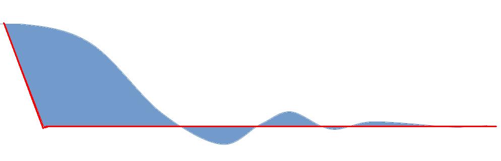

    I'm trying to implement a pid controller in my microcontroller. Everything seems to work fine so far. I've managed to get the control working with a simple P-control so far. My question is about the I-factor in the control.
    In the tutorial made by thanos he states that I-factor should be calculated as following
    ' Calculate integral term.
    error(Accumulator) = error(Accumulator) + error(Current)
    i = Ki * error(Accumulator)
    and the output then as following
    'Calculate output.
    drive = p + i + d
    But why the i-factor should include all the history data of the tuning. See the enclosed photo (very simple paint-powered picture to give an idea). If the set point goes as the red line in the photo and the measured value follows as the blue line. The blue area is the integrated i-error i.e sum-error. Doesn't that, in this case, mean that the integral-factor will never go to zero.

    I didn't quite understand your answer. How is this ”working with zero values” related to integrating the error? I calculate the output with both positive and negative values and I output to DC-driver the modulo of the output (limited to max pwm 100% duty value) and the direction to a different pins.
    Furthermore I was lying about the status of my controller. I didn’t get the integral term into a output because of a typo in the code. ;P Now when I’ve corrected the typo the integral-term makes the control quite unstable if Ki > 0.2. (approx) And this is only with a minimal load. With the more realistic load I guess the steady state error will be more crucial and the control-loop will be more unstable due the inertia.
    So I think the calculation algorithm of integral-term is somehow a bit bad or I’ve implemented it incorrectly.

    That's what I wanted to point... You don't need to work with fraction values! instead of 0.2 you could multiply it to get a 200 value for example and also multiply by same number (this is called offset) the rest of the terms in equation. Then you can just scale back the result to your needs.
    This will make your calculations produce much smooth results instead of having the mC round the fraction values to the nearest integer.
