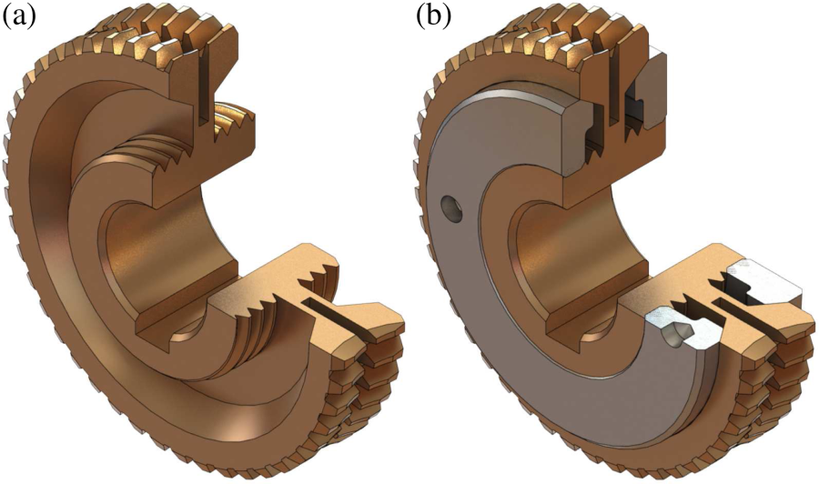

    I'm trying to figure out a 3D printed surround for the pgsaw motor to isolate the clickity clacking. I'm thinking of a simple layering of ABS and rubber would at least be able to cut the noise in half if done well.
    This does nothing for backlash physically, but if you wanted to do that, the large spur gear needs to be replaced with a split spur gear. I would assume this modification would have a great deal of extra friction and as such the additional mechanical loss may not be worth it but I wouldn't know. I would also guess a split gear would be very high wearing to the worm gear in setups like ours. If someone has experience and the right mill it would be worth it but if not a DIY endeavour a machine shop would likely charge more per hour than the pgsaw motor costs in the first place.
    If I make a silencer that works I'll post a thread.

  19. adgun
    adgun Active Member
    Jan 28, 2008
    532
    mechanic
    Netherlands
    5,769Coins
    +137 / 4 / -0
    You need a wormwheel not a spurgear
    just my 2 cents
