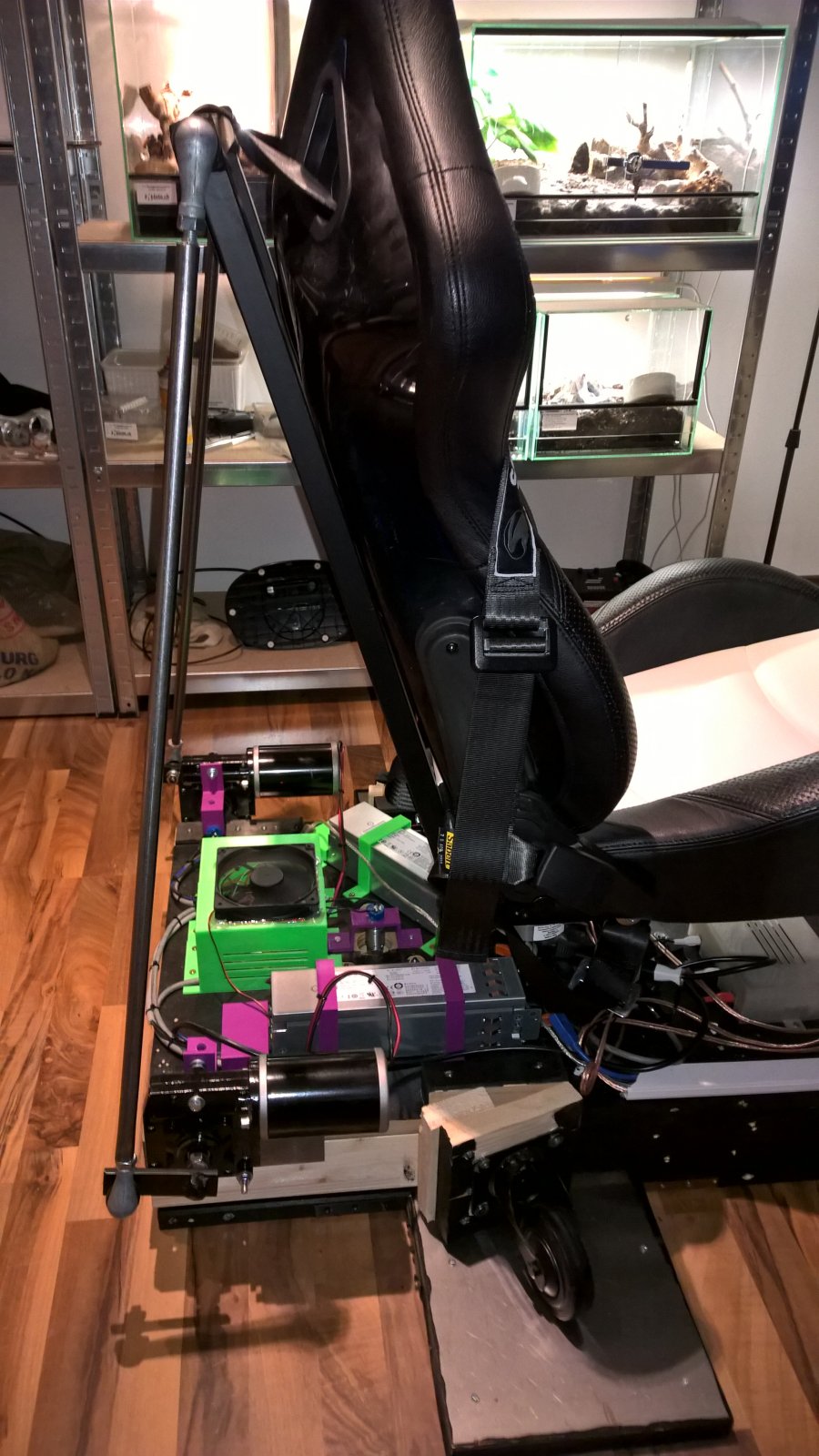

    Hello all
    i have for quite some time now a seat mover with traction loss with arduino smc software.
    Works great! Only "problem" i have now since i got my Heusinkveld ultimate pedals, that my motors are getting warm.
    Reason is that the brake pedal needs a lot of brake force now, thats why the motors warm up.
    They have a outside temperature of around 40C° after maybe an hour heavy racing in iracing.
    Also asked PGSaw if he knows the max temperature but so far he couldn't tell me yet.
    So i know quite a lot here use these motors, or have similar which maybe have temperature specification.
    Is it save to drive em like that, or do i have to change something, maybe optimize the angles or levers ?
    I know from my 3d printer stepper motors that they run at 60°C all the time, but this is no stepper motor.

    For now do add some fans while you get it sorted. it is simple and cheap to do.
    Do post some pictures of your motion sim so members can advise regarding possible design changes.
    Some members drill holes in the motor case to get greater air circulation and cooling.

    Yeah was thinking about the fans, but not sure it helps any because of the flat round surface of the motors ?
    Do you know which member it was that drilled holes in those pgsaw motors, quite dangerous for the motors ?
    I attached a picture of my sim.

    Correct, you dont have Any real leverage going on there. those motor's are bound to run hot hot with those angles.
  6. Historiker
    2,162
    9,214Coins
    +2,170 / 19 / -1
    Your angles are trying to lift rather than tilt. Which is easier; lift a heavy object or tilt it over? :) Those motors are working really really hard.

    Hmm how much angle do i need ? Currently the angle between the seat frame and the rod is 30°.

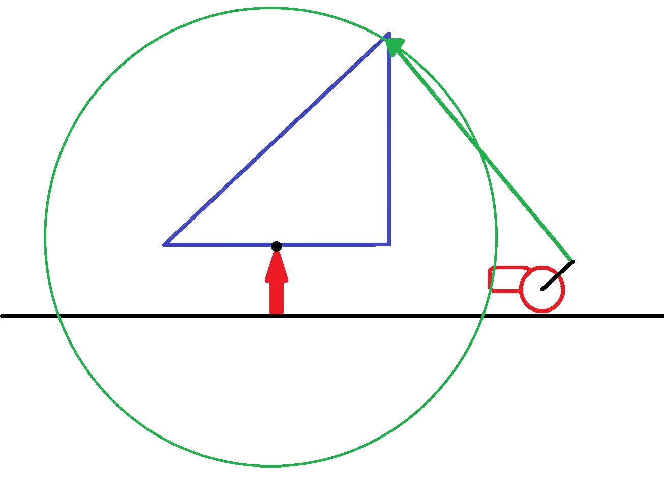

    This is the way to achieve tha maximum force...
    Try to have 90 degree angles at both ends at rest position.
    A 90 degree angle on the motor side is easy.
    On the shoulder side you should target for as close to 90 degrees as your design permits.

    This next pic explains clearly why you need to be as close to a 90 degree angle to maximise performance.
    If the angle between F and R is 90 degrees (θ=0 degrees) then cosθ=1 so the force result is maximised.

    Ah thanks. So if i mount the motors further back and maybe a bit higher from the ground, and keep a 90° angle at motor side, should help the situation i'm in ?

    if you follow the above then you reduce the stress of your motors for a given task.
