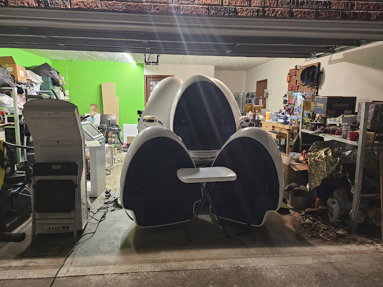

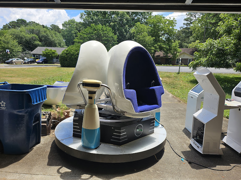

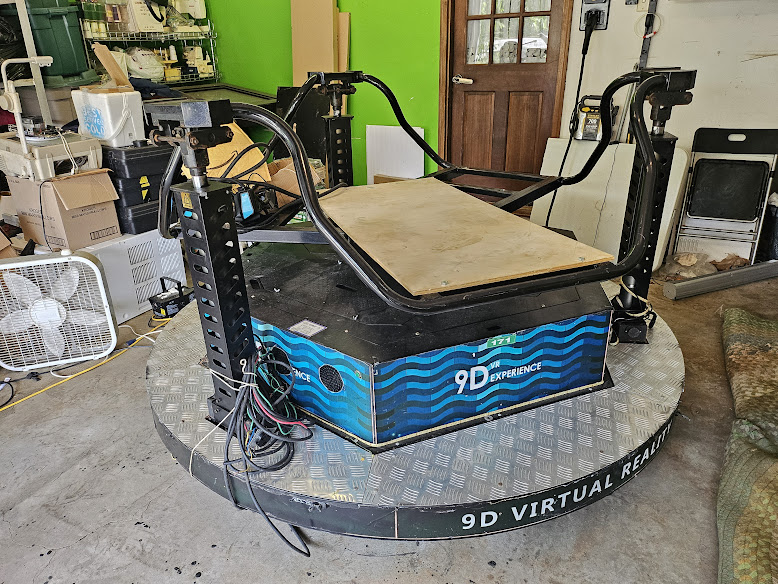

    Thanks to Facebook Marketplace, I was able to trade for two amusement-level simulators (which I'll cover in another topic), and they came with extra noise-canceling "egg chairs" that are perfect for this.

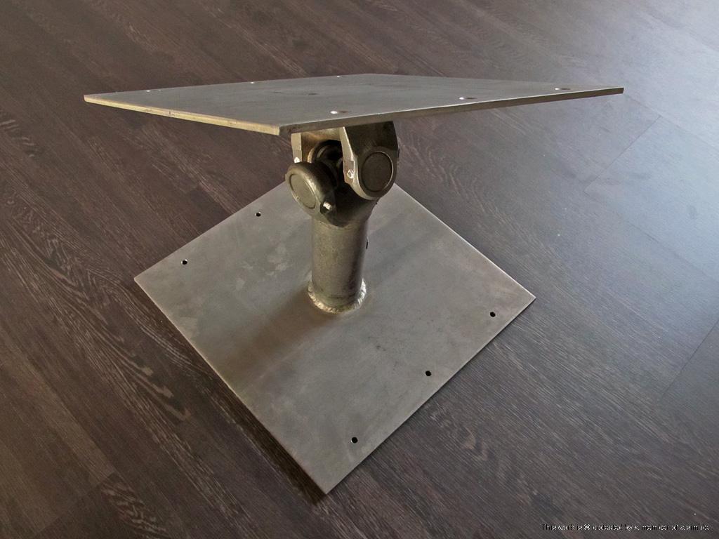

    Since I only need 2DOF, I plan to attach the chair to a car Ujoint along with two motors, as demonstrated in D Max's excellent video series on driving sims.
    In the coming days, I'll post some CG mockups of what I have in mind, but I'd love to tap into the forum's experience on the best way to attach those motors to this chair.
    Should they be on the plate where the universal joint and chair are bolted, or should they be higher up on the back of the egg?
    I look forward to hearing your thoughts. Please feel free to ask questions, and I'll post more pictures and mockups as we go.

    My interest in motion simulation is somewhat similar to yours...how VR could be enhanced by the likes of motion.
    From your description it seems you plan a compact motion design for the egg chairs. Properly balancing the rig with the user and all peripherals is important: https://www.xsimulator.net/communit...-of-gravity-to-balance-a-motion-simulator.55/
    It seems you are aware that controlling native amusement-level simulators is problematic, and instead plan on swapping out hardware for that which can be controlled. To that end, in a compact design maximizing design torque, and torque utilisation, is very important.
    As an aside, given the nature of your project, you may find the official companion apps of interest: Video Ride Recorder, Video Ride Player and Video Ride Creator: https://www.xsimulator.net/community/marketplace/categories/official-companion-apps.32/

    With a compact design try and maximise the inherent design leverage, by that I mean have the motors and related connections as far from the pivot point as possible. That will maximise effective torque utilisation.

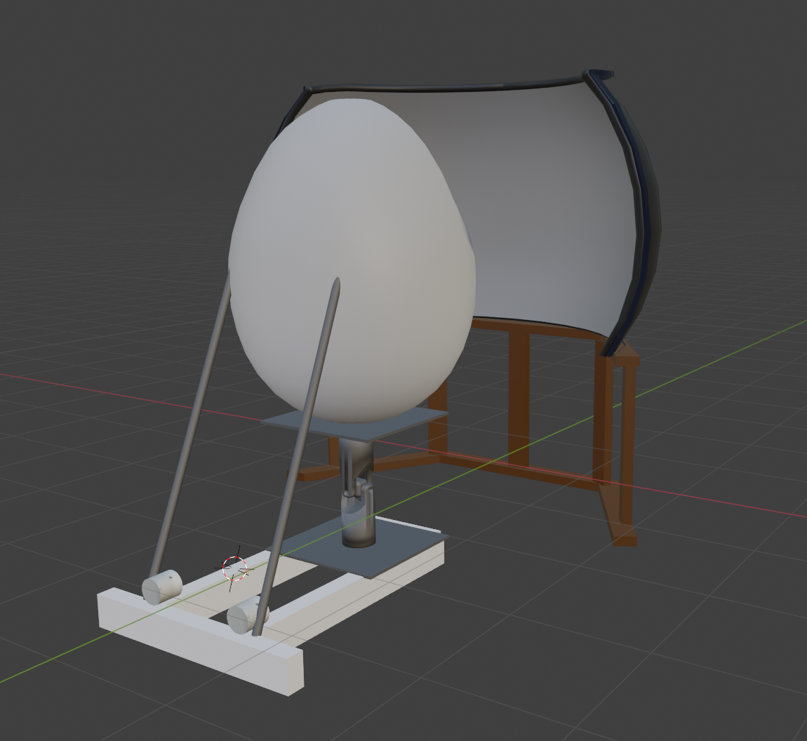

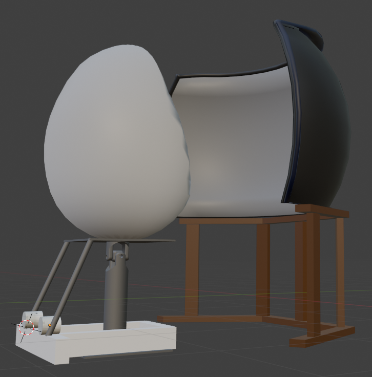

    I've made a very crude version of how I picture the motor placement.
    The way I see it, I just need to make sure it can handle the workload, get "beefy" enough parts.

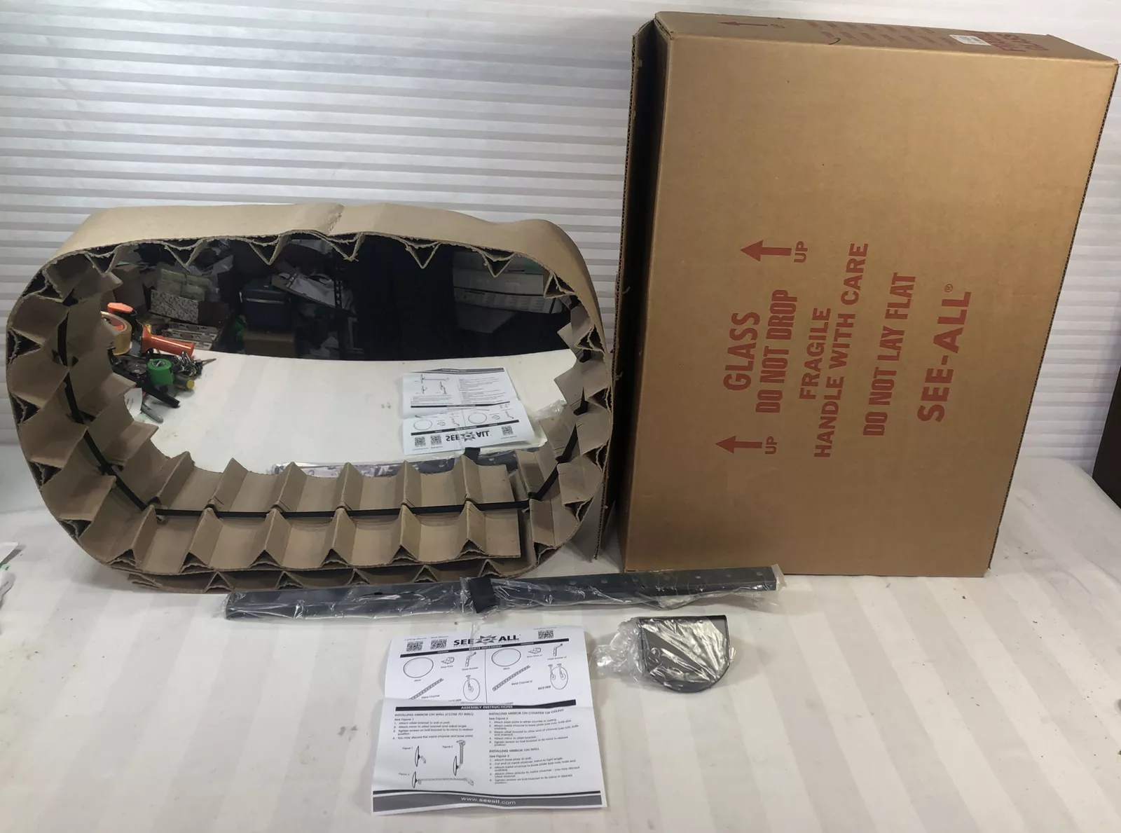

    Facebook marketplace has been MAGIC the last few months. I had to drive 600 miles round trip to get it in a rental van. Even with that it was only $200.
    It's called the Cobra Venom 180. They still sell them but I got a bit stonewalled when I reached out to get more info.
    https://www.est-kl.com/cobra180-venom/
    I'm reverse engineering the specs based on brochures they've found. I'd share that but like.. someone would have to have one too, yeah?
    The tricky part is replacing the mirror they use, that's a work in progress I should probably share here once my next test one comes in.

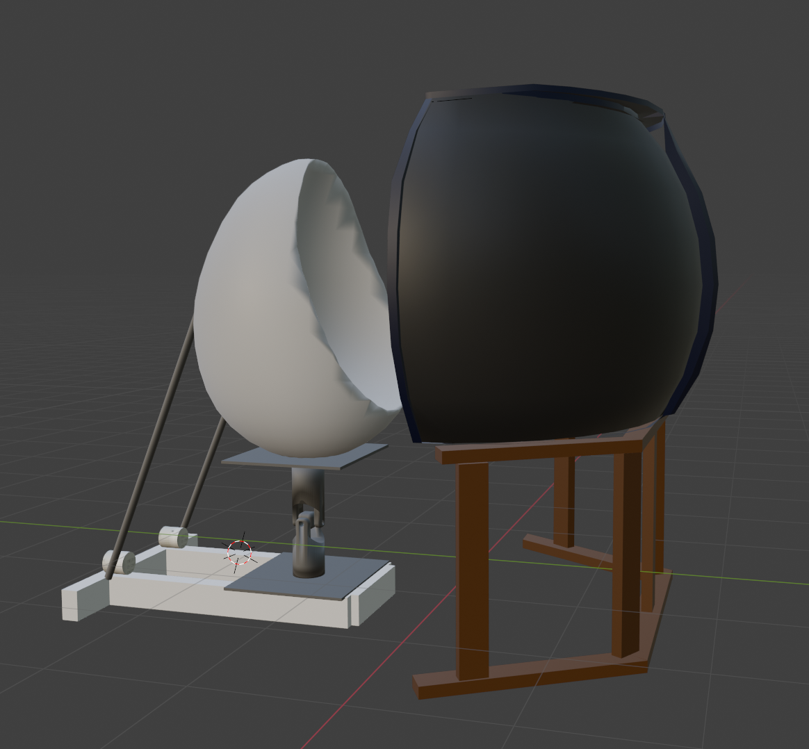

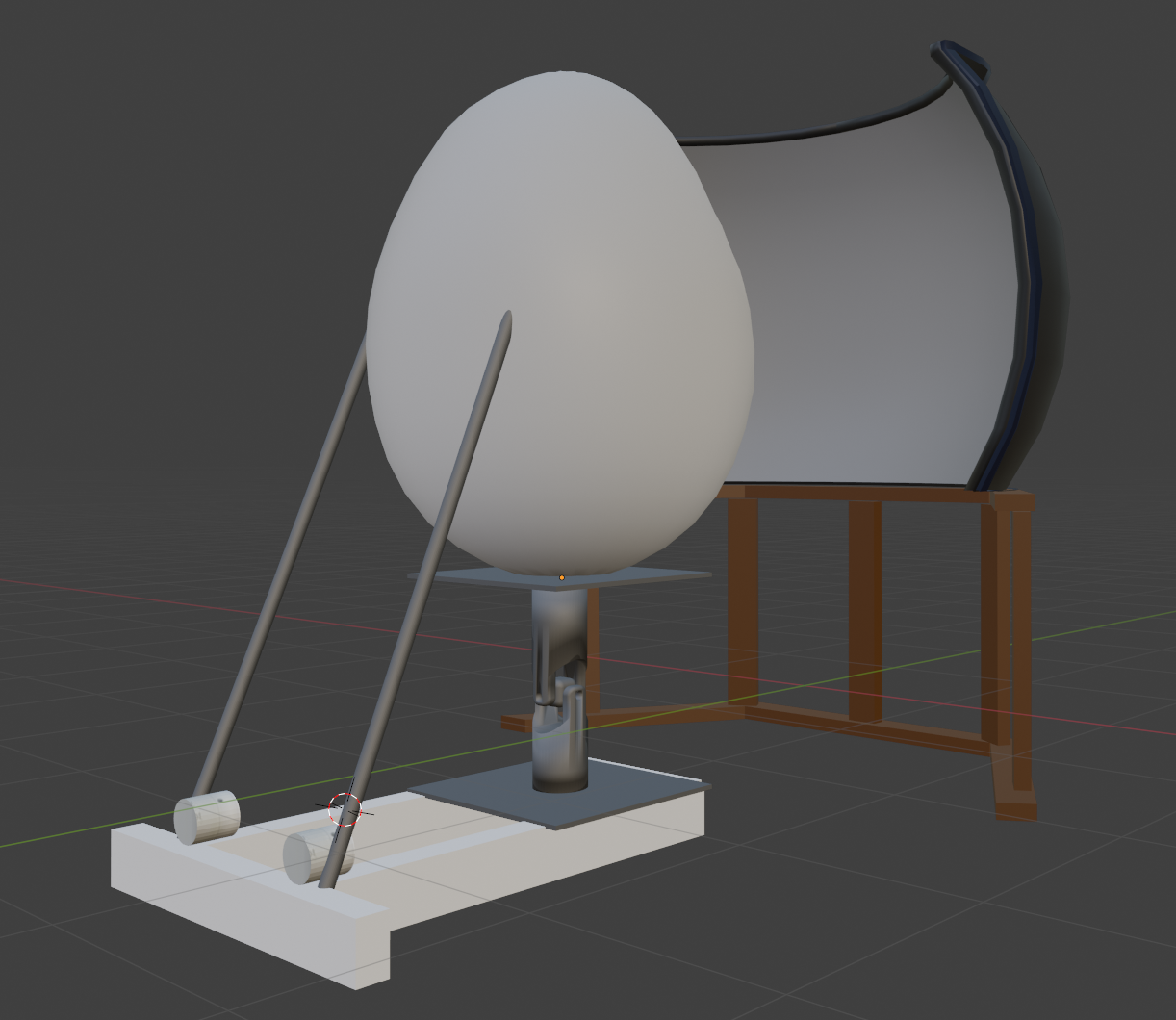

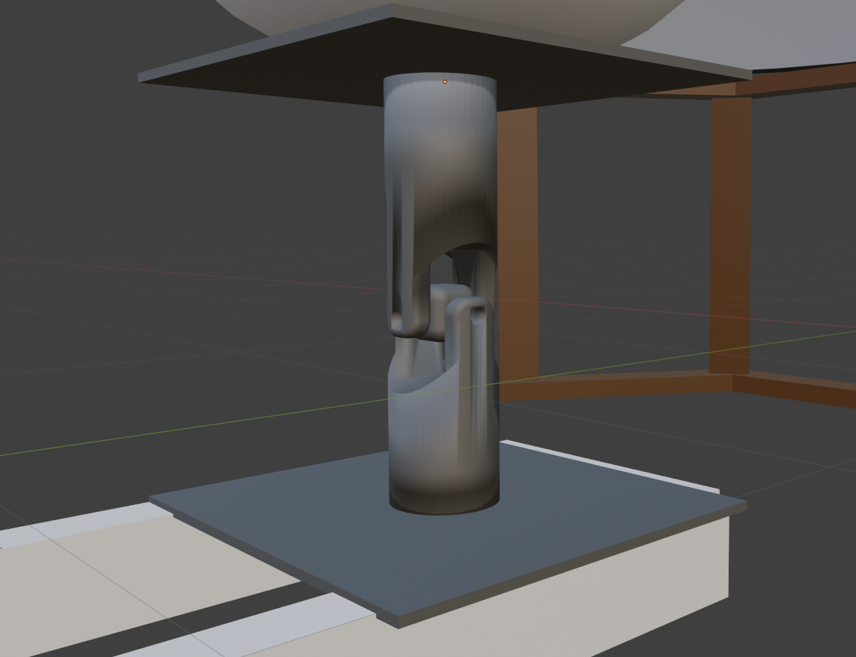

    Spoke to my brother in Florida about the need for the center Ujoint and he's on board with fabricating the key part.
    I made this quickly and it's not to scale, but I think shows what we have in mind. Since there are so many potential users and this is physically bigger than most seats, we want this to be beefy so he's going to source a car axle and weld that to two plates, again similar to this other build from the forums but larger.
    Once I have this I can start on sourcing motors and whatnot.
    21,493
    150,578Coins
    +11,017 / 55 / -2
    Do keep the uni joint as close to the egg seat base as possible: https://www.xsimulator.net/community/faq/universal-joint-placement.108/
    As per your last image:
    Do not put it in the middle, as per the renders, as that will create unusual geometry and place addition strain on the motors.
  10. peter stolmeier
    peter stolmeier Member
    Sep 29, 2020
    84
    498Coins
    +48 / 0 / -0
    Yes, you are of course correct. I worked that out soon after making that quick example. I'll have to update it soon to avoid confusion.

    Here's the very rough, but closer to usable, rig. upload_2024-8-6_11-55-18.png
    Looking at other rigs I think i can make the motors attach a little lower, this is good because attaching them to the egg would be difficult.

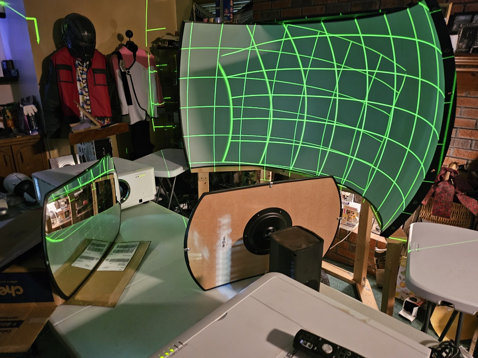

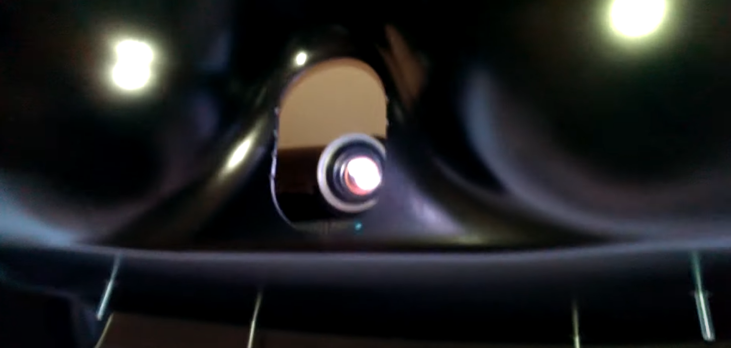

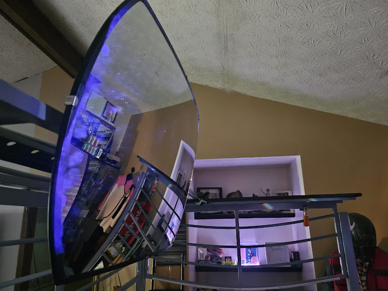

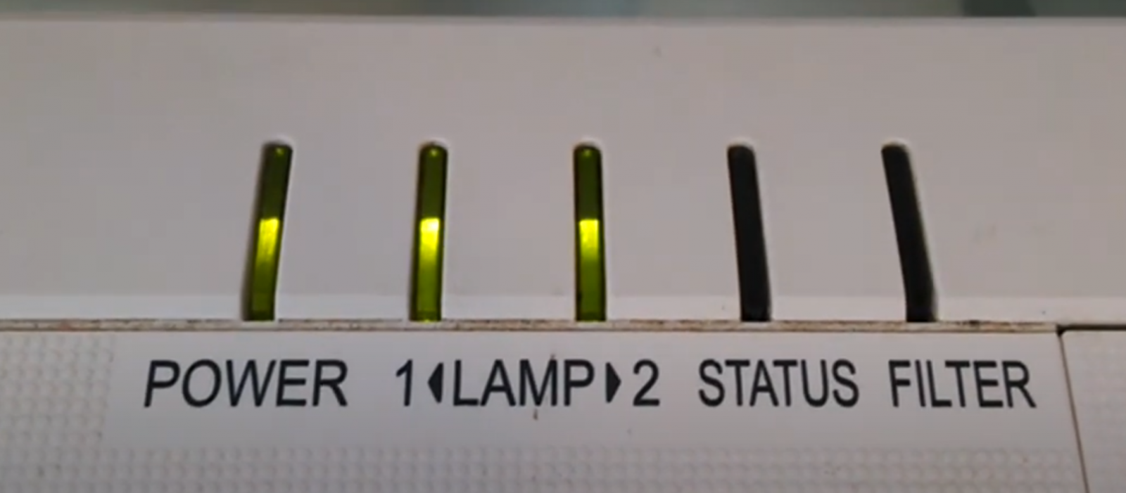

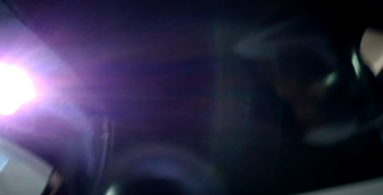

    As you can imagine it's going to take a while for family to source and weld the joints I need. In the meantime I've made progress on the screen.

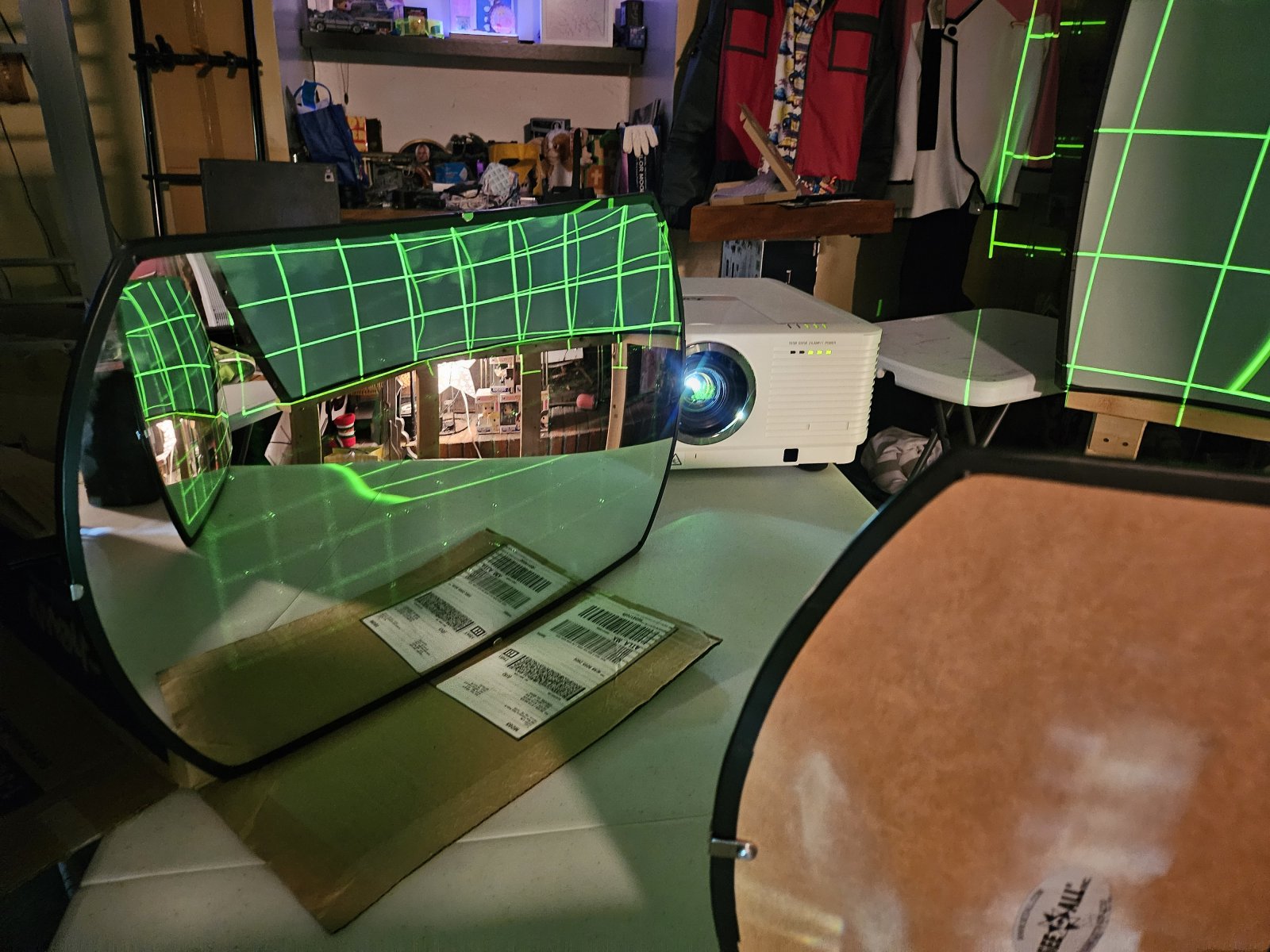

    Originally this "Cobra Venom 150" screen came with a topper that had a first surface convex mirror.
    Below is some screenshots from a video showing off the device, I know it's hard to see but like, mirrors are like that, right?
    Thanks to this video and some plans they posted, I was able to reverse engineer the specs and found that a large security mirror of 21x15 inches has the same dimensions and near correct warping.
    AP1GczMgboQOtQm95Dubs0qjeuPVA6XjFF4XgtVyvSr-cpIQQTyQUa5UJLlqjww778-h584-s-no-gm.png s-l500.png
    Because of the crowdstrike issue I had to order this mirror FOUR times for one to arrive and it took 6 weeks but it is finally here and it works great!
    Not being first surface is of course an issue but I'm overcoming it with the projectors I'm using having two lamps and a staggering 7000 lumens. (I have three another crazy good FB find)
    This system allows me to get the screen coverage I need without buying the $350 lens for each projector. New options of multi projectors open up now, and eventually I can use just one 4K unit.

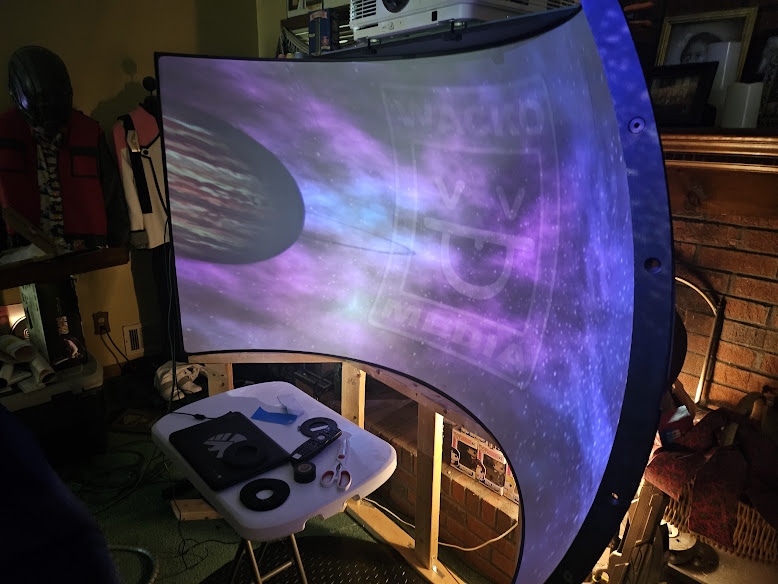

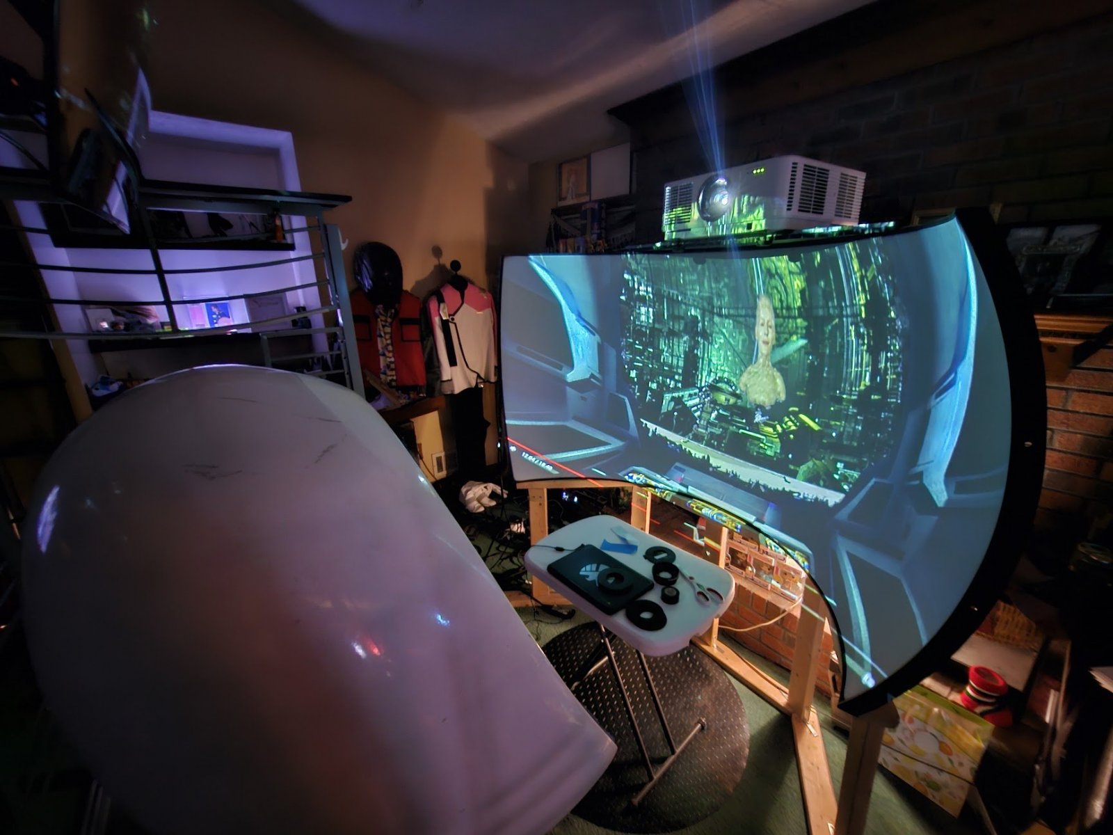

    I tested it in a few ways but I think the one you guys will like is my first run-through of Borg Encounter 4D
    Even without the motion I got a limited amount of immersion.
    There's still a lot of work to do but I'm at a point where I'm confident it will work.

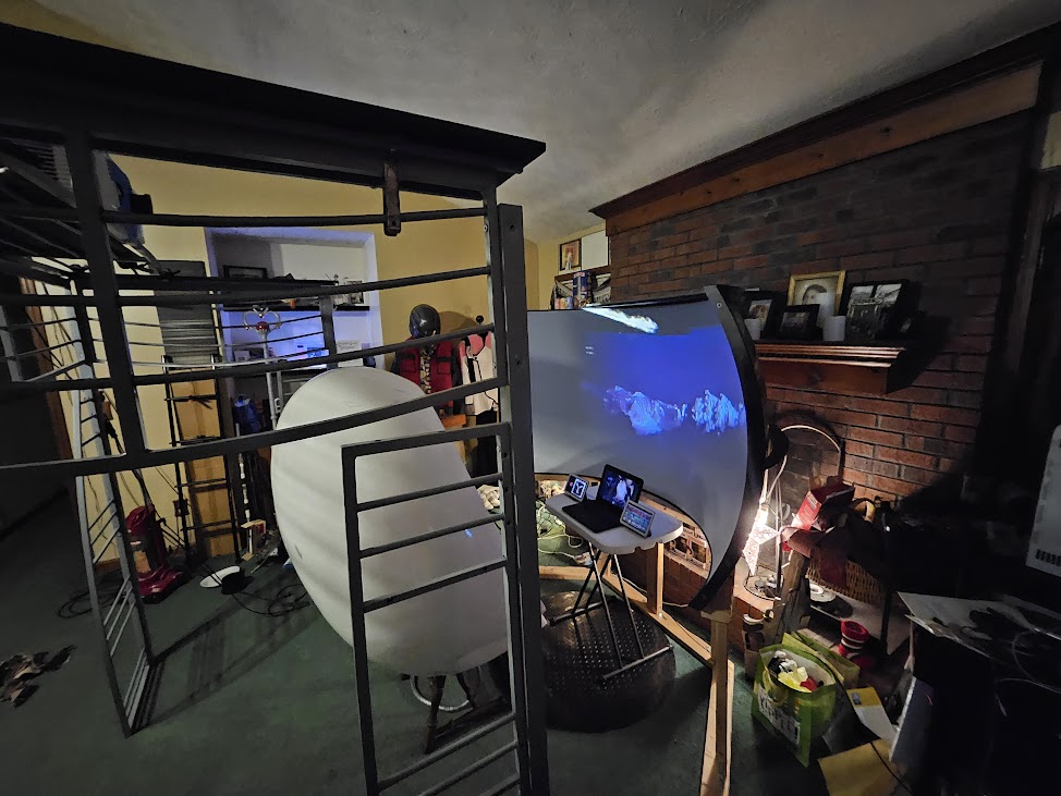

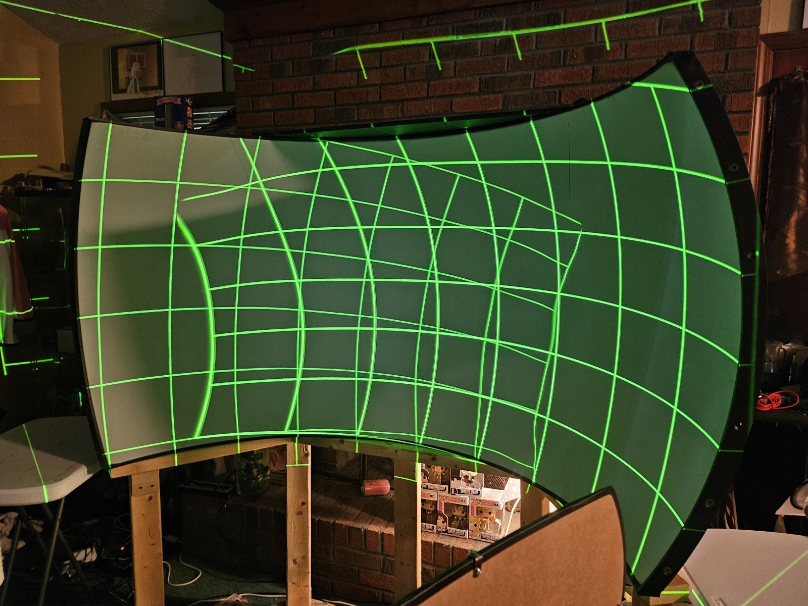

    I've run a bunch of tests and the I'm starting to really understand the trades-offs to fill this screen.
    This is using two identical projectors on two identical mirrors. Please note I have not bothered to do warp adjusting because I know for sure that will work and it was not needed for this test.
    I've set this up in a way to maximize the pixel density. Previous tests use only one projector and a significant amount of pixels are lost to fill an entire screen. Only with blending 2 projectors can I get full coverage and a clear image.
    This is all fine and good but now I have to worry about alignment on a constant basis. Since I plan to have this in public I think it's important that it be reliable once initial calibration is done and this is good looking at the the cost of that simplicity.
    What I'm trying to say is I'm tired of trying to fiddle with this! I'm thinking of scrapping the kickass screen and replacing it with a curved TV.
    There are serious advantages to do this this at the cost of FOV. It's more reliable, higher rez, and I can bring back in the per-user adjustment system I have in mind.
    Plus, I would end up selling this screen, and I think some of the folks here would be interested.
    What do you guys think? I feel like a lot of you have used projectors and screens could give me insight I have not earned myself yet.

    I totally agree. The dome screen looks impressive but it takes a lot of effort and money to get it right and it's probably not worth the trouble for a home theatre. I also thought about using a dome display for my helicopter simulator project. But it wouldn't be possible to cover the full surface of the "glass bubble". In some helicopters you can see the ground behind the foot pedals. The dome display can't reach that far down even if it's 180° wide because the dashboard would create shadows.
    So I think it's easier to implement this with multiple flat screen dispays even if this means I need 6 of them (windscreen, left&right windows, left&right foot area, instruments).
    VR goggles would make everything simpler but have other disadvantages.
