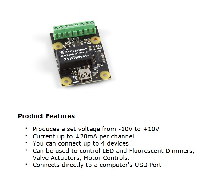

    PhidgetAnalog 4-Output
    Just a quick overview.

    The Velleman VM110/K8055 will give you similar functionality and more channels for a cheaper price.
    Unfortunately the positioning loop still has to be in software with the encoder option too.
    There is no such thing as perfect. :)

    Correct me if I’m wrong, but doesn’t the Velleman VM110/K8055 have 2 analog inputs & outputs with a maximum of 8 bits of resolution?
    Where the “PhidgetAnalog 4-Output” has 4 analog outputs with 12bits of resolution?

    Oops, you're right! I thought it has more channels.
    You could use the output board to control 4 motors with the encoder board to read their position.

    Seems like a great setup for under 200$ USD.
    Good Speed and Resolution with the ability to control 4 AC drives / Motors.
    So what would we need to connect the boards to X-Sim is the question?

    Looking further into the Velleman VM110/K8055, I believe the PWM signal would still need to be converted to be able to control AC drives.
    Like the one tronicgr designed here:
    tronic-s-amc-motor-motion-controller-with-pwm-servo-output-t559-630.html
    This is what I was thinking for one axis of a powerful AC system.
    1 HP 56C frame 1800 RPM three phase electric motor
    http://www.fremontindustrialsupply.com/ ... weg/Detail
    Phase Converter VFD
    *Setting available for constant torque
    *External Signal Needs Adjusted at purchase (If this characteristic is not convenient contact Drives Warehouse)
    http://www.driveswarehouse.com/Drives/A ... 7NFU1.html
    Dual output shaft worm gear reducer (30:1 ratio)
    *Potentiometer on one side with the Actuator Arm on the other
    http://www.fremontindustrialsupply.com/ ... rse/Detail
    About ~400 USD an axis
    About the cost of a scn5/6 with a ton more power leading to much bigger x-sim systems.
    I just don’t know how to control them? :blush:
    Is there any off-the-shelf AC motor controllers currently available to x-sim?
