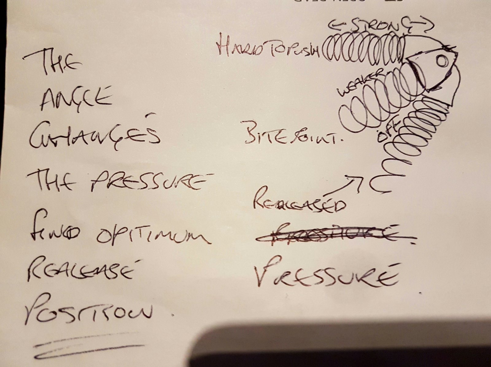

  13. f1iceman
    Aug 29, 2015
    832
    UK
    791Coins
    +390 / 2 / -0
    2DOF, 3DOF, SCN5
    you can get bite points on some games and adjust but you need the pedals to be set up to feel that way and then match the settings up in the games for sensitivity and so on.
    like i dont calibrate my clutch full press and then use the game setting to put the bite where i like.
    i have control in iracing and dirt if i rememeber right.
    but my pedal set lets it down. i was thinking of a spring n shock system worked out with the right angle that its hard to press then the leaver angle canges at about 50% travell then the angle weakes the feel so you get a hard to soft transition.
    once you find that setup right you have a bite point.
    well thats what i was thinking ! lol

  17. f1iceman
    Aug 29, 2015
    832
    UK
    791Coins
    +390 / 2 / -0
    2DOF, 3DOF, SCN5
    Depending how you mount the spring angle and the arm that fot to the clutch pedal you can go in at an angle that also pushes the spring away to the point it flips from hard to soft.
    And its that point of hard to soft change you could use to have as bite point.
    Set software up to bite there and it should be a close feeling.
    Thats if my theory works in the first place ! Lol
    Easy to test it out with rc car stuff.
  18. f1iceman
    Aug 29, 2015
    832
    UK
    791Coins
    +390 / 2 / -0
    2DOF, 3DOF, SCN5
    Lol !
    Will let ya know if i do tho.
    Have alook at the drawing n idea i just commented with for my idea.
  19. crammy
    Feb 23, 2016
    563
    Fabrication
    essex
    4,633Coins
    +326 / 2 / -0
    SCN6, 4DOF
    I can see how that would work and quite easy if you get the angle right. would definitely need looking at on CAD to get positions. if i had a known spring and damper i could work it out
