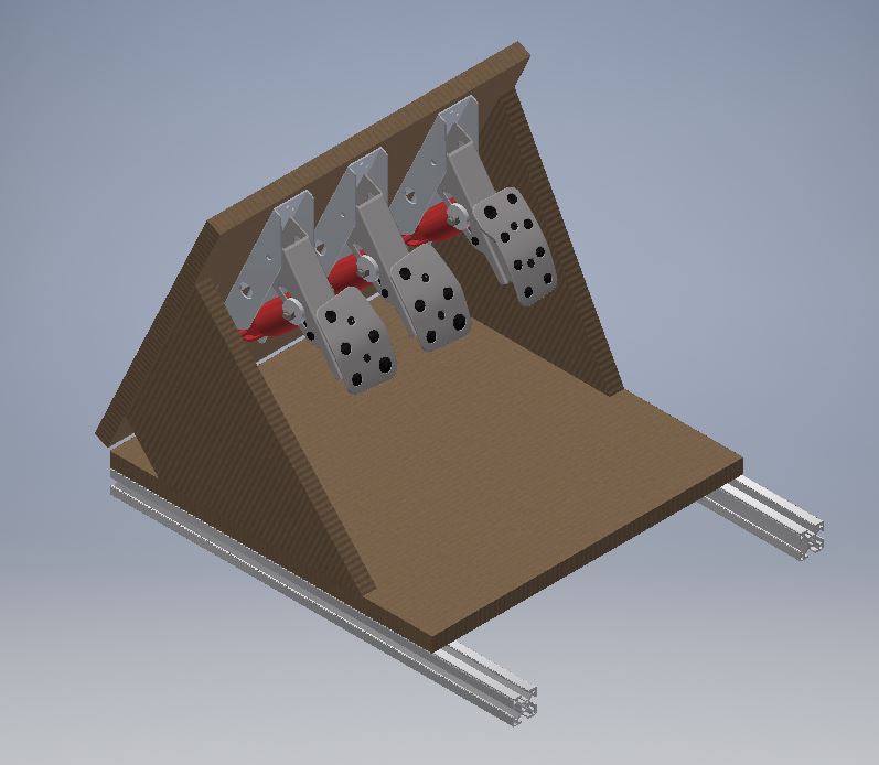

    Hi I would like to share my project for getting G29 pedals upside down. Probably it will work for G27 & G920. STEP file in the attachment. I've made it out of 18mm thick MDF board. Whole thing is 386m wide but you can change it with Direct editing of the STEP file in Inventor or SolidWorks( I don't rember how it's called in Fusion 360). Holes for mouting the pedal brackets and holes for cables are already included but holes for mouting it together are not included because there are various joining elements you could use. just remember to predrill holes in the material to prevent it spliting when screw goes inside MDF. I've added some carpet on it. I will send some pictures of the real solution when I get back home from work ;).
    If you have any questions do not hesitate to ask me!
