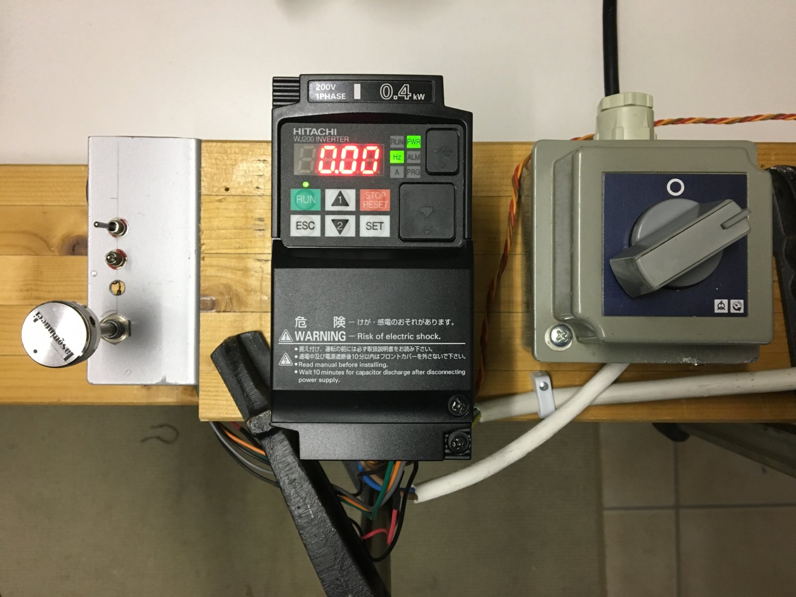

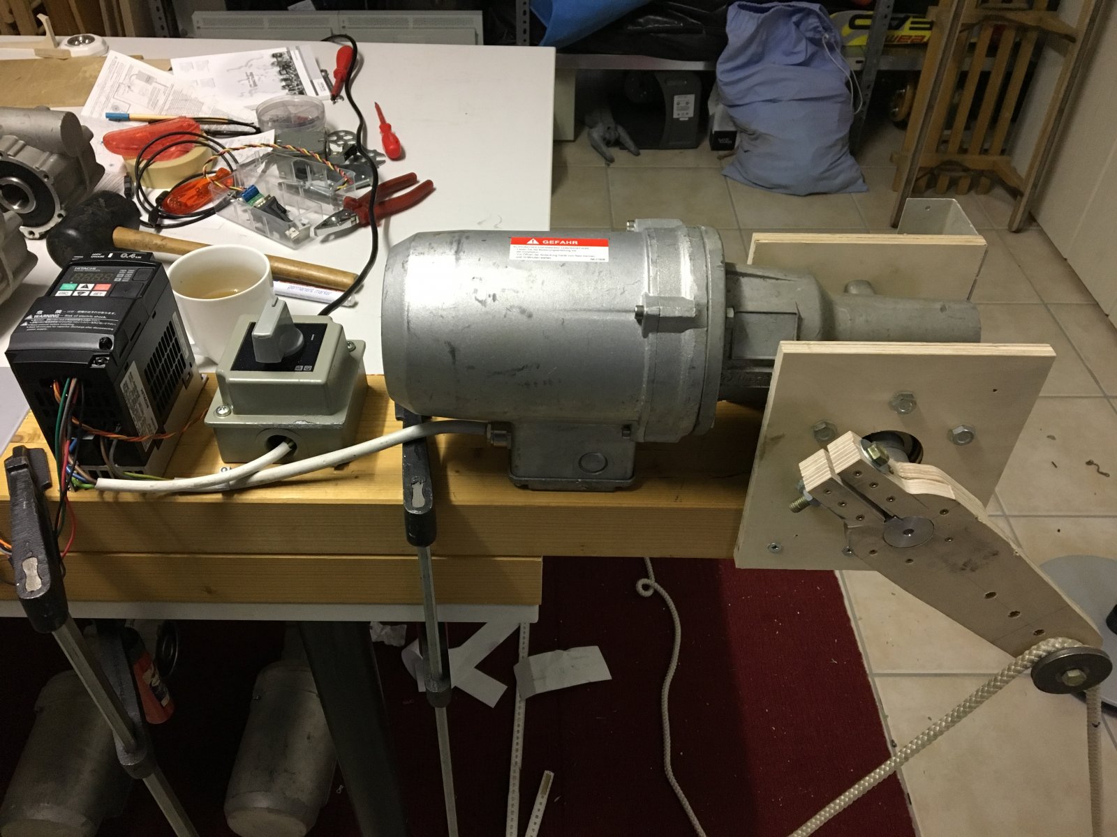

    UPDATE: First servo test completed.
    My test setup is using a single motor + 1:52 worm gear. I had purchased a Hitachi WJ200-004SF inverter rated for 0.75kW. I mainly chose this unit as it features a PID controller and can be fully controlled via modbus protocol on RS485. Ultimately I will daisy chain all 6 inverters and run them directly from the PC. No need for intermediate embedded controllers and such.
    The test subject is to verify the basic servo concept, primarily playing with the inverter (insane amount of parameters available) und put some realistic loads on the mechanics.
    Overall setup:
    The inverter is setup in PID mode using a position encoder (10k poti) and receives position demand by a second poti. The hitachi features a 10V analog input (used for position encoder) and a 4-20mA standard current input. Just hooking up the poti to the current input does not work properly as the produced current is not linear (I=U/R). Instead I needed to put together a howland current source (https://wiki.analog.com/university/courses/electronics/text/chapter-4) to get usable linear current control.

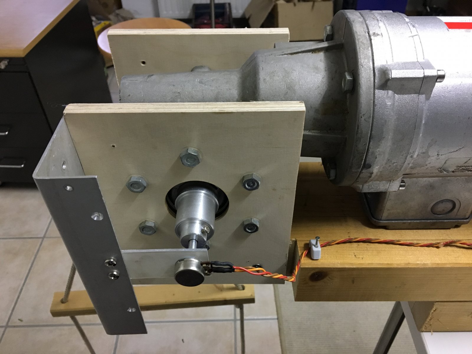

    Position encoder is held in place by some flexible plastic to compensate for any shaft misalignments.

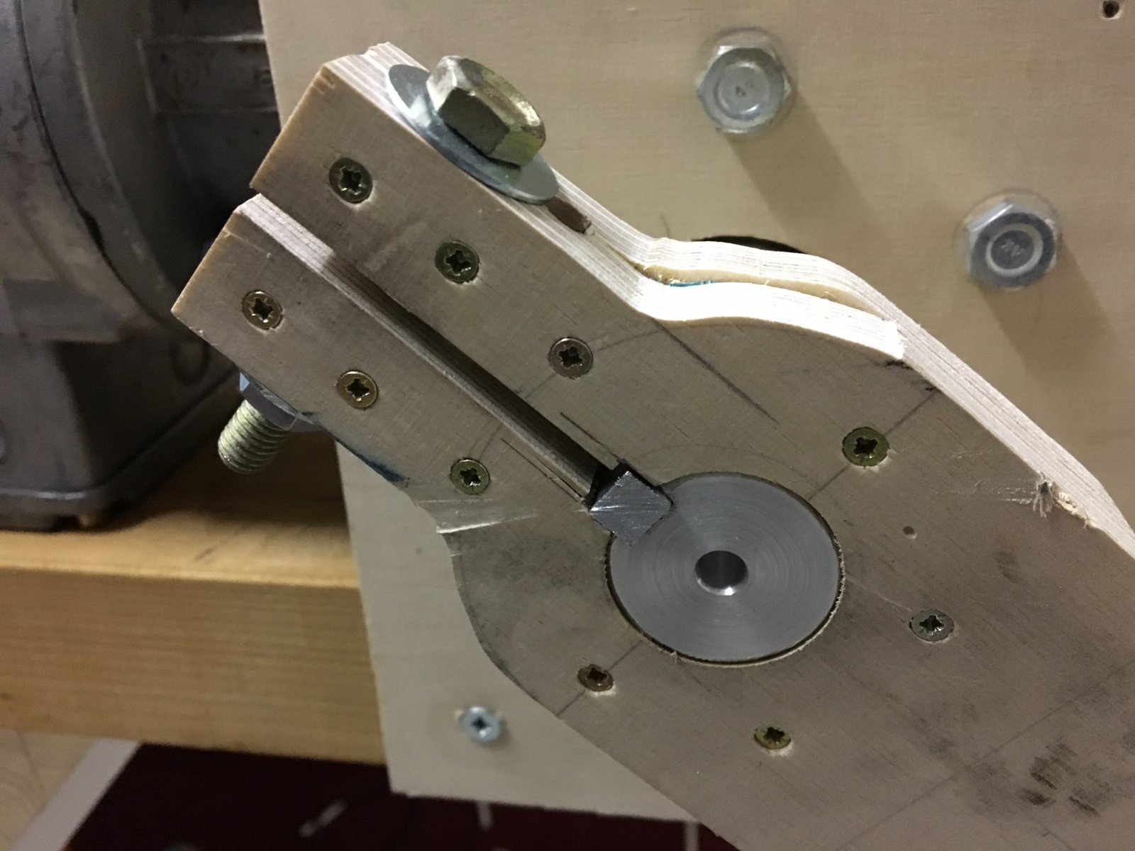

    Close up of the servo arm mounting. The final version will be a 15mm aluminum lever.
    This is a free run without load. The rotation angle is limited only by poti angular range (ca. 240 deg). I will fit two endstop switches that will engage the DC brake.
    SAFETY WARNING: make sure the lever can freely turn 360 degs. I messed up the settings several times and overran the intended angles. I may actually take this into account for the 6DOF design. The motor is extremely powerful and may easily chop off body parts. Make sure there is enough clearance around lever.
    Now comes the load test. 18kg on a 18 cm lever arm, about 32Nm. The motor is wired in star configuration which gives 70% margin to delta config. No problem developing the necessary torque. Though when starting from rest with lever horizontal (max load), the motor stalls when applying small acceleration (note the whining noise). The 6DOF design will feature gas springs that should avoid such cases.
