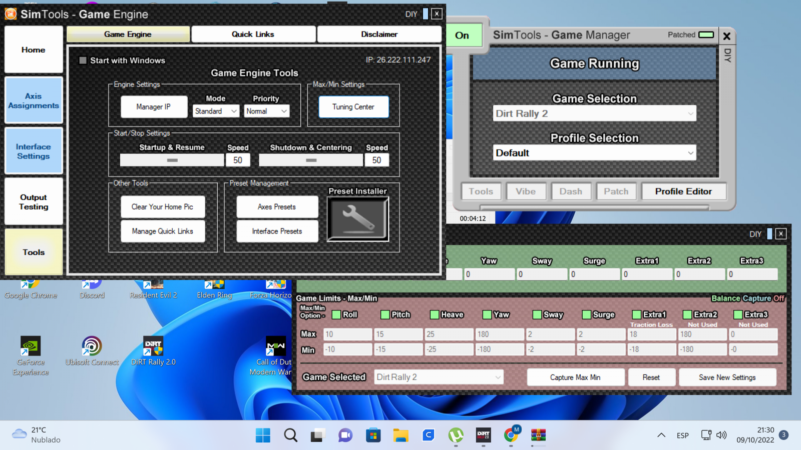

    I managed to put it looking for the directory that it puts in simtools, which is where the game saves the settings, the patch icon turned green but the simulator did not move when playing, do you know how to solve it?

    hello, the path where I put the patch is documents/mygames/dirt...
    the manager icon turns green but the simulator does not move

    Is your computer 64bit and is there data in the Tuning Center top row when the game is running?

    hello, if my pc is 64bits, I don't know what program you mean tuning center

    hello, that's what I get with the game open

    Hello, that is the configuration that I get with the game running

    This is the Tuning Center: https://www.xsimulator.net/tuning-centre/
    In your posted screen shot, which includes the Tuning Center, is the car in an active race, not paused? Please post a picture with the game visible in window mode with the Tuning Center also open.
