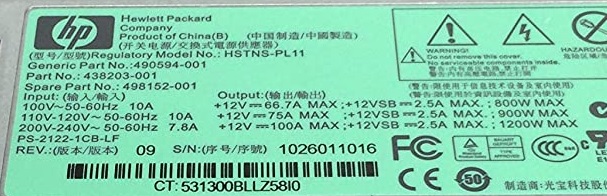

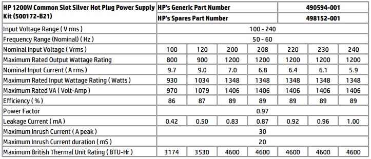

    Attached is the PSU specs. So I'm limited to 12V motors. Also ill be using 220V on two separate breakers to power everything. HP Moition SIM PSU_spec2.jpg HP Moition SIM PSU.jpg

    After bunch of reading I am going to stick with DC, seems like there are just better options with DC motors for speed and torque, also main reason is safety. A 12V DC system is far safer than 220V AC motor, plus the kids will be using this so, ill err on the safety side.
