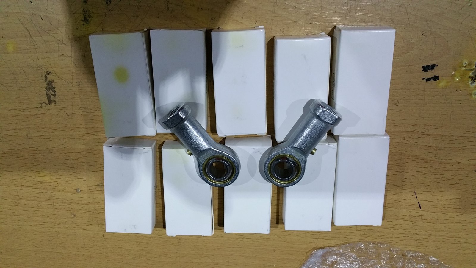

    It appears these are called ball joints or rod ends, and from searching they are 2 different things.
    1) Is there a preference as to which to use and why?
    2)Any recommendations that are commonly used here for the 12v motors?
    3)What is used for the shafts that connect these pieces to the rods that think the motors and chair?
    4) Is electrical EMT conduit good enough, or does the hollow nature allow for too much flex?
    5) I've gone through 8 build threads and the FAQ, and have come up short on the details of linking motors / chair when planning seat shakers.

    I’ve seen them called rose joints or heim joints. McMaster-Carr calls them "ball joint rod ends". Apparently the convention is to call them heim joints in the US and rose joints in the UK.
    https://www.mcmaster.com/#rod-ends/=1a57ugy
    I used 3/8-24 and all-thread to connect using jam nuts on my 2 dof and they seem fine so far but the C-C distance is only about 8" or thereabouts.

    Thanks, did you use solid metal rod/tubing or hollow?

    @gSeat - it’s solid all thread rod. At 3/8-24, it’s very sturdy over this distance.
