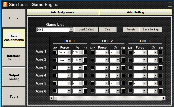

    OK first off I want to start with this software is awesome! very easy to install and setup and simple and intuitive, just great! Just in time for me finishing my build too.
    I am having a little bit of trouble though, I am trying to play Dirt 3, I got the plugin, installed it followed the documentation and set up the game manager and engine as instructed. However when I play the game (everything lights up, it knows the game is running etc) and I set up the virtual axis to check the output the sliders are barely moving! they do move the tiniest bit back and forth as I drive but it is barely anything. I have the axis assignments set to 100% and I can't think what is going on, no doubt right in front of my nose. Please let me know if you need any more info

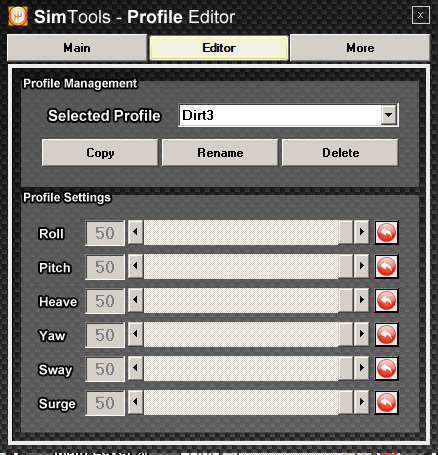

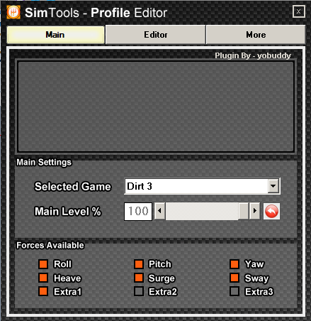

    Yea I have a profile made but it doesn't seem to make any difference when I move the sliders. Just so we're clear, this is in the game manager program under profile editor then editor? The main slider is at 100% and I have moved the sliders in the editor to max and min and everything in between but it doesn't seem to make a difference, the virtual axis only move a tiny little bit.
    In case it is relevant I have surge in axis 1 and sway in axis 2 and that is it, both at 100%
    Also when I say the movement of the virtual axis sliders is small it is only a few pixels kind of small.
  4. bsft
    Got a screen shot?

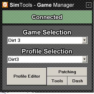

    Game Engine axis.png Game Manager.png Profile editor.png Profile editor2.png

    I agree with BSFT, you need to open the tuning center ap (right click on the "Game Engine" icon and click on "Tuning Center"). Click on "Capture Max Min" and play the game for a bit, then click on "Save New Settings". This should give you movement on your simulator if it is set up correctly.
    If you do not see any numbers in the upper menu of the Tuning Center then you are not getting telemetry from the game.
    I had the same issue with Dirt 3 when I first set it up.

    Perfect! Tuning center is the one, sorted out my max and min and away it went. I'm sure it was mentioned in the documentation but I had no idea how to find the tuning center. Thanks a million for your help guys, much appreciated!

    Tuning centre is only used a little when you first tune a base profile of a car in game. Not designed to be accessed with ease because once game is tuned for the first time, you should then use the provided profile editor in the Game Manager to make a profile for a particular type of race or car. In the profile editor it actually changes the Min Max settings , they either add to it or minus from it as a % so in turn there you are actually manipulating the Min Max Values while leaving the base (default) setting alone. This all can be done while game is still running and effects can be felt straight away. And once you have a couple of set profile it can be selected from the front screen of the Game Manager and changes instantly , not stoping and starting of game. This is how it was intended to be used. Not as complicated as the other is.
