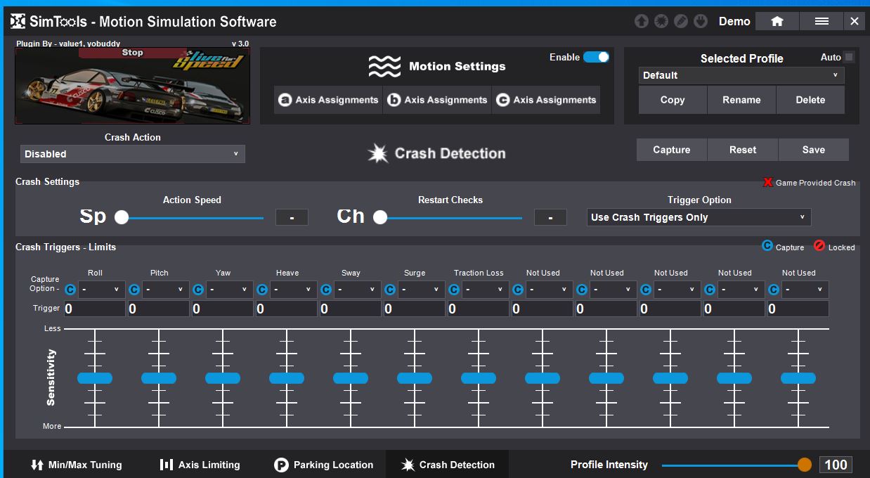

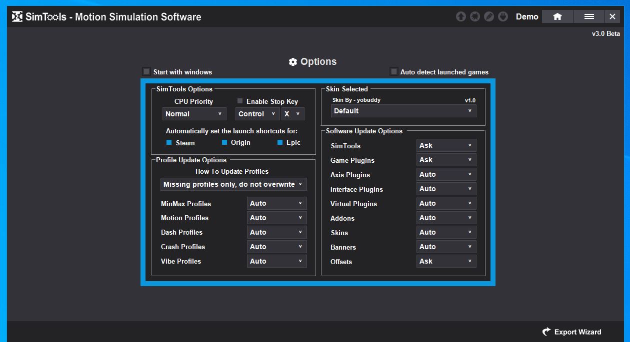

    Can you please post pictures of all of your settings, including the Tuning Center while LFS is running.

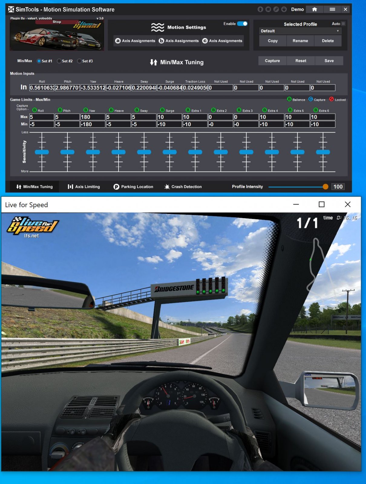

    Yes output testing work as expected, when I click on test settings the rig comes up to parking position and then I can move all actuators with the sliders.
    See photos attached, not sure if I'm missing any screen. Thanks.
    21,513
    150,698Coins
    +11,018 / 55 / -2
    This shows the plugin seems to be working, as there is telemetry in the In line, so try driving at about 85% and Capture then Save, the settings, after that tweak to suit.

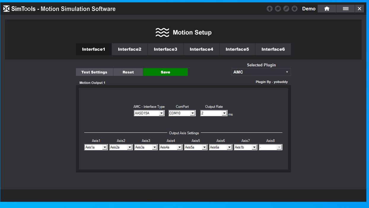

    Yep plugin is working but for some reason the actuators are not moving at all. They move when doing the output testing but not with the game, no idea why. I thought maybe something with the controller but I guess output testing wouldn't work if that's the case.
    21,513
    150,698Coins
    +11,018 / 55 / -2

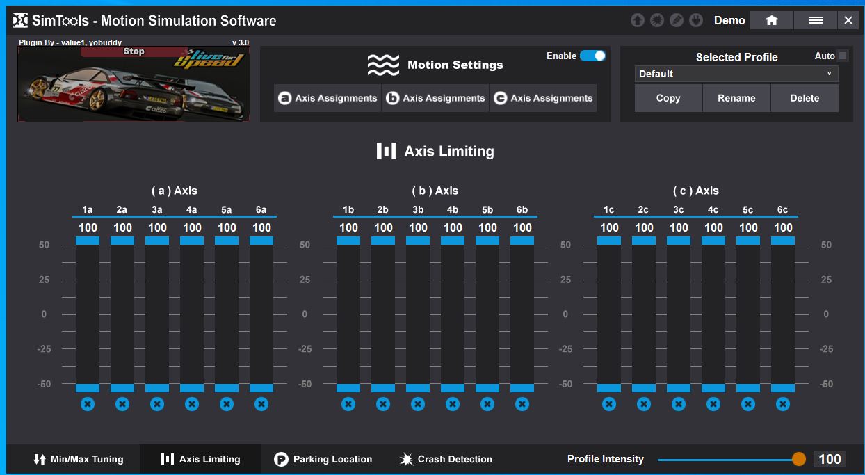

    If Output Testing works then it is a patching or configuration issue. So perhaps unpatch, use LFS for a race then repatch.
    Please post a picture of your Axis Assignments.
