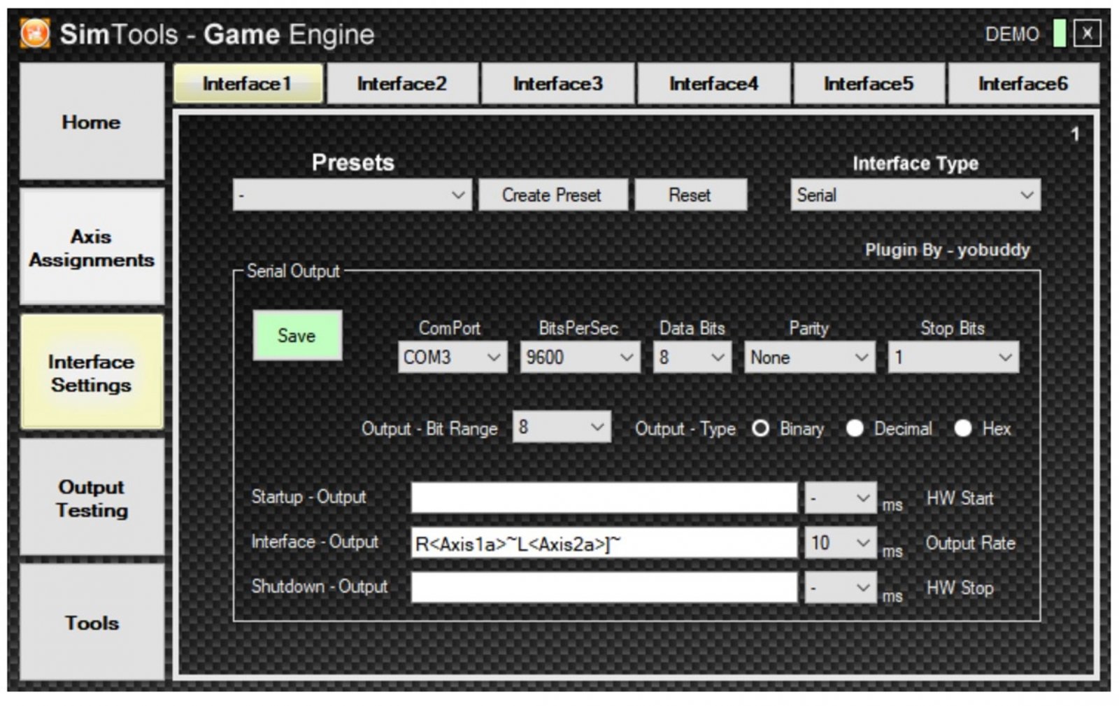

    Hello everyone,

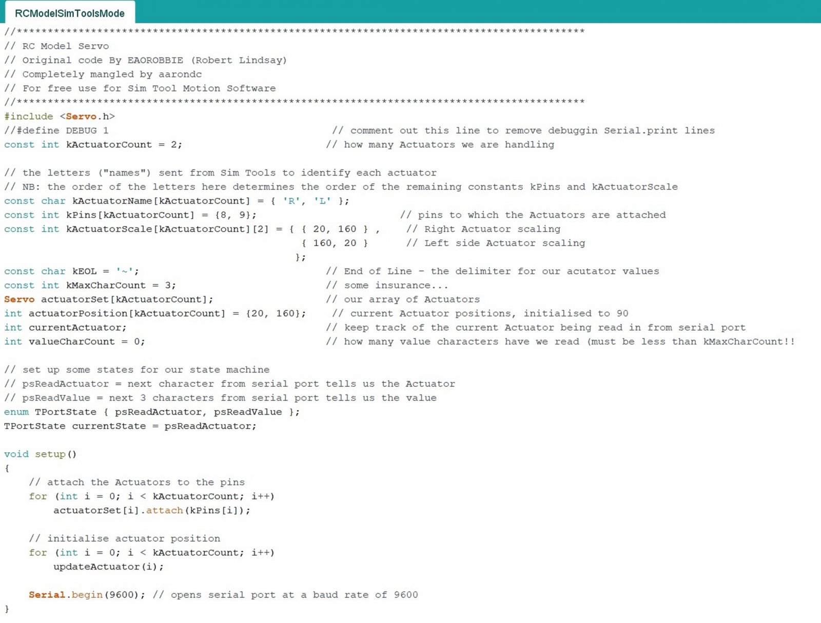

    Before getting into a real build ,I've build a 2DOF scale model with 2 sg90 servos and a arduino.
    I have some experience in arduino coding,
    Tested the servos with the arduino and they work 100%.
    installed sim tools and loaded the arduino code from
    "Original code By EAOROBBIE (Robert Lindsay)
    Completely mangled by aarondc"
    Changed Pin settings to my connections.
    changed int actuatorPosition[kActuatorCount] = {20, 160}; (
    changes made to the initial setting do change servos (so this part works)
    Changed settings in Sim tools game engine.
    But Output testing does not move servos .
    I think it has something to do with the interface output setting or some change i have to make in the code.
    Any help or tips for this beginner.
    21,500
    150,620Coins
    +11,018 / 55 / -2
    Your settings should EXACTLY be like this, so get rid of the extra bracket in your Interface settings and try Output Type: Decimal:

    No luck with the settings you gave me Noorbeast.

    I seem to remember that code worked with an older version of Simtools.
    Try changing the delimiter line in the Arduino code to:
    const char kEOL = ']';
    and then change your Interface- Output settings to:
    [R<Axis1a>][L<Axis2a>]
    See if that works with output type as Decimal.
    21,500
    150,620Coins
    +11,018 / 55 / -2
    The settings I indicated should be correct, for SimTools 1.3 it was R<Axis1>~L<Axis2>~ for SimTools 2 the only change that should be needed is to R<Axis1a>~L<Axis2a>~
