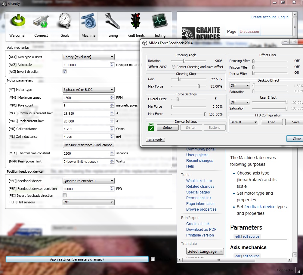

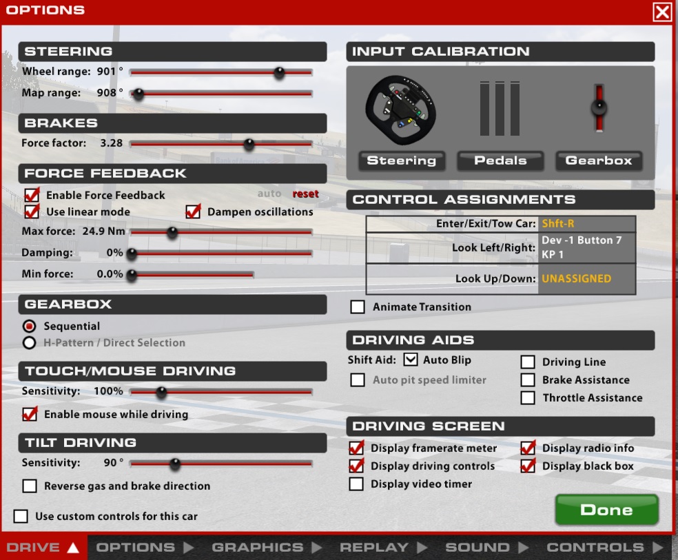

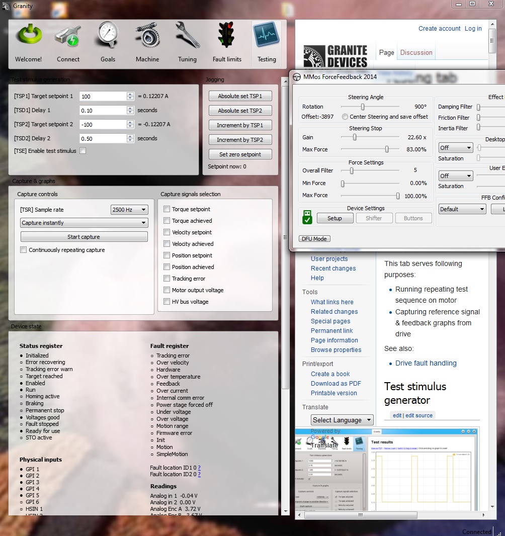

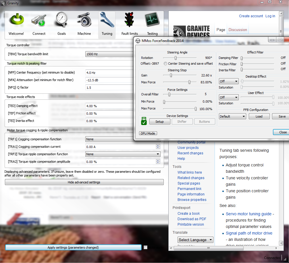

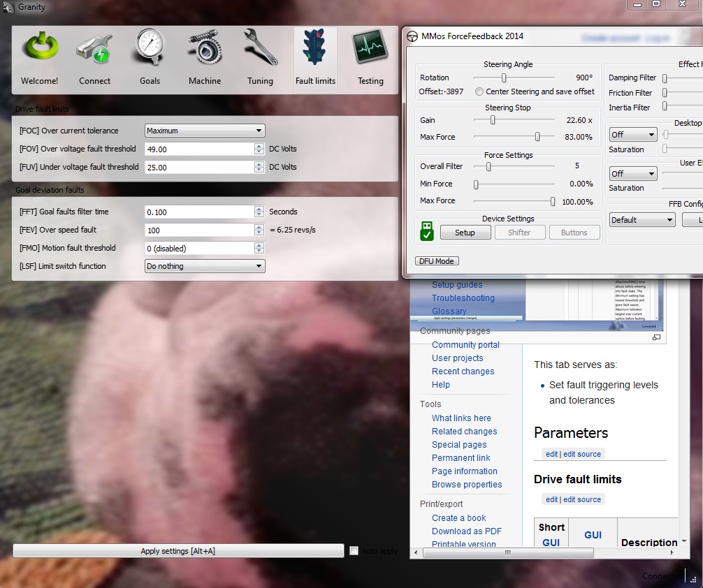

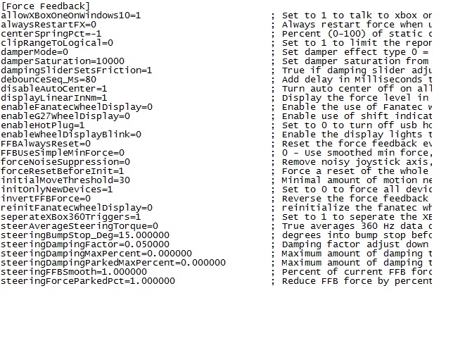

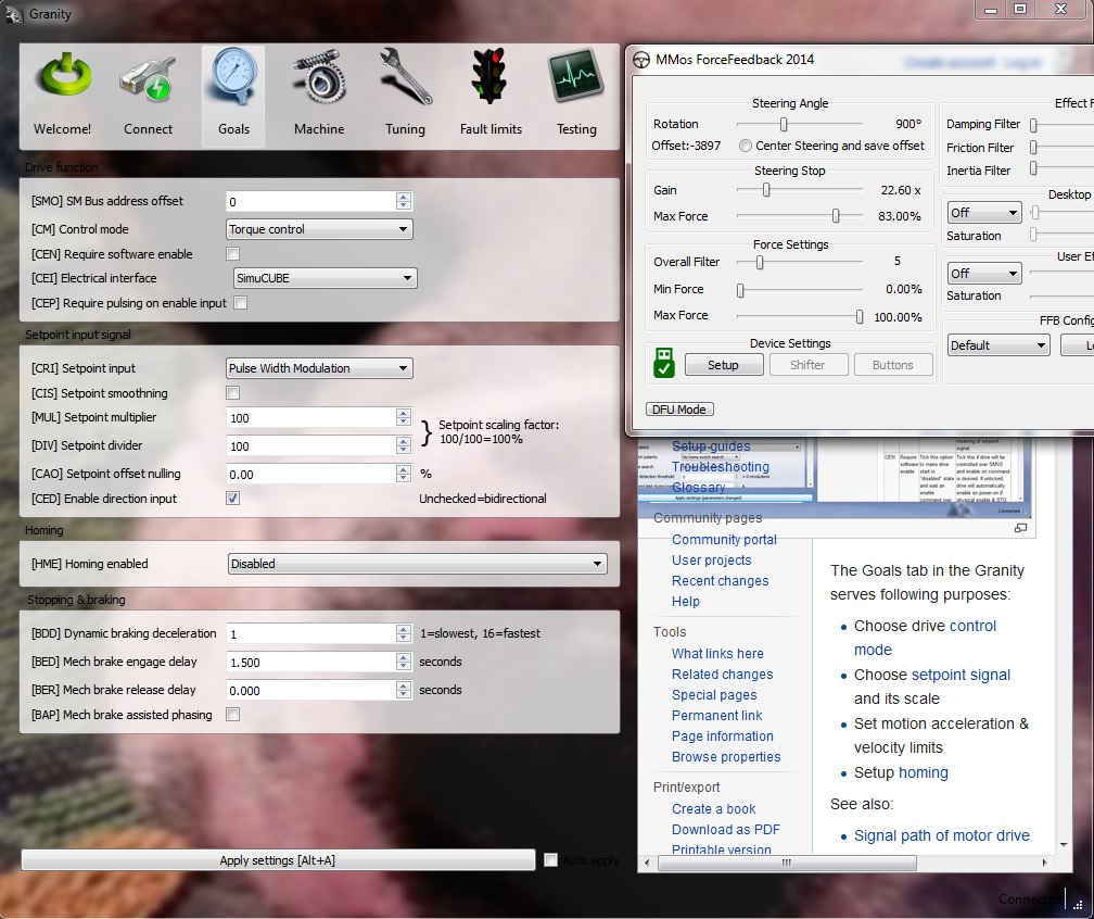

osw/simucube settings (granity, ingame and ini)

  1. bruce stephen

  2. SeatTime
    2,573
    28,320Coins
    Thanks for posting - maybe one day I will lash out on a DDW - but they are so heavy :eek: when you are trying to keep weight at a minimum for a 6DOF rig.
  3. bruce stephen
    Jun 7, 2015
    1,286
    general contractor
    michigan
    9,114Coins
    +1,243 / 9 / -0
    @SeatTime its worth the weight issues. I promise! its only another 10 or so kilos. they bring out the details and add to immersion.
