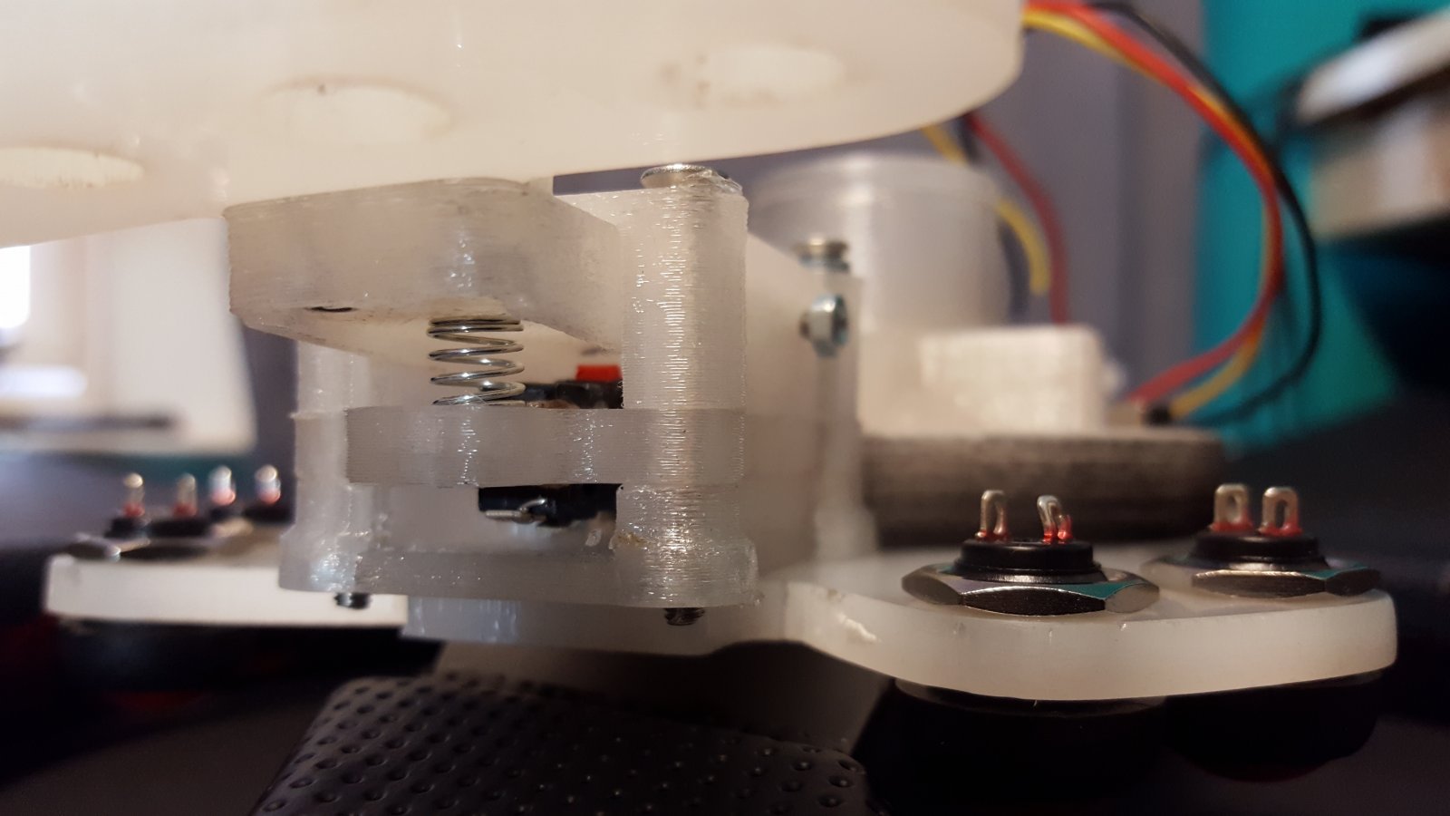

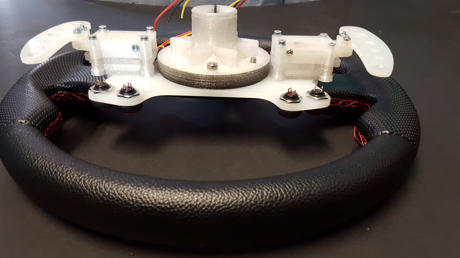

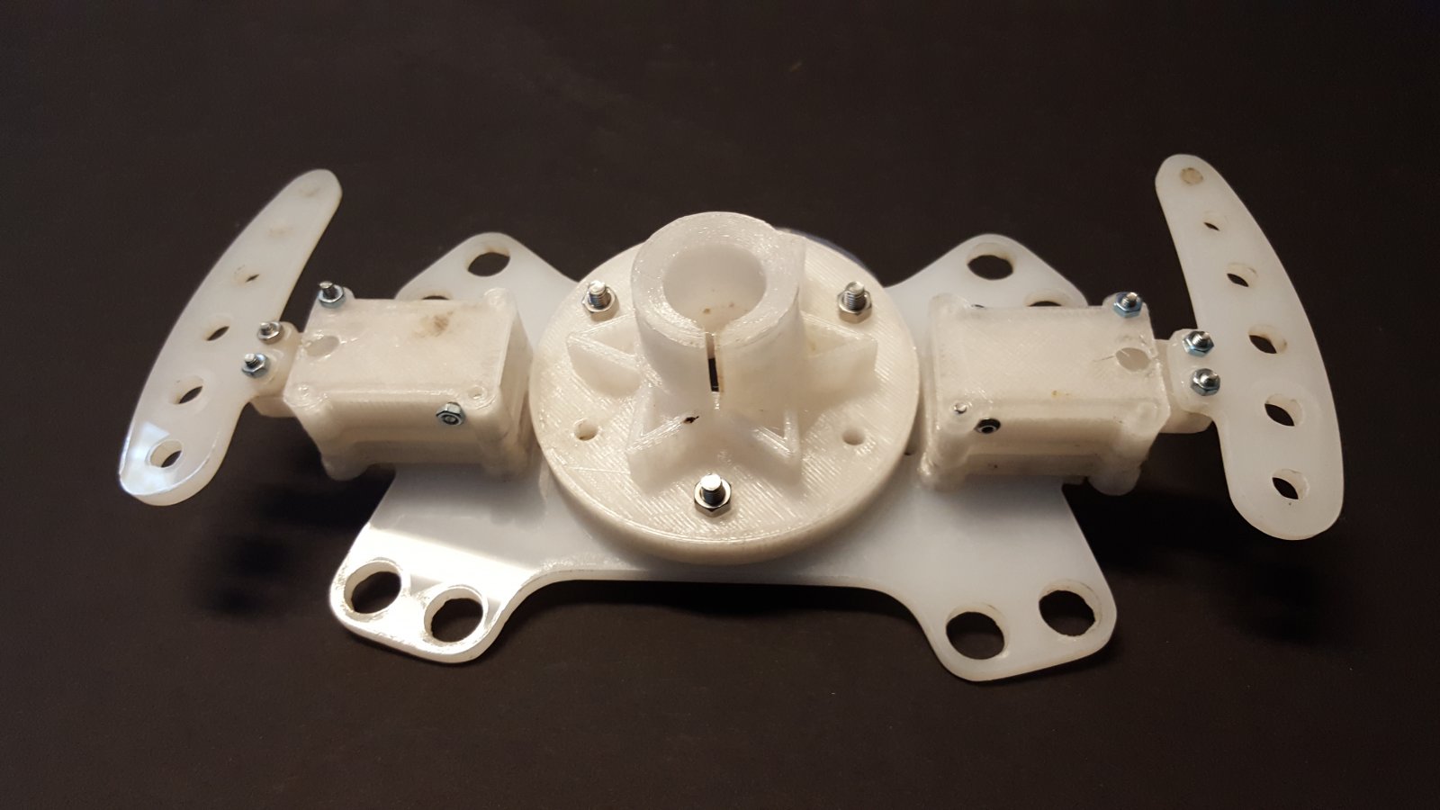

    The hardware and electronics are on the way. I mounted it to @RacingMat quick release. I used 3/16 acrylic for the plate and paddles. I printed the rest of the parts in PETG.

  3. Nick Moxley
    17,056Coins
    +2,506 / 30 / -2
    How do the paddles feel ? My fear was the "click" mechanism wouldn't be up to my liking. Or i guess your waiting on magnets and switches. be sure to let us know when u get it together.
    Also the depth of the paddles seem to be Rather deep (requiring Long fingers) Tho a different shaped paddle with a angle bracket i guess could fix that.
  4. bruce stephen
    Jun 7, 2015
    1,286
    general contractor
    michigan
    9,114Coins
    +1,243 / 9 / -0
    @Nick Moxley I'm a little apprehensive about the magnet setup but we shall see. If that doesn't feel right I'll modify it to use a spring. I have a wheel on the way for it also. I'll update when the stuff arrives.
    Edit: the plate has holes to move the paddles out further. Not sure if it's enough till I get the wheel.

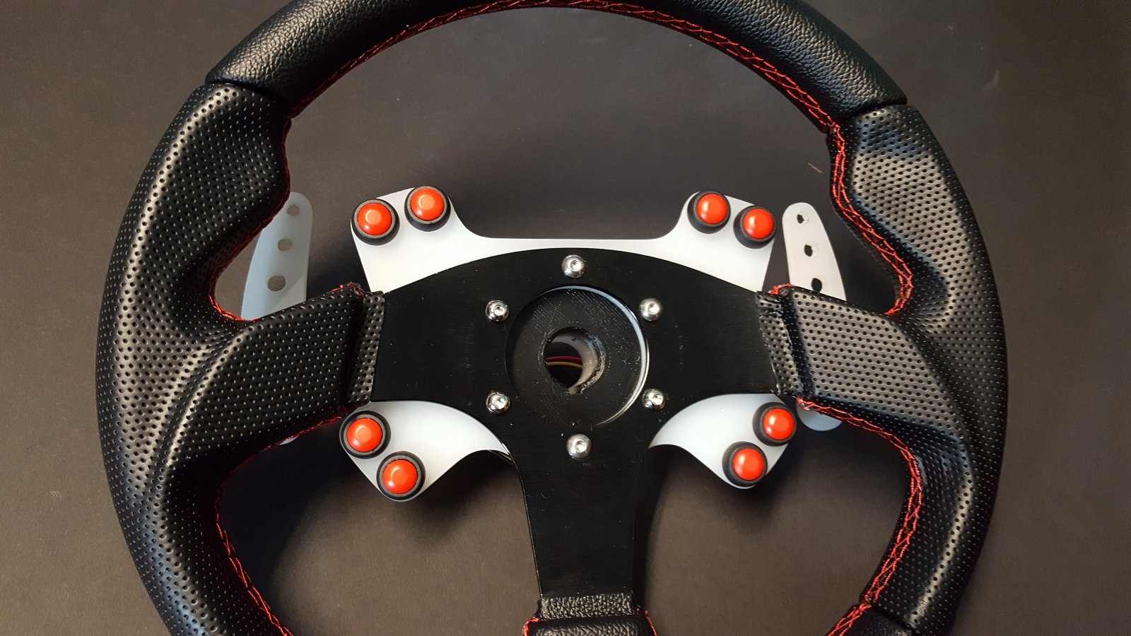

  6. bruce stephen
    Jun 7, 2015
    1,286
    general contractor
    michigan
    9,114Coins
    +1,243 / 9 / -0
    So here it is mounted on a $30 ebay wheel. @Nick Moxley i did decide to go with a spring instead of the magnets, it is just a touch stiffer than my g25 with a similar throw. still waiting on the pro micro to show from China. ill go with the micro ($5) instead of the teensy ($30).
  7. HoiHman
    HoiHman Active Member
    Feb 1, 2015
    211
    Mechanic
    The Netherlands
    331Coins
    +143 / 1 / -0
    This looks great and it will be my next project.
    I still have some magnets and micro switches left and will probably use a combination of springs and magnets for the shifters.
    I probably won't use the buttonplate, but i will print an entire buttonbox with rear enclosure.
