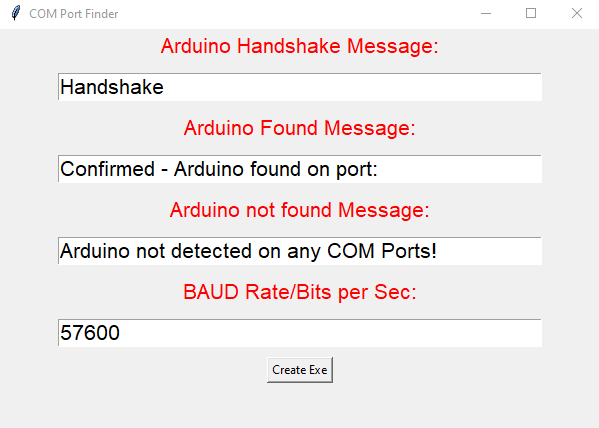

    With Chat-GPT (Made by Open-AI) gaining popularity, I thought I would try it out. It is really a staggeringly impressive piece of technology. I have taught myself some very rudimentary programming to run motion simulators, wind sims and button boxes over the last few years. AI based tools are going to become increasingly powerful but I suspect also quite deskilling; If I want some basic coding performed now, I can literally just ask AI to design it, but then I am less likely to have the knowledge myself to write a program from scratch.
    As an example I've attached some code written by Chat-GPT with a little prompting that you can use to configure another program that it will create to recognise different Arduinos using the Serial.Print command and letting you know the correct COM port. This may be useful for the DIY motion enthusiast, I have several arduinos running motion, wind, gearbox, pedals etc. It's handy having a program that will accurately identify an arduino and not run the risk of flashing the wrong one or configuring the motion software to look for the wrong COM port.
    To use the program, you need to first install Python and then run the script. It will open a window allowing you to configure a few parameters. The 'Handshake Message' is what the program looks for the arduino sending. (Add the same phrase as a Serial.println("Handshake"); line in the arduino code). You can also set the BAUD rate and what messages are displayed for success or failure. It will then create an exe file that will use the parameters that you have set.
    As an amateur, if I were to try to write this code from scratch, it would have taken me hours, if not days. Instead, I created it in minutes using Chat-GPT. You can literally type in plain language "Write me a program for an arduino that will control 6 servo motors with specified ranges." and then you can add "Please change the code so that the servos can respond to data sent over serial in order to move those servos and also add error checking for the data being sent." You can keep asking questions and asking it to modify the code. It even neatly comments all the code making it easy to change and understand. I've also tried copying and pasting existing code I have written and asked it to improve upon it and it can. It's truly mind blowing stuff how far language learning AI programs have come.
