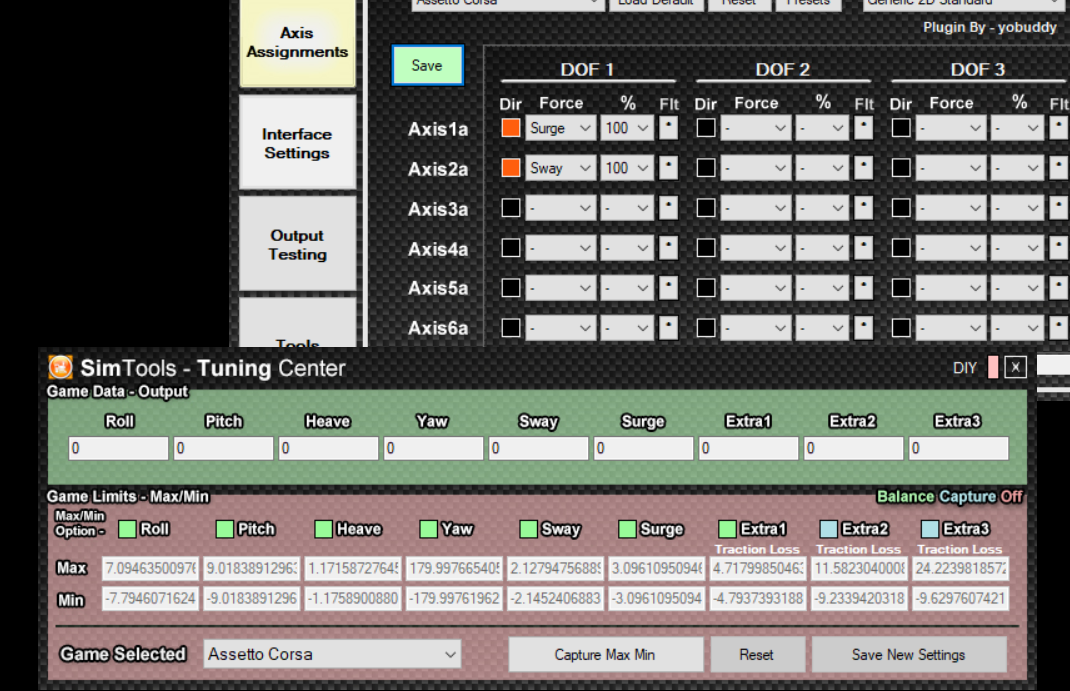

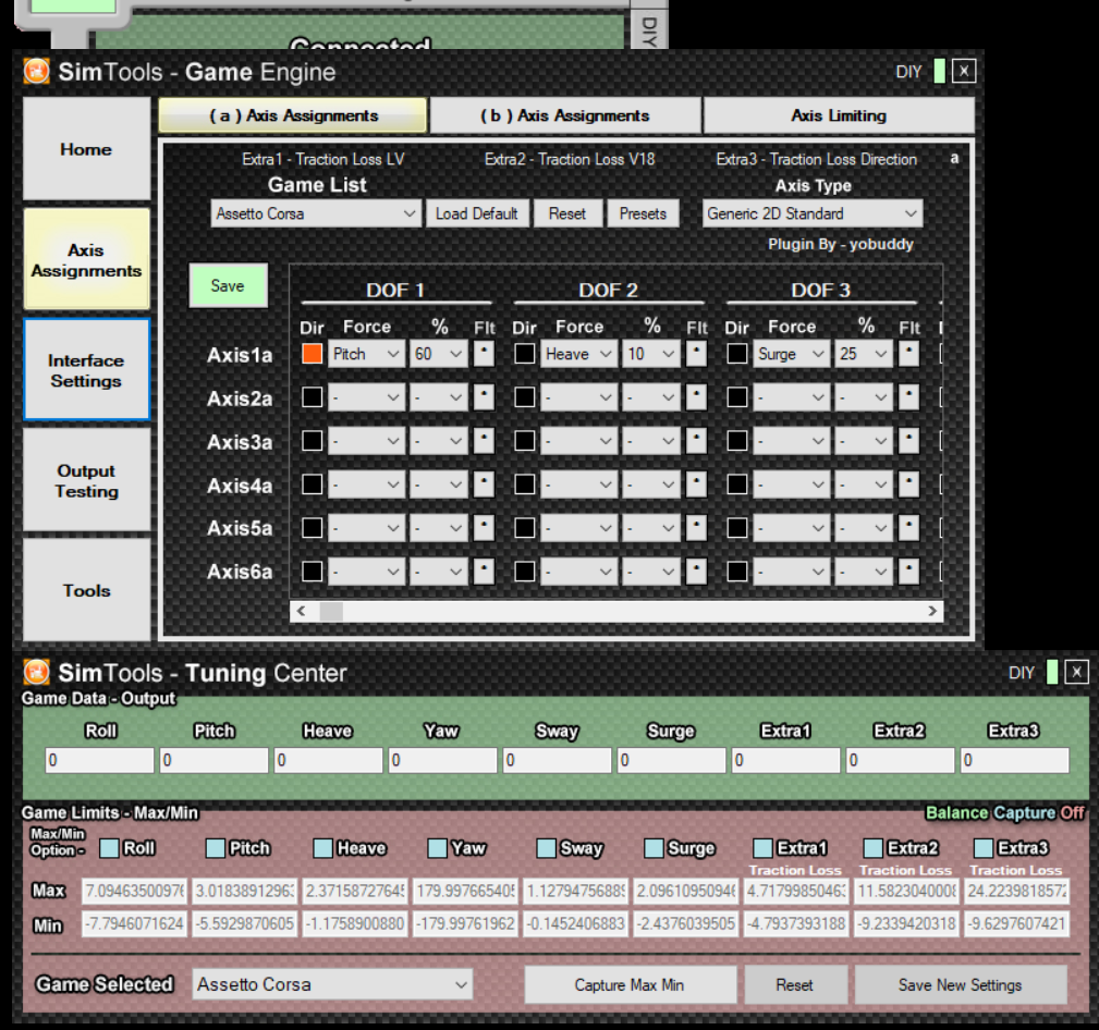

    I also tuned each DOF/Axis one by one. However, for whatever reason, one half of my axis works while the other seems anemic. For example: Pitch up seems to work properly while pitching down from the center point is weak, slow, not using the full range. Even more frustrating is my left turn response to sway (or roll) responds properly, but sway to the left is basically non-existent...save for returning to center point.

    Hi @ZeGrundPilot,
    1) First let's look at your Max/Min values
    Lets take for example Pitch.
    The way you have it tuned, it will react differently when it tips to one side, than the other.
    This is because you have a different Max vs Min for the Pitch input.
    For instance, when a 3 comes in for Pitch from the game.
    Because the Max value is 3.01... you get about 100% output (or tipped all the way to that side)
    However when you get a -3, because the Min is -5.5... you only get about a 55 deg tip on the other side.
    What I'm trying to show you here, is you almost always need 'balancing' for Roll, Pitch, Yaw, Sway, Extra1-3.

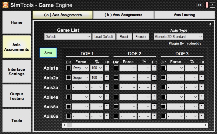

    2) Next let's look at your Axis Assignments.
    Lets start with something simple like this. (please swap Sway and Surge if your sim Sway's when it should Surge.

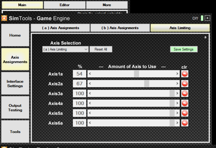

    We read axis assignments from left to right.

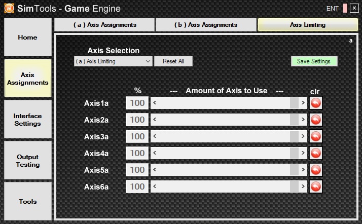

    In your case, we should set them to use 100% of the axis, because you are only use one DOF per axis, and we want to use all of the output for this axis.
    So in the pic above, Axis1a = Sway at 100% and Axis2a = Surge at 100%.
    Reset the limits
    (For the test's, we are letting them use their full range in the limiting pic above)
    After changing these setting, please make sure that your Max/Min settings for Sway and Surge are the same number (except the Min is negative of course) and give it a ride.
    I believe you will see a huge difference.

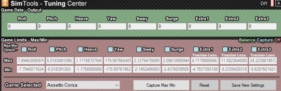

    OK. I am using Pitch and Sway @ 100 in this example. Rolling up and down Laguna corkscrew shows me what the game is sending. Axis Limits none (100%). Here is the balanced tuning attachment. We still go up and to center point nicely, but no real noticeable downward pitch. Left turn Sway is fully perceivable, but right sway non-existent outside of the return to center from the left-turning sway. Even low speed jerk on the wheel gives the left sway, but nothing on the right. When I swap the cables OR the direction box on the Axis DOF, I get the exact opposite. Tuning1.jpg

    By the way. I just ticked the "Balanced" button on pitch, roll, sway, surge, Extra1. Same result. No left sway registered but plenty of sway to the right. Thanks

    Use Surge instead of pitch.
    For sway, you still do not have even numbers in the Max/Min boxes. (thou they are close)

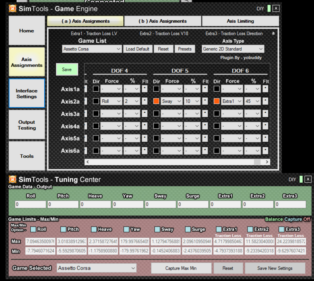

    May I see a pic of you axis assignments for the game?

    Balanced min/max. 100s for DOFS and Limits. Output Tests move rig in both directions.
    Also, the rig is a pendulum. So some of Axis1a is for surge and it is shared with pitch, as the rig points up or down on the hills of the tracks. Some of Axis2a is for sway and the axis is shared with extra1 for loss of traction whereby loss of traction will be the majority of the axis. I want minimal side to side movement for the sway. I am actively, slowly getting my head around the DOF/Axis matrix...as I did not think you could list surge and sway in the same DOF column unless you wanted them acted on simultaneously...I was apparently wrong...

    Great!
    (I just wanted to check if you had filters on that may be skewing the results, so thx for the pic.)

    Since you know that it can tip left, I would suggest you have your axis assignment's wrong buddy.
    I suggest starting with a simple Sway and Surge axis assignment until your comfortable with how the axis mixing works.
    Take care,
