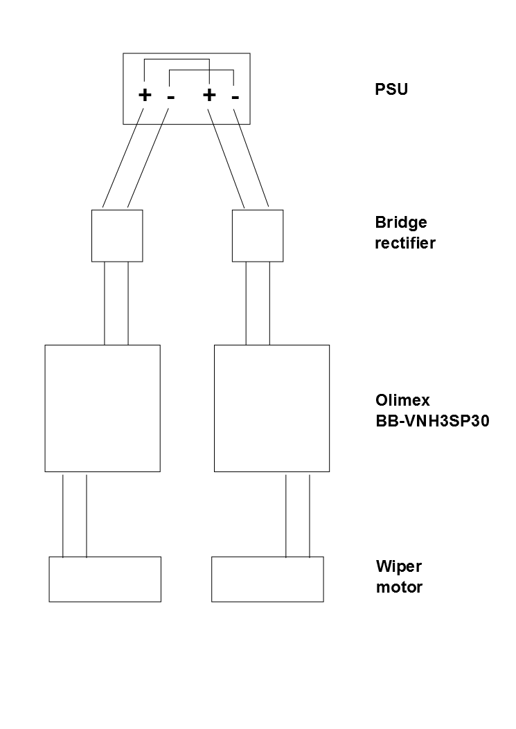

    I´m currently in the planning/getting parts stage of my 2DOf build.
    Basically i want to use one Dell 2950PSU paired with two Olimex BB-VNH3SP30 H-bridges each one driving one wiper motor. I want to use a bridge rectifier between each H-bridge and the PSU for protection.
    Will it work this way?
    Can i use this bridge rectifier? : Diotec KBPC5000FM, 35V/50A
