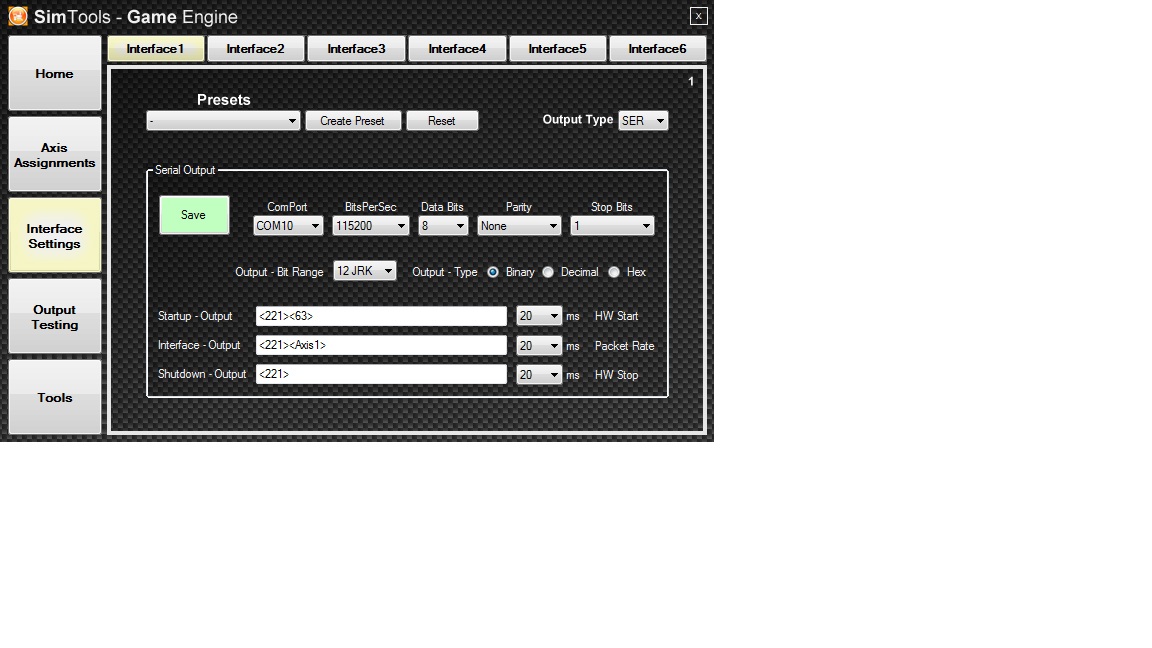

    When connect my 2dof the seat centers, then run game engine and manager.
    Play the game or test the output. When stop the game or output, one motor turns to max (and the seat inclined) until game again.

    Check Simtools software >> Interface settings >> shutdown output

    Thanks!!! Just deleted shutdown output and Works.
